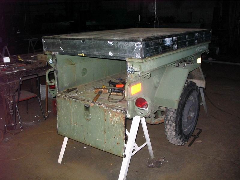

Tail gate is about done.
The top cover also, but my guys used a 14 ga sheet metal on top, just way too heavy, i will replace it with 20-22 ga sheet. Cylinder even being 158# are not enough. Oddly i used mcmaster formula to calculate them.

Yes, 1"x1"x1/8" covered with 14 ga steel on the side and top cover is 22ga. If i'd doing it again i would go with thinner tubing. .083 or .100

Looks good Eric, it looks like you added 2 more shocks for the lid, did it help? I still have to build a lid for mine which will hold a Eezi 1400 and I am going to be using 2-250lb and hope that is sufficient? will see. Keep up the nice build.
R
Even with 4x 258 # cylinder the first 12" is hard to lift then it gets alot easier as you lift.
Due to my tail gate i kind had no choice on the position of the cylinder.
If i do again. I would use alot thinner tube are aluminum tube and rivet steel on it.
but the lid is at least 125# and the tente 150# so we are talking at least or very close to 300# to lift.
but you don't have to do a 6" high lid like i did. I did it so big jerry cans fit in the trailer. That is up to you. right now you can see the center of gravity being very high. But once loaded with 200-300# of gear it will drop down.
