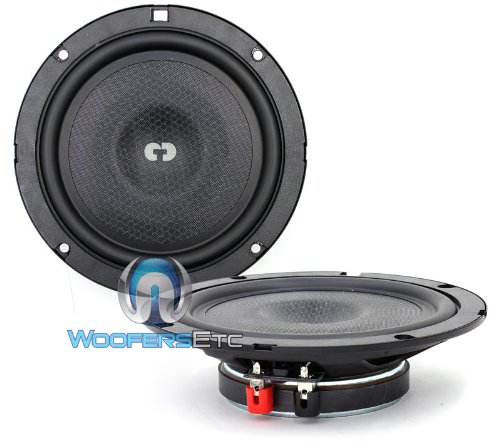

Have you ever....?
Now that's one slim speaker!
I don't know much about CDT speakers, let alone these things, but with a top mount depth of 1.5" I had to look into this.
Apparently CDT is a pretty high end European manufacturer of audio products and from the few reviews I've seen they make some pretty awesome stuff. This pair comes with a set of component tweeters and goes for $250 to $300.
I just upgraded my amp from 70wpc RMS to 125wpc RMS so I'm looking to upgrade the speakers too (Polk DB6501), and with depth being so limiting I'm always happy to see another speaker that fits.
So anybody running these in their 80? Or any experience with the brand at all?
That's pretty cool! Go for it and give us a review. Love the idea of a component tweeter.
No idea on these particular speakers, but CDT was pretty well regarded when I was in the car audio scene 8 years a go or so.
I run the CDT gold series speakers in my 'better' setup. they're incredibly good. I think what you'll need to do with those is spend a long time making sure the hole you put them in is up for the task. Dynolined both sides, good baffle, nicely isolated from the front, etc...
But if the quality of that speaker is even half of what the mains I have are, it's worth it. Really great quality stuff.
What's the part number for these speakers, got a link?
I'm fairly sure those are these CDT Audio Midwoofer CL-6SL.
It's just the drivers tho, so it doesn't include crossovers or tweeters. That said, I think it's the same driver as in some of their sets, which I've had on my eye on for a few years, to include a 3-way comp set including 4" drivers (for the dash?). CDT Audio CL-642SL
Poke around their site, they have a bunch of slim options.
Can't believe I forgot to give info on the speaker!
It's the CDT CL-642SL. A full component kit, not just a mid/woofer.

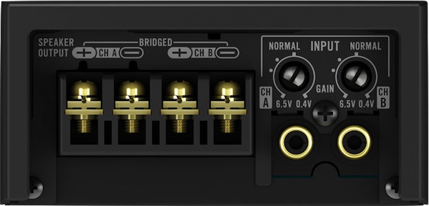

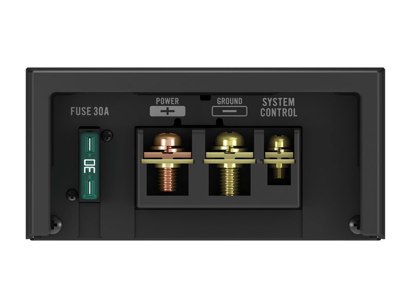

I have a new 125W RMS amp to drive them and I like it right out of the box. I always wondered why amps all had these goofy screw down slug power and speaker connections. Would you ever couple your batteries this way? Hell no! So why power your amp with this thing that squishes the middle strands and ignores the rest?
The Pioneer PRS-D800 has what I always wanted to see but didn't.
Screw down posts for crimped spade connectors!!!
Why oh why don't all amps do it this way...?
The PRS-D800 has these for the speaks too. Awesome!

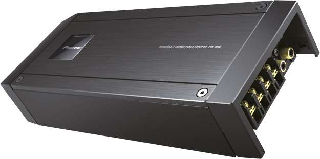

And it's not much bigger than a brick! (But a lot heavier) So you can run 3, 4 or 5 of these things!
So anyway I'll let you guys know how things work out.
I know these are out of most folks budget, and truth be told, mine too. I just kept looking at "almost fit" speakers and trying to imagine ways to make them fit that I just gave up and gave in and got the best guaranteed fitment slim ones I could find. Especially since my VW has the same clearance issues and these Morel's may just find their way there in the future.
The amp though was only $175 though. Not bad for a clean, uncolored 125w RMS X 2 at 4 ohm - 300w Peak class D amp.
