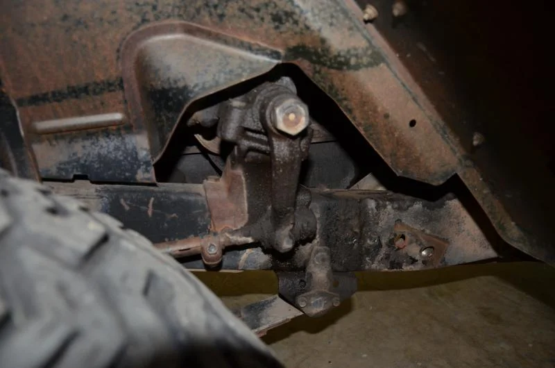

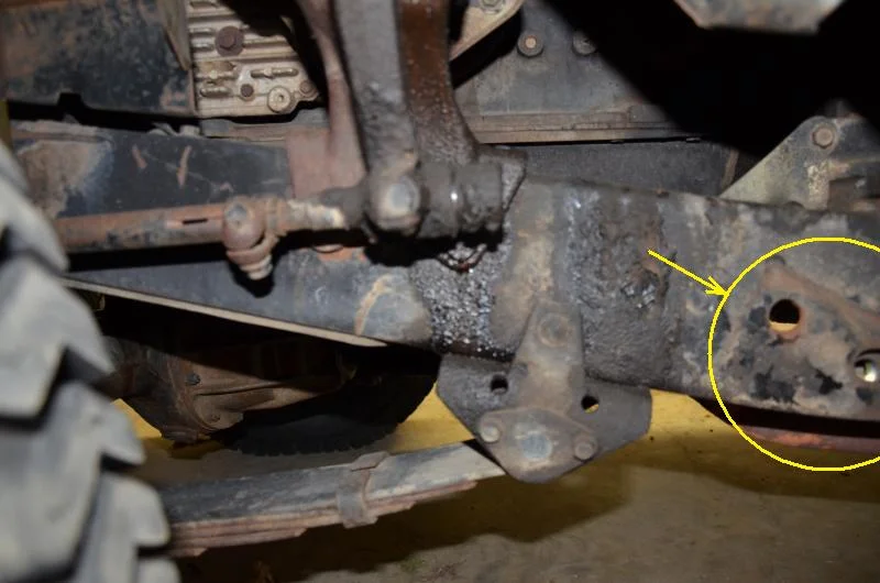

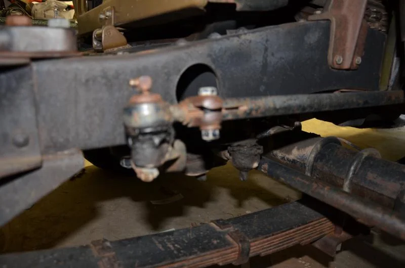

First off, let me say that I appreciate all the responses already. I have been on other forums in the past for other cars I have owned, and you guys seem to be pretty down right cool. No wise cracks about being new, etc. So thanks. Here are a few pics. Hopefully I am not screwing up how to do this. Let me know what might be my drifting dilemma is given the state of what you see.

It's easy to troubleshoot stock. :D Those tires may be contributing, but you're going to be in for some steering component work.
Condition of all the TRE's would make me suspect them. Check the center arm link..........have someone saw the wheel back and forth..............any vertical movement = bad ................. all horizontal = good.
Check the wheel bearings and knuckle bearings. Jack it up on both sides so the front wheels are free and check for vertical and horizontal play. Also turn the tire from side to side by hand, if it feels like there is a positive "detent" in the center, the knuckle bearings are pretty well pounded.
I'd dig in and order up all the stuff from Kurt (Cruiser Outfitters) and get busy. :wrench:
Oh yeah, those two gaping holes don't belong there behind the steering box.............screams freshly removed plow frame to me. If so, might explain the steering wear. ;) That, or nearly forty year old steering. :doh:

Gus has some great advice. You got shots of most the supect parts...... now start pulling pushing and wiggling parts to see if you can find the play in the system. Have you determined the source of wetness on steering box? when tires are on the ground how much play L to R in wheel do you have before it begins to move the tires? As well what was bolted behind the rear spring hanger?
As well (not necessarily cause of your issue) but check the condition of the splines on the steering shaft. (believe this is present with the manual steering unit, but never owned one) I currently have a lot of play there in my setup next on the list to be remedied. A second set of hands and eyes can be a big help. I took a pry bar too to check condition of bushings by trying to move the spring and see if there was play b/w the pins and bushings.
Beyond steering components, check the wear of the front axle/knuckle parts. Jack front end up and check for wiggle with your hands at 3 and 9 to check for tie rod wear and 6 and 12 to check wheel bearings. If you stick a crow bar under teh wheel just slightly off ground and try and lift you can assess the trunion bearing condition.

Your steering box is probably the problem.
It looks like it's lost its oil which could well be from excess play in the worm bearings.
(And if it's lost its oil that accelerates wear further too of course.)
:beer:
Edit: Ooops... I mean excess play in your sector shaft bushing (because it is really the sector shaft that bolts to your pitman arm). Although if you have play there then you probably also have it in the worm shaft (that is turned by your rag- joint/steering column)
