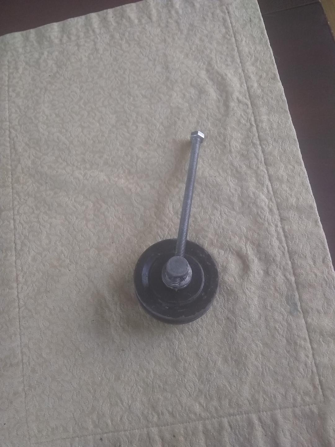

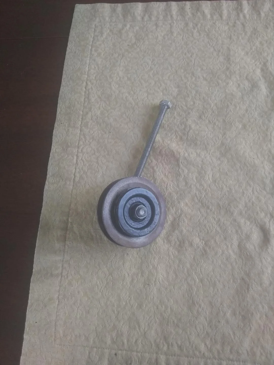

Does anyone happen to have a photo of how the tension pulley for the compressor is supposed to look? I removed that about two years ago and I bought a new bolt that threads into the pulley, but it seems like I am missing something that would make it so that the bolt can be adjusted.
This is what I have. Should there also be a nut on there so that it would hold against the bracket?
Assuming you have the rest of the bracket...then yes...the locking nut is only thing missing from your set up.

OK, I think I will just leave the evaporator installed and then remove some of the oil out of the compressor and put it in the other components and then do as you said as far as spinning the compressor by hand or add some with a syringe to the evaporator.
I will also just add a locking nut to the tension pulley assembly and go from there.
