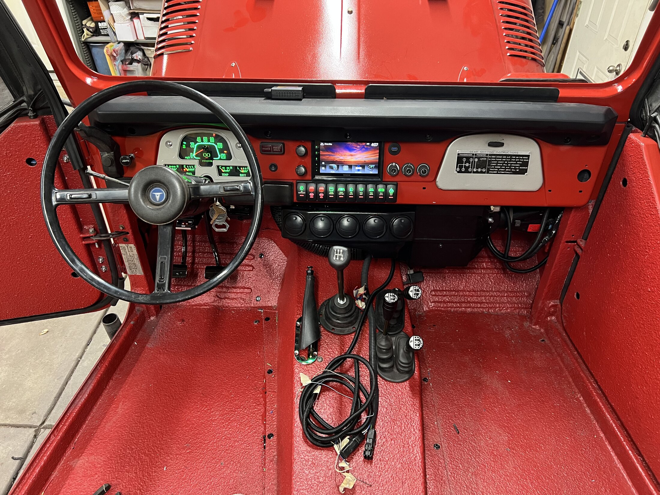

I have this unit on mine and it looks very slick. I got the higher performance blower and the volume of air that it pushes is very impressive. The install is not quite done as I’ve got a ton of other things to make and install before I can have the system charged.

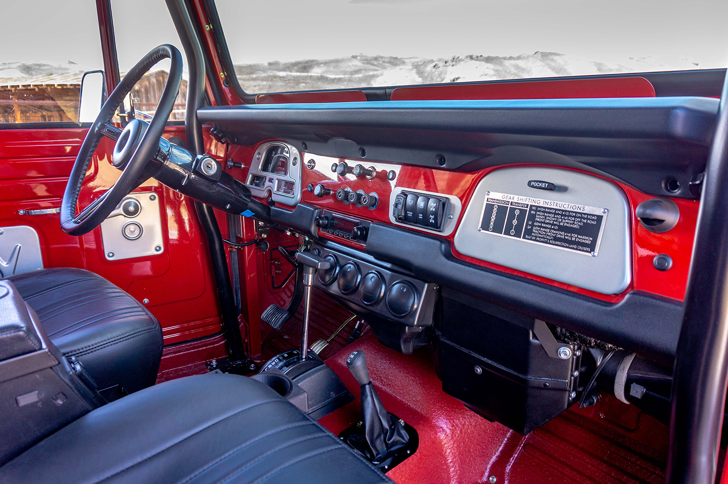

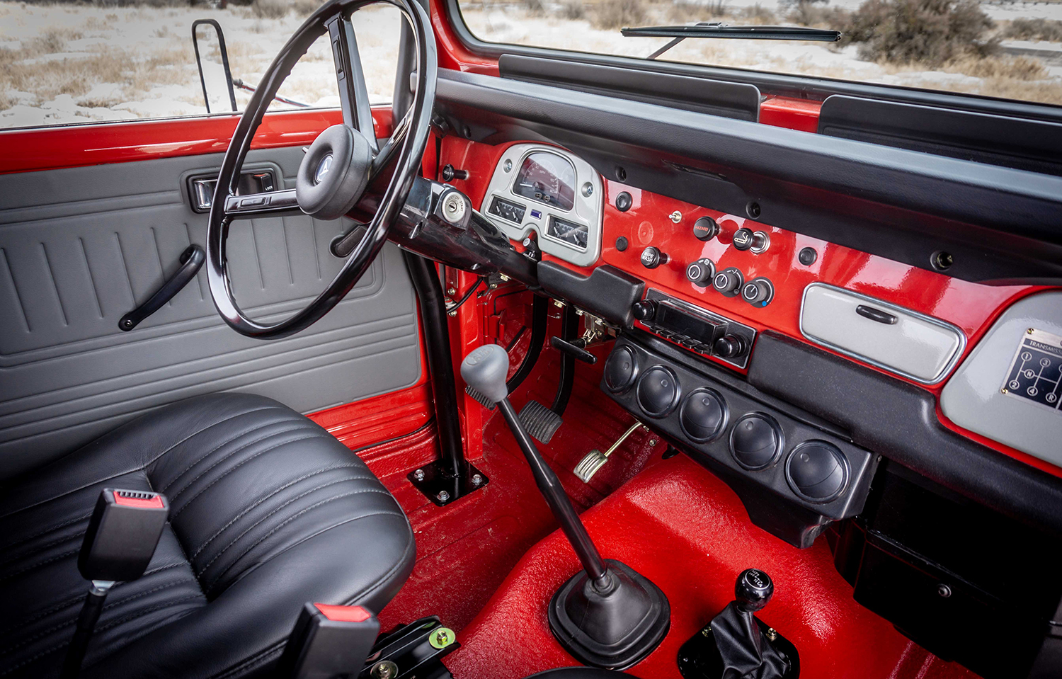

Pics from the vintage site. Apparently this can only be installed in red 40s with bedlined interior. 😆

That looks amazing! Are you running the Toyota straight 6? If so, tell me about mounting the compressor. Also, who did you get the A/C system from, Vintage Air?
Thank you! I have an LS engine and I am using the factory GM compressor. From what I’ve read the retrofit kit for the factory 6 cylinder is a direct bolt on unit. You will have to drill a few holes for the evaporator.

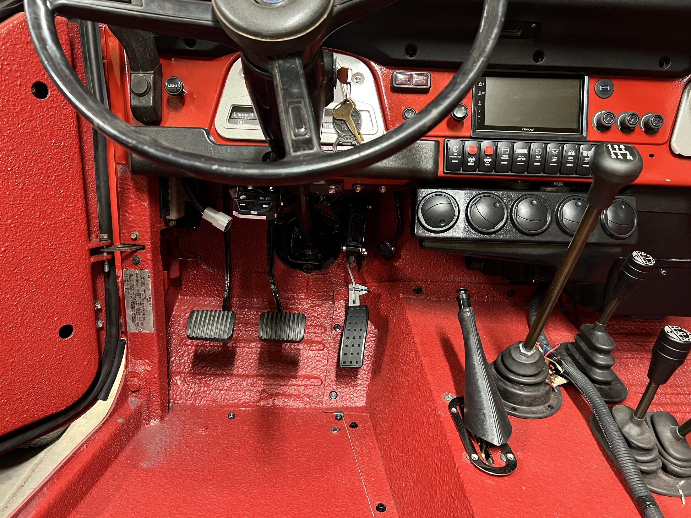

I also want to get the the bed liner sprayed underneath, and on the interior floorboards. Trying to make up my mind if I should go black or red with the bed liner...???
I went with red Raptor Liner inside. I used Lizard Skin heat and sound proofing underneath, with topcoat applied over that to make it stronger. I also have Lizard Skin under the Raptor. Way overkill.

You apply sound control first, then the heat shield. The final step that I did is Raptor liner or top coat. I did not spray top coat where I raptor lined.
