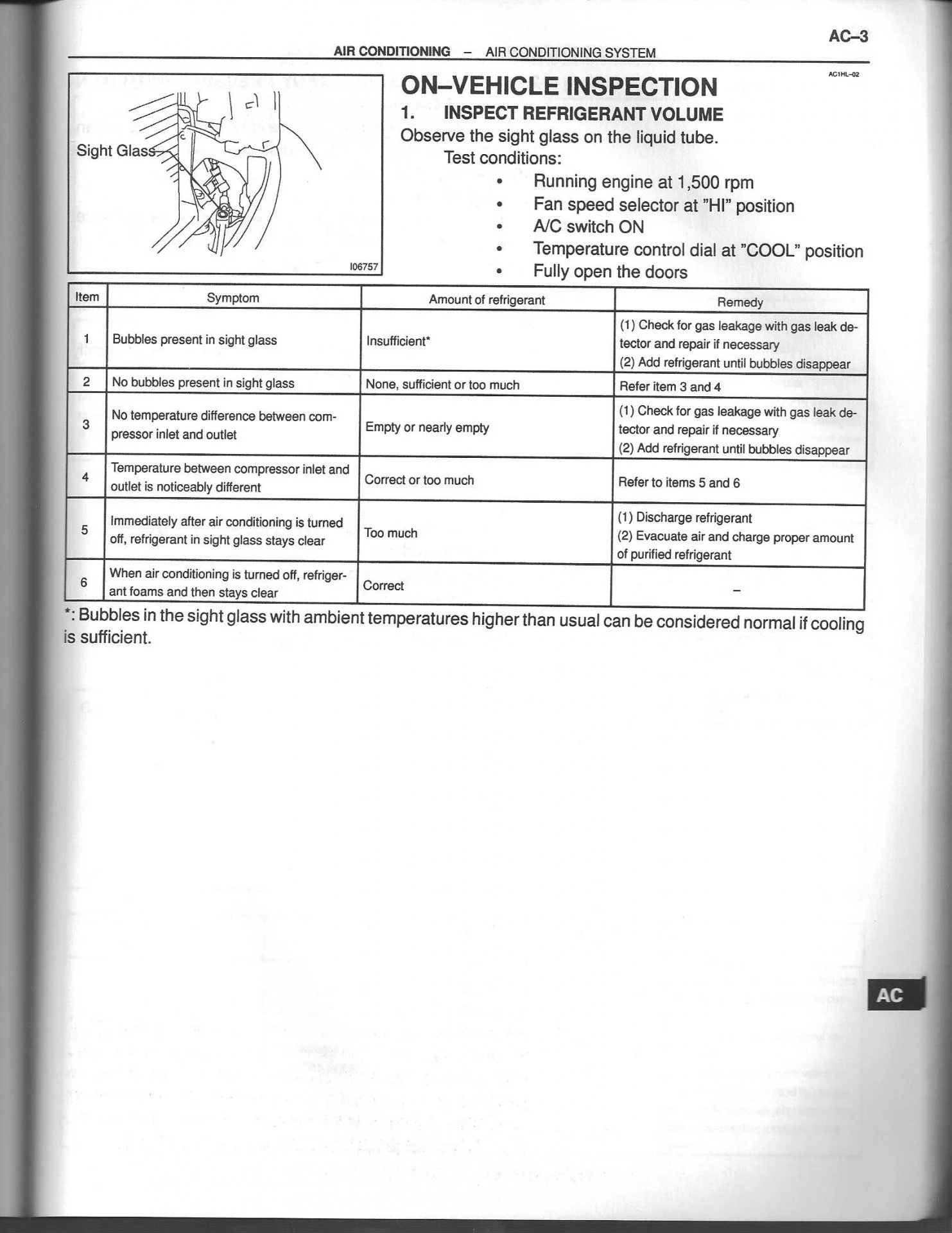

Add freon into the system (hope you know how) and check the glass window in the ac line. It is located near lower valence right below the driver side head light. If you see bubbles then it lacks gas. Add enough freon to clear the window (no bubbles). Report us back.
DO NOT "add freon/refrigerant" until you KNOW if it needs any.
Yes, the compressor clutch will not engage if the system pressure is too low, BUT we don't know that is the problem.
You can jump across your pressure switch to confirm that the compressor clutch actually works. IF it does then the next thing to do is to put a set of gauges on the unit and see what is going on (low pressure/other).

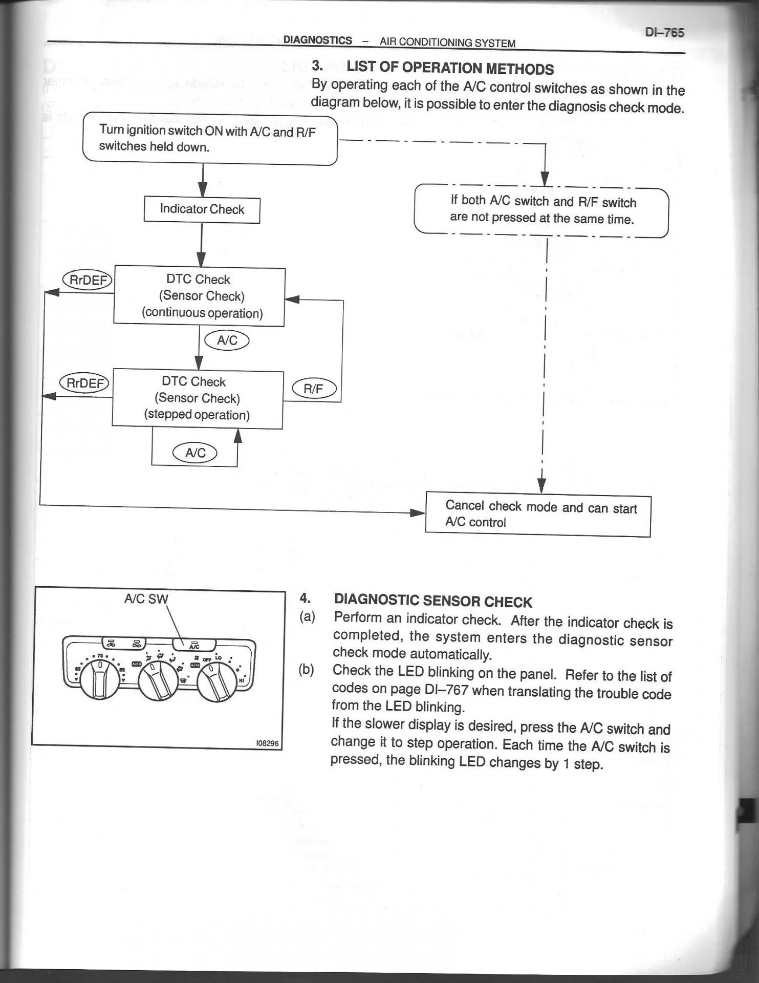

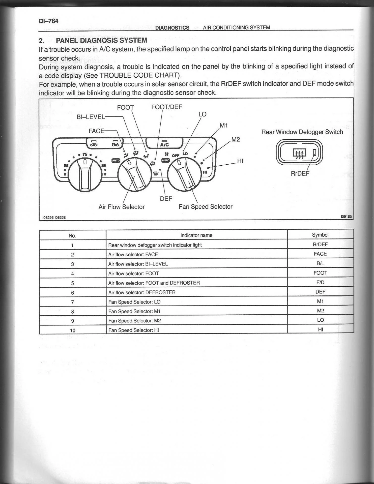

For a 2000,
You hold both the "fresh air/recirculate" and "AC compressor" switches, then turn the ignition on.
The code is displayed by which LED(s) are flashing around the rotary dials:
1 = Rear Defrost
2 = Air Flow Face
3 = Air Flow Bi-Level
4 = Air Flow Foot
5 = Air Flow Foot & Defrost
6 = Air Flow Defrost
7 = Fan Speed Low
8 = Fan Speed Med1
9 = Fan Speed Med2
10 = Fan Speed High​
From 2000 LC Service manual

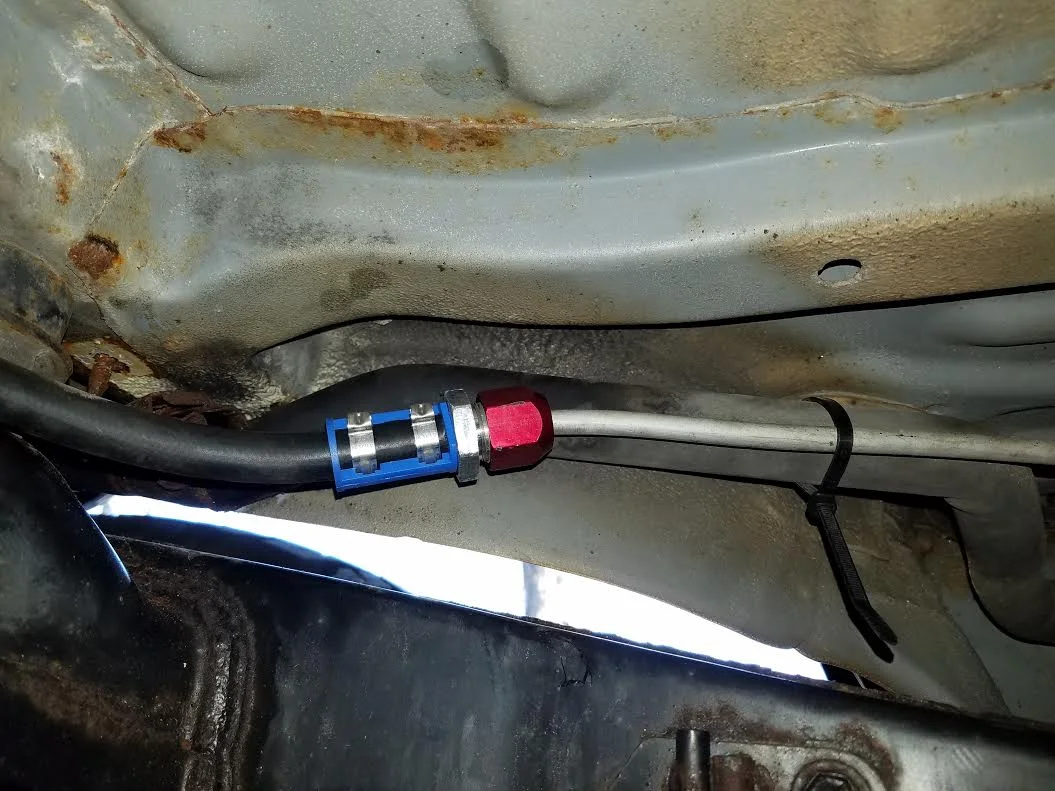

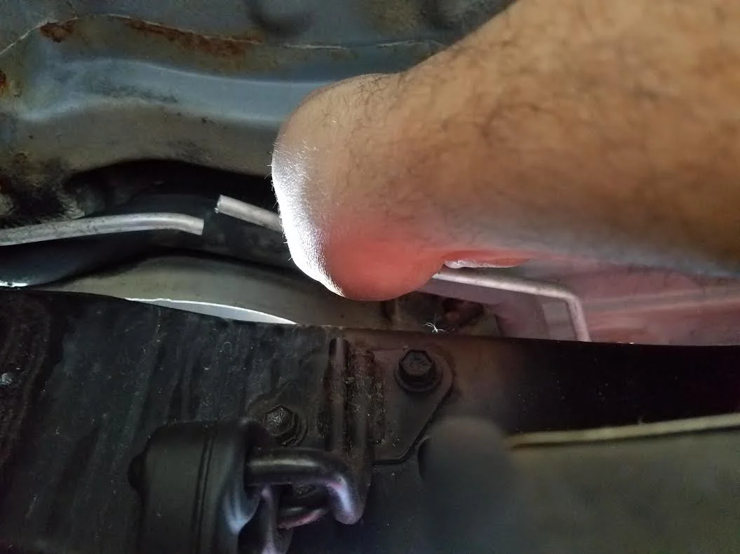

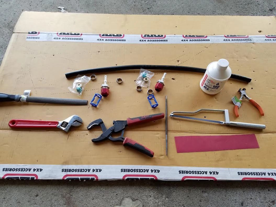

I just installed the Dorman A/C repair Kit
It's extremely simple, just basic tools and a couple of hours.
Here are some pictures of the process, not greatly detailed, but there's not too much science on this.
Here's the kit and the tools needed

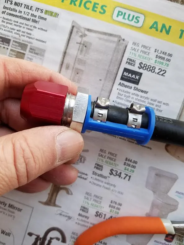

After measuring the length of hose, i cut it and assembled the fittings
You have to use A/C oil on the fittings and AL pipe. It's $8 on Autozone.
Then cut the pipe with extreme care.
With sand paper clean up about 2 inches of the pipe. The following pictures is out of focus, but you get the idea
Finally, put some oil on the pipe and insert the fitting, tighten it, but not too much or you will break the AL thread.
Put some zip ties on it and keep it away form the exhaust.
Now i have to take it a shop to vacuum and charge it, and hopefully that would be it.
Total cost was around $65 (kit + oil)
Nice work. Interesting a rubber hose is used here. I was contemplating rubber originally before I did my copper nickel line fix.

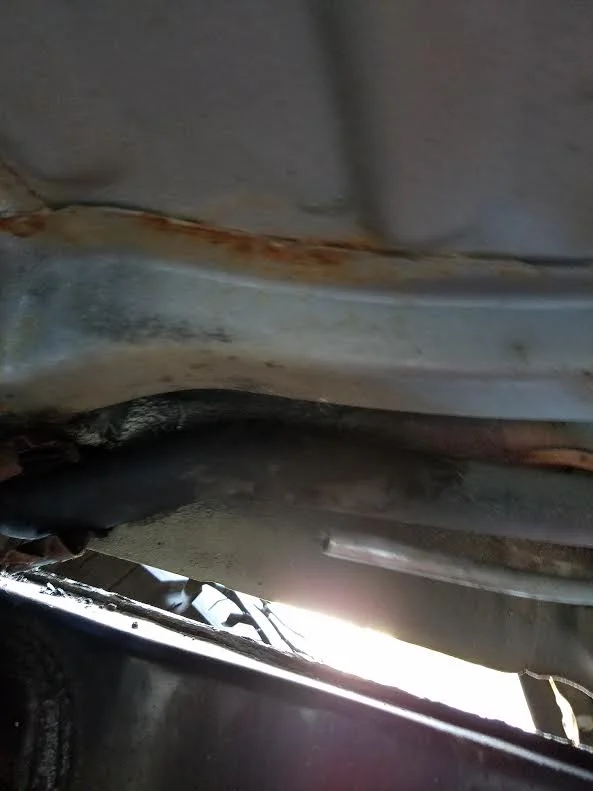

Following these lines back to the engine compartment what is the condition of those two lines? They seem to rust around the clamping positions and under that metal covering behind the passenger side wheel.
I finally had time to run the diagnostic procedure posted by jLB. There were 3 codes.
1. Rear Defrost/Fresh Air. The "Detection Item" listed on the chart could mean abnormal refrigerant pressure or open pressure sensor circuit.
2. Rear Defrost/Defrost. The "Detection Item" listed on the chart indicates Solar Circuit Open or Short. A note in the service manual says if the test was done in the dark, which it was, the Rear Defrost/Defrost may light up even if nothing is wrong with the Solar Circuit. It says to redo the test in the daylight, which i will do tomorrow.
3. Was Rear Fan/M1 which i can't find a corresponding item on the chart. Anyone have any ideas on that one?
The only "Trouble areas" listed on the chart for both 1 and 2 above is A/C Amplifier.
