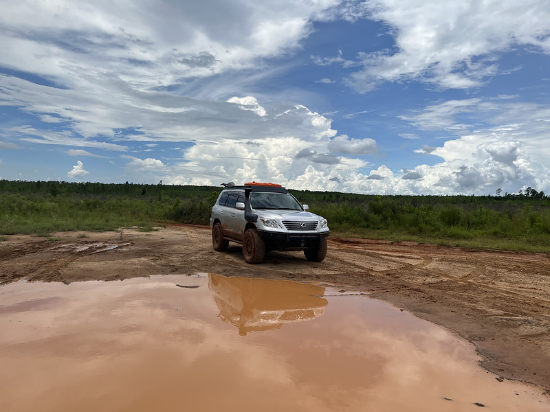

Tried out the 37s. Comically fun. It really needs some mud flaps though...
Well I got them on just sensor lifted. For most here who are trying to wheel decently hard I think I'd want to cut some fender or have more "lift." I live at 10,000ft and these 37's are actually a pound or 2 lighter than the 315/70 KO2 I took off so power loss is about as low as one could wish for. Should work well for my needs of a minivan that can tackle the named worst washboard roads in Colorado's Park County. I never care to plow snow from our driveway and think it's fun to have to "wheel" into our house when there is ~2+ feet of snow mid-winter right after a storm.
Coming from a de-corked and tuned Duramax it was never a fast vehicle stock IMO. Going to a light weight wheel and the lightest tire I could find that has good ice/snow performance makes me think I found the happy medium for me. Just hoping I don't flex too much exiting my driveway and rip off a rear mudflap cause I want to keep those and my paint.

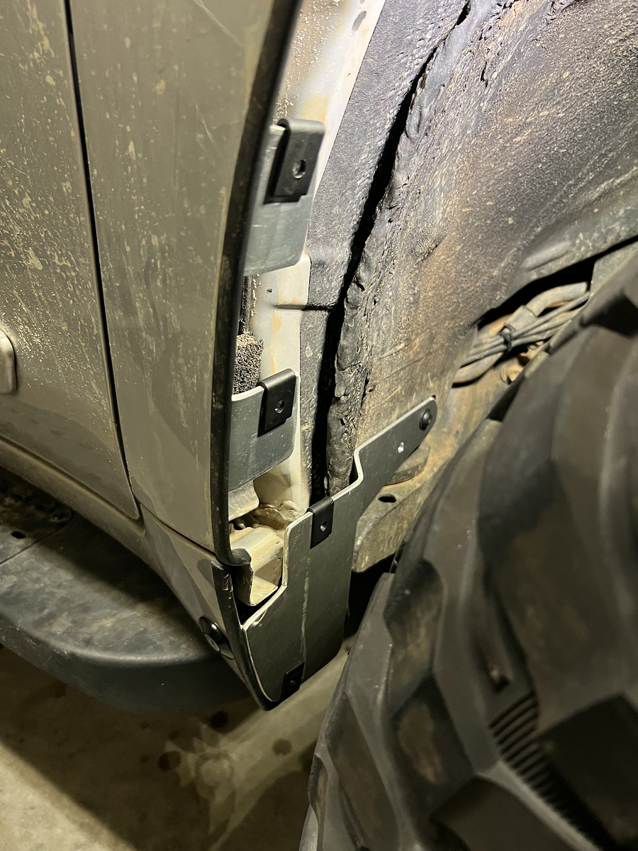

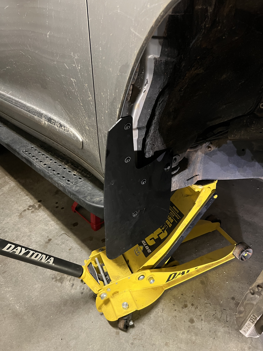

Finally got around to doing a mudflap. VHB, plastic screw grommets and 1/8 aluminum for the mounts. Rallyarmor flaps, so far super pleased with them. And hey, it clears!
I like the look of what you have done. How rigid are the flaps?
I have those Rally Armor flaps - I used them as a filler for the rear bumper. They're fairly thin plastic - rigid enough not to flap in the breeze but no thinner than box cardboard. They look decent and are cheap though, unlike the ARB flaps which are thick and expensive.
About 1/8" thick and not super rigid. I wanted something that wouldn't scoop up mud!
Nice work! I was thinking this weekend it would be nice to have front flaps as we ran about 30 miles of wet gravel. I was thinking something along these lines as 35s are sitting in the shop for it.
