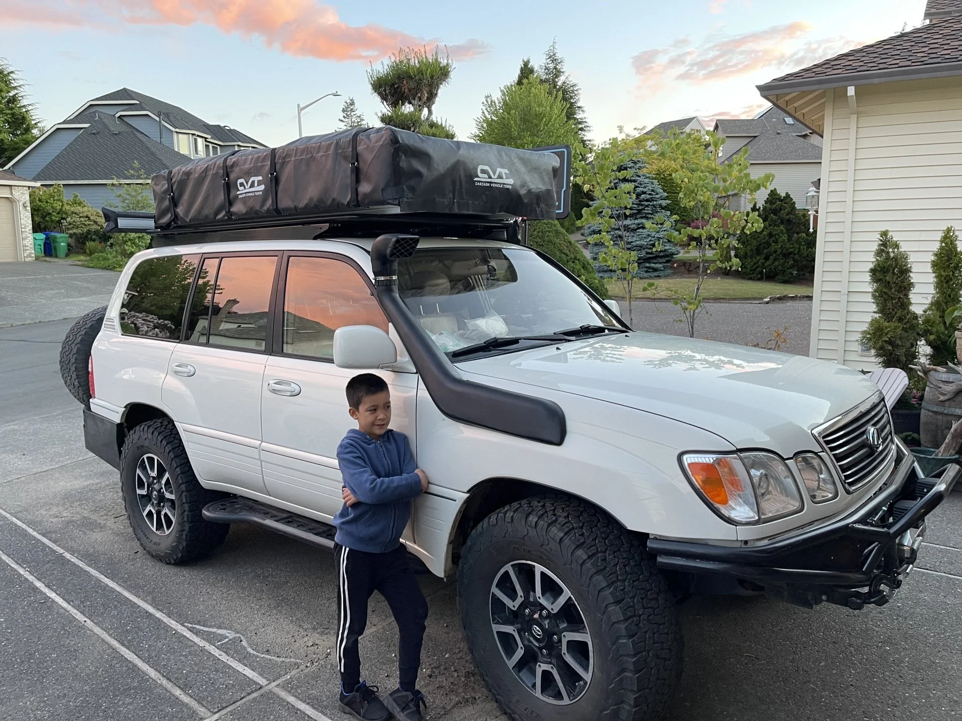

$98 ARB-Clone Snorkel install -- It turned out GREAT!!
We get dust storms (haboobs, monsoons, whatever you want to call them) here in the Phoenix Valley in the summer. Doesn't matter were the inlet is, dust gets everywhere. Most people just keep driving if the visibility isn't super bad, so it would be nice to do so with a little bit more piece of mind.

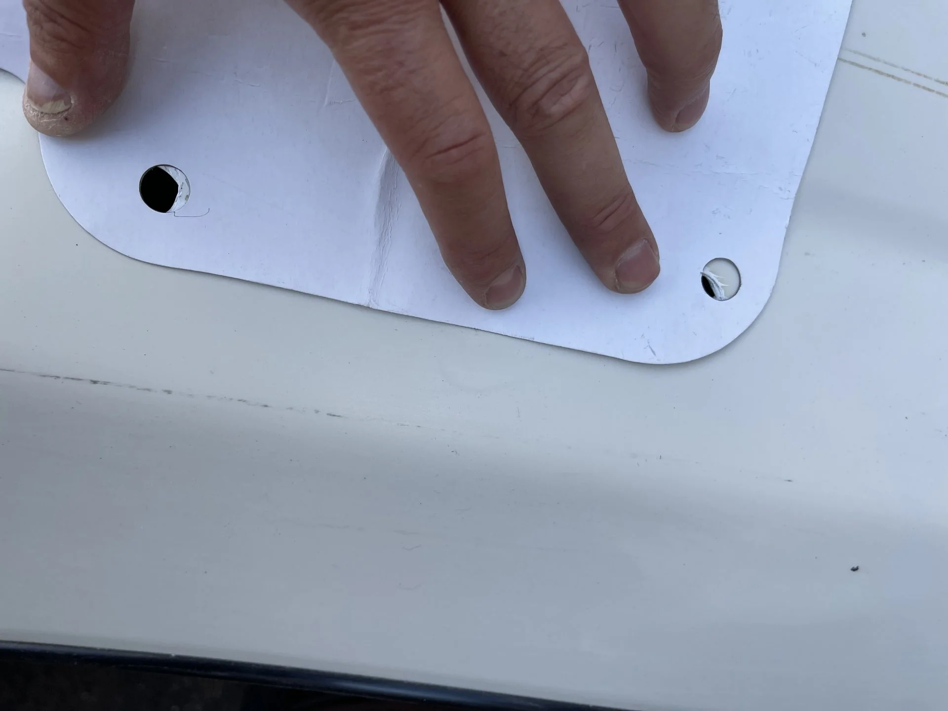

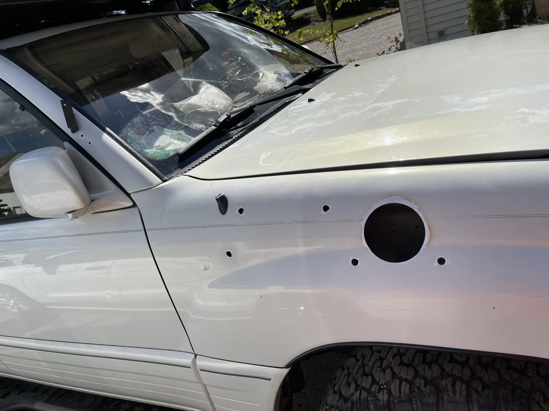

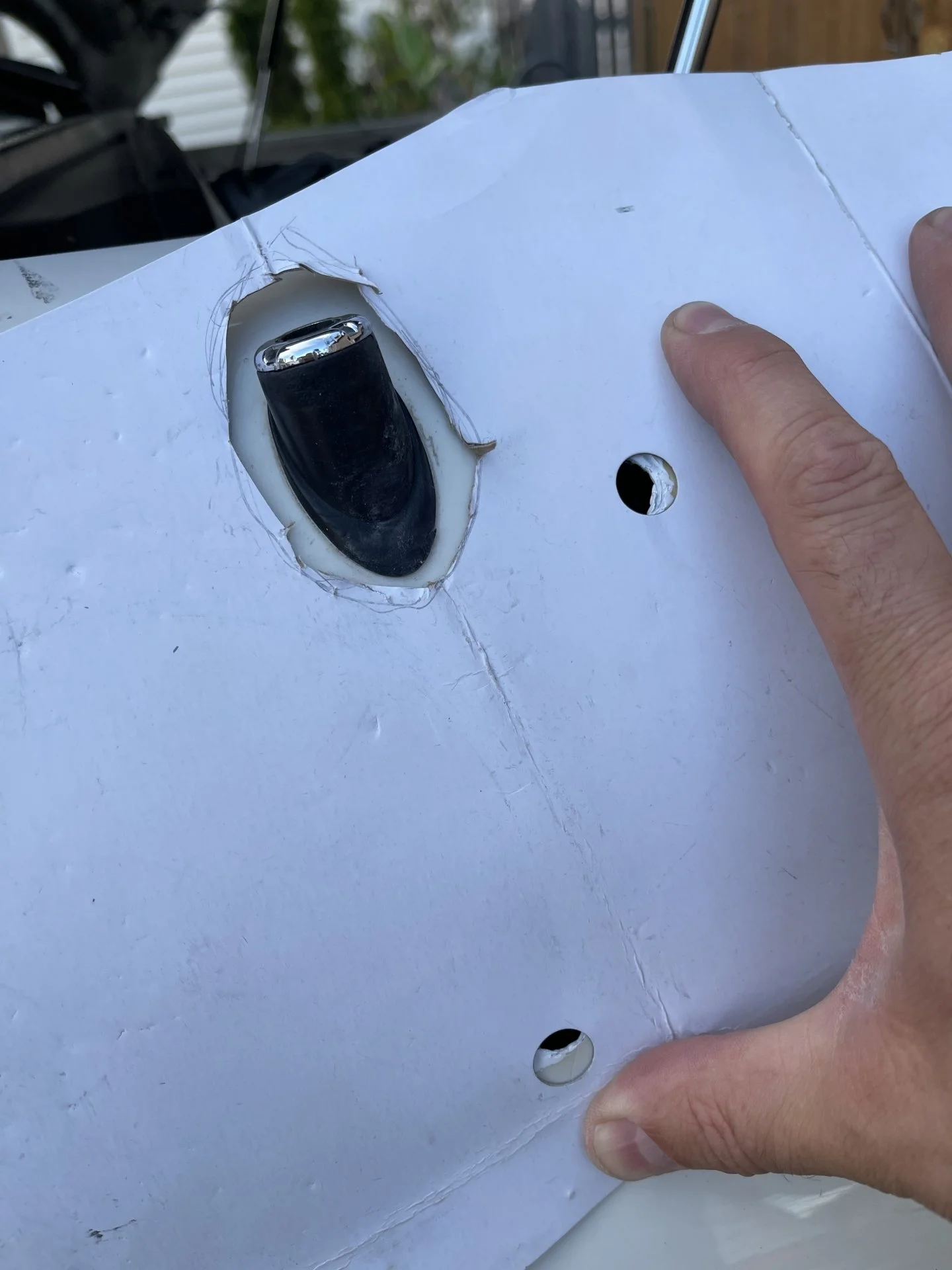

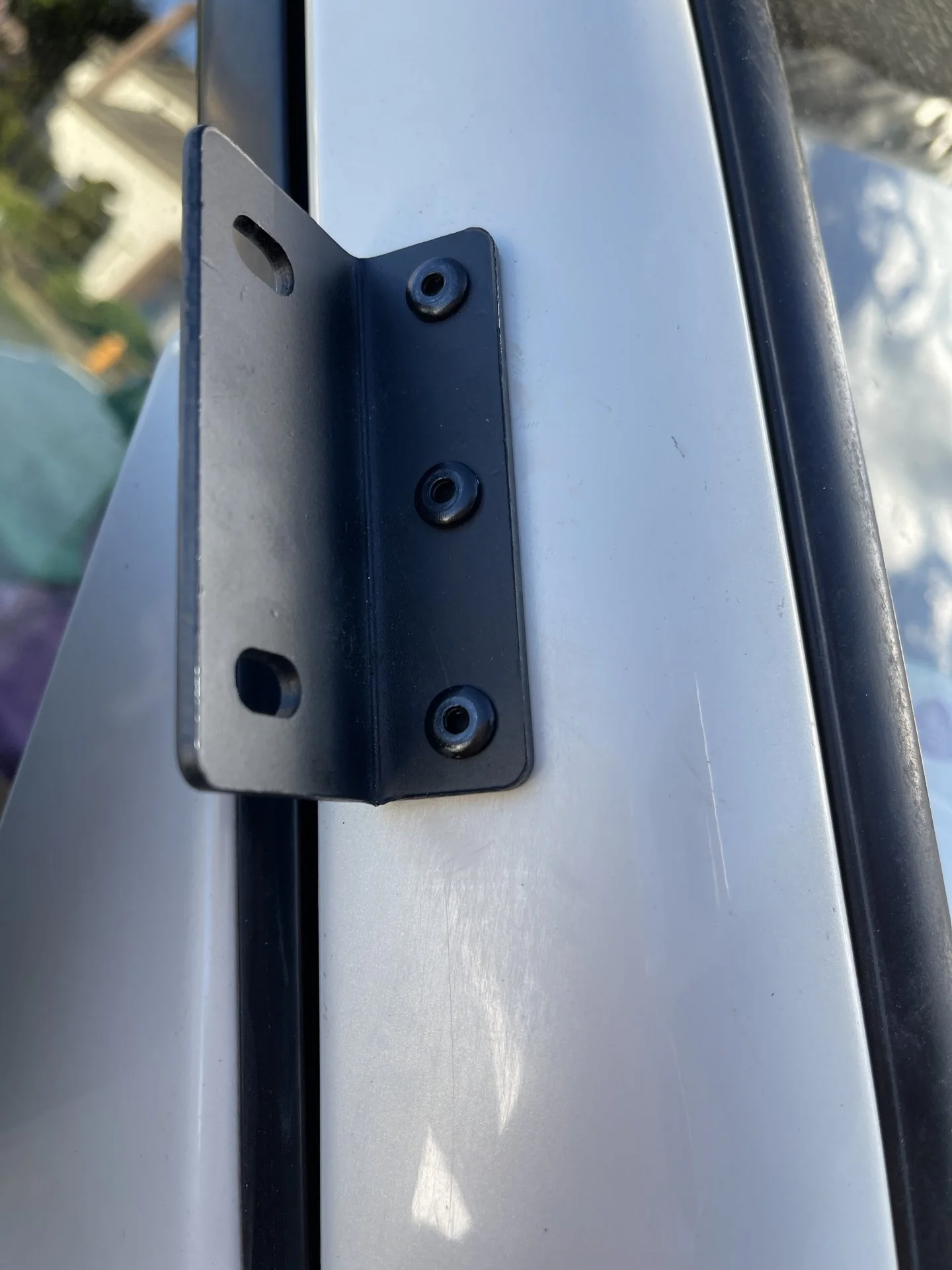

Hey @phi1osopher — appreciate the details. "No instructions" was a weird place to start, but thanks to your pics (and checking, double-checking), I got it installed in no time.

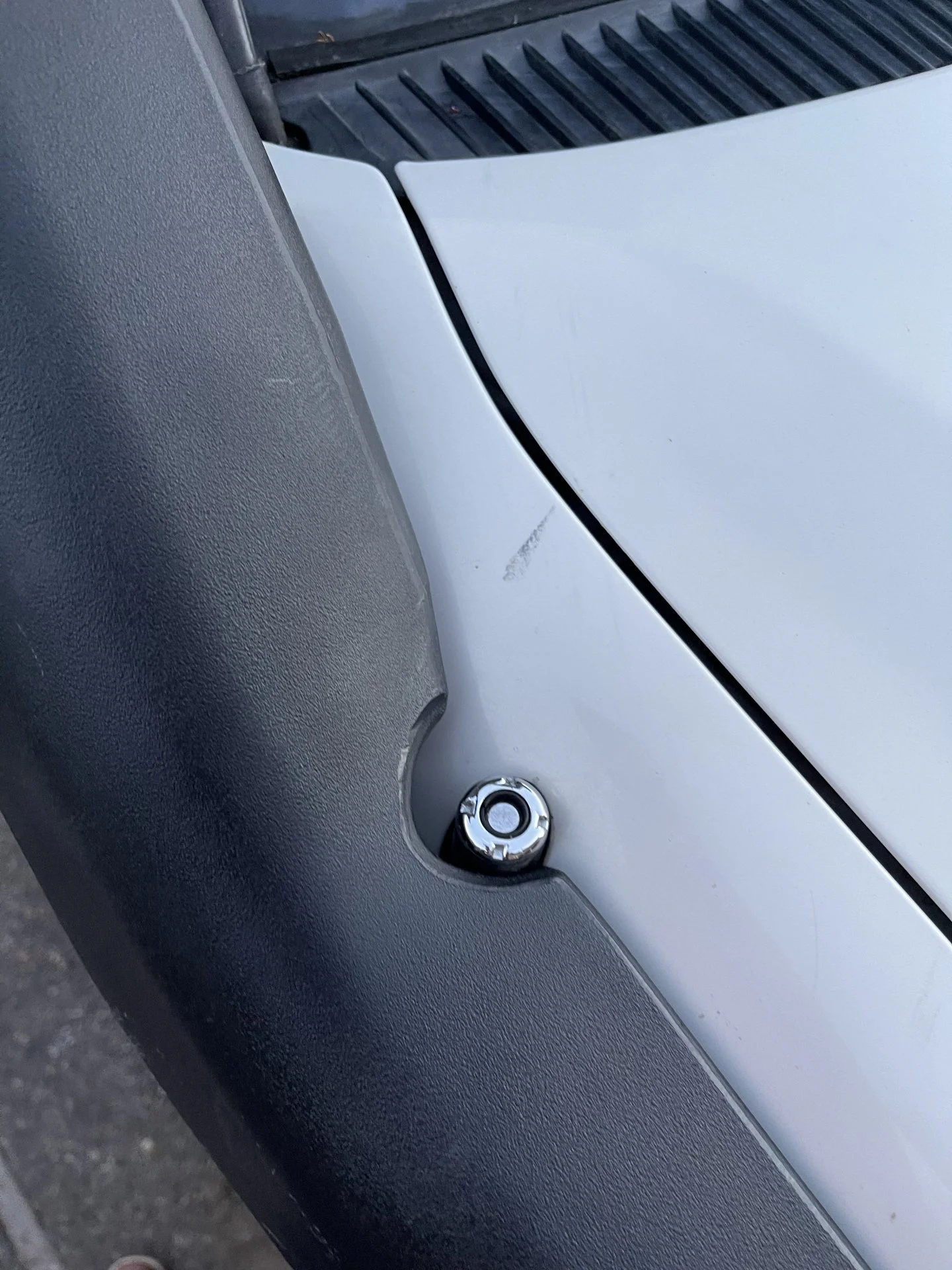

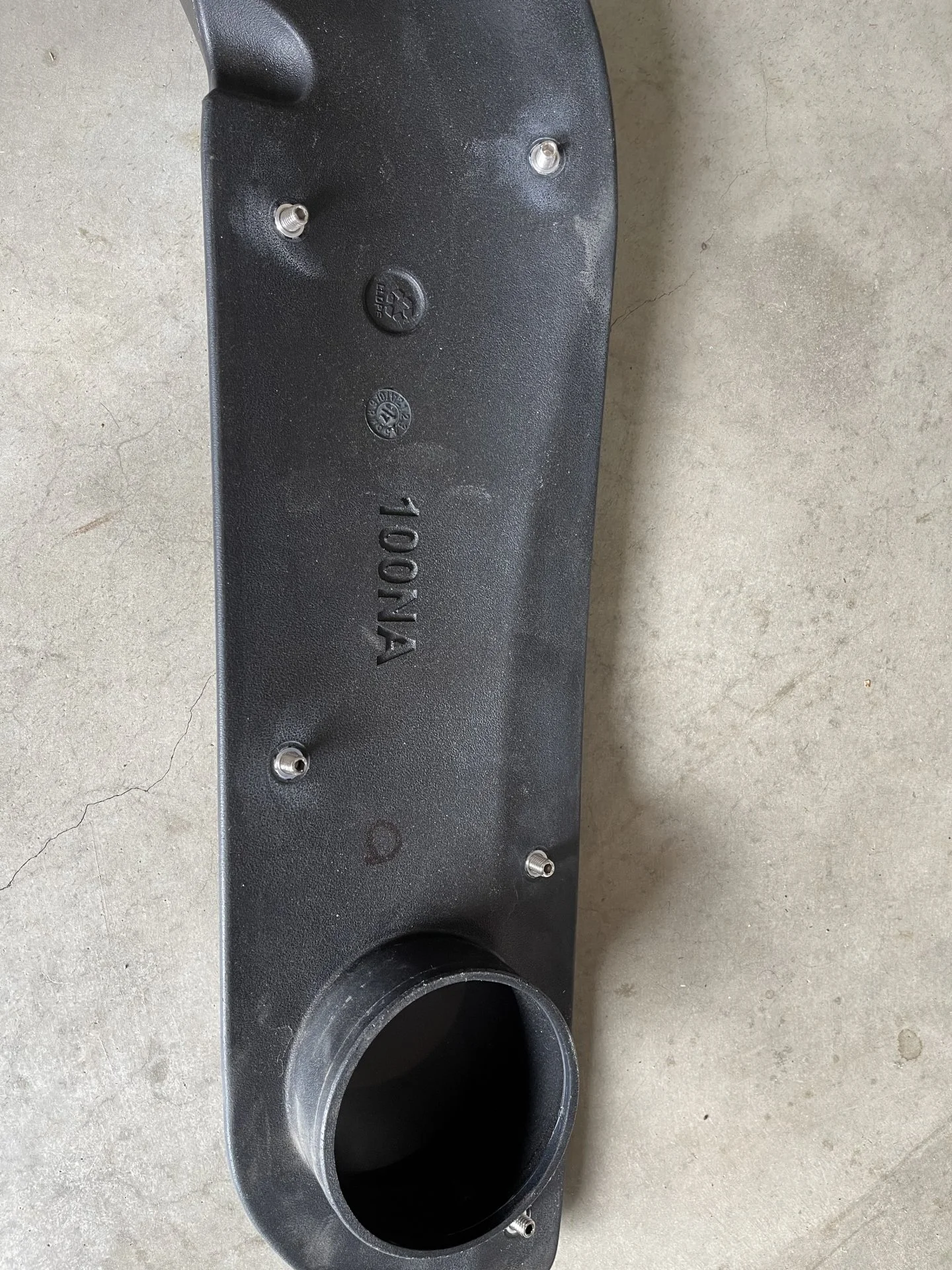

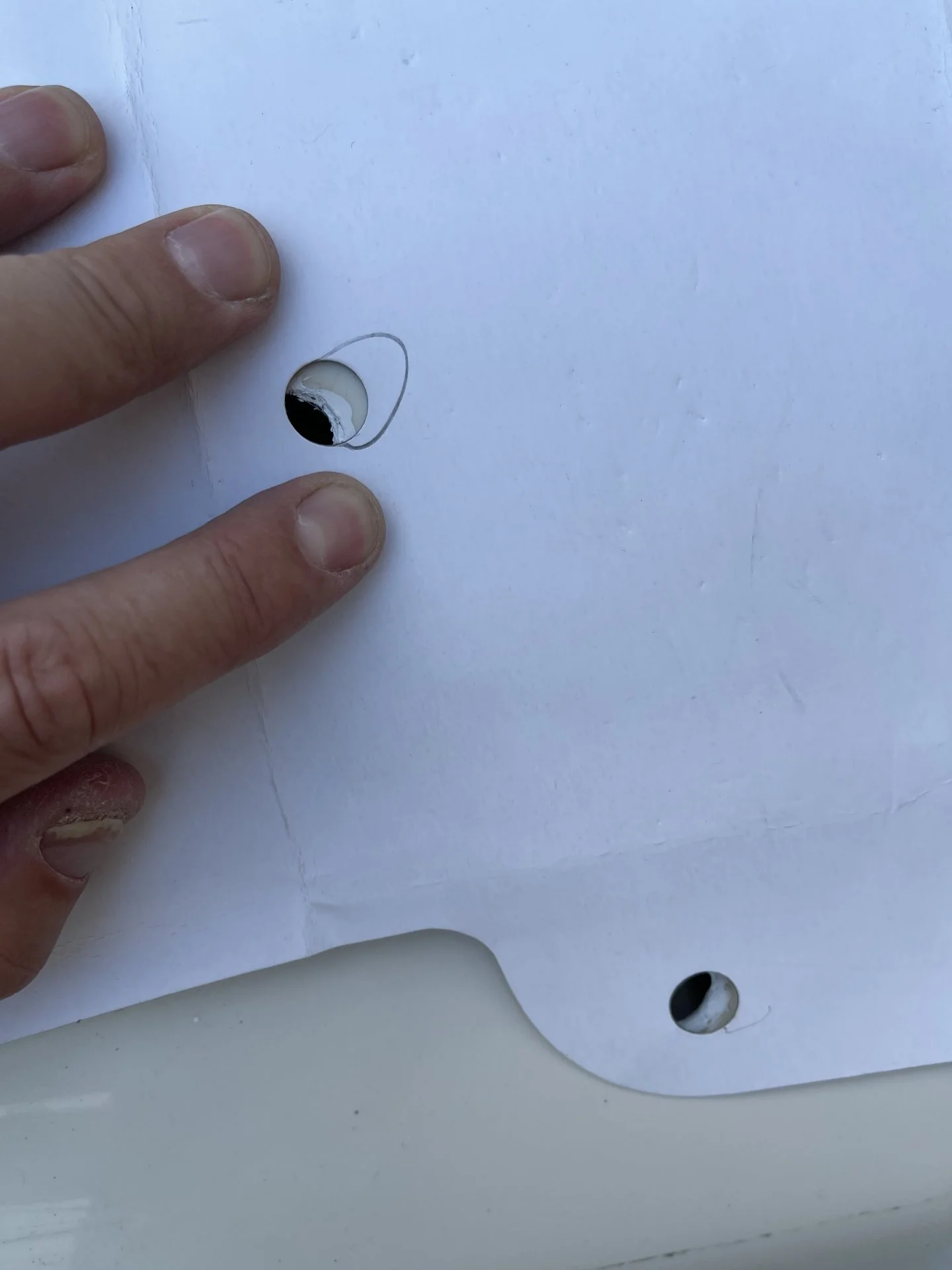

Just installed mine with your help. eBay special $88 shipped now. My template holes were a little off or I did it not exact. My screw posts were too short also so I put the bolts on first, then screwed into the snorkel from the inside.
