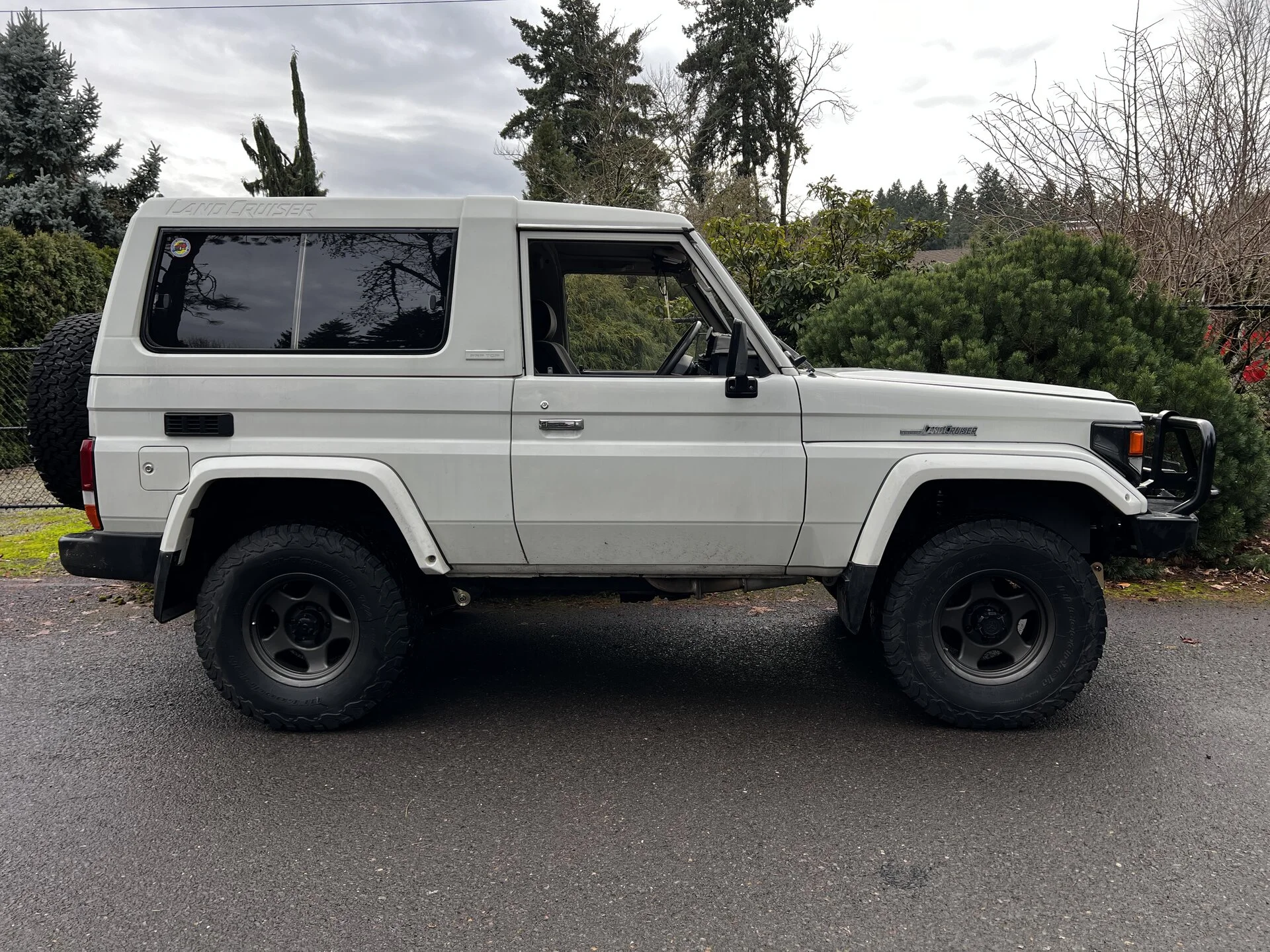

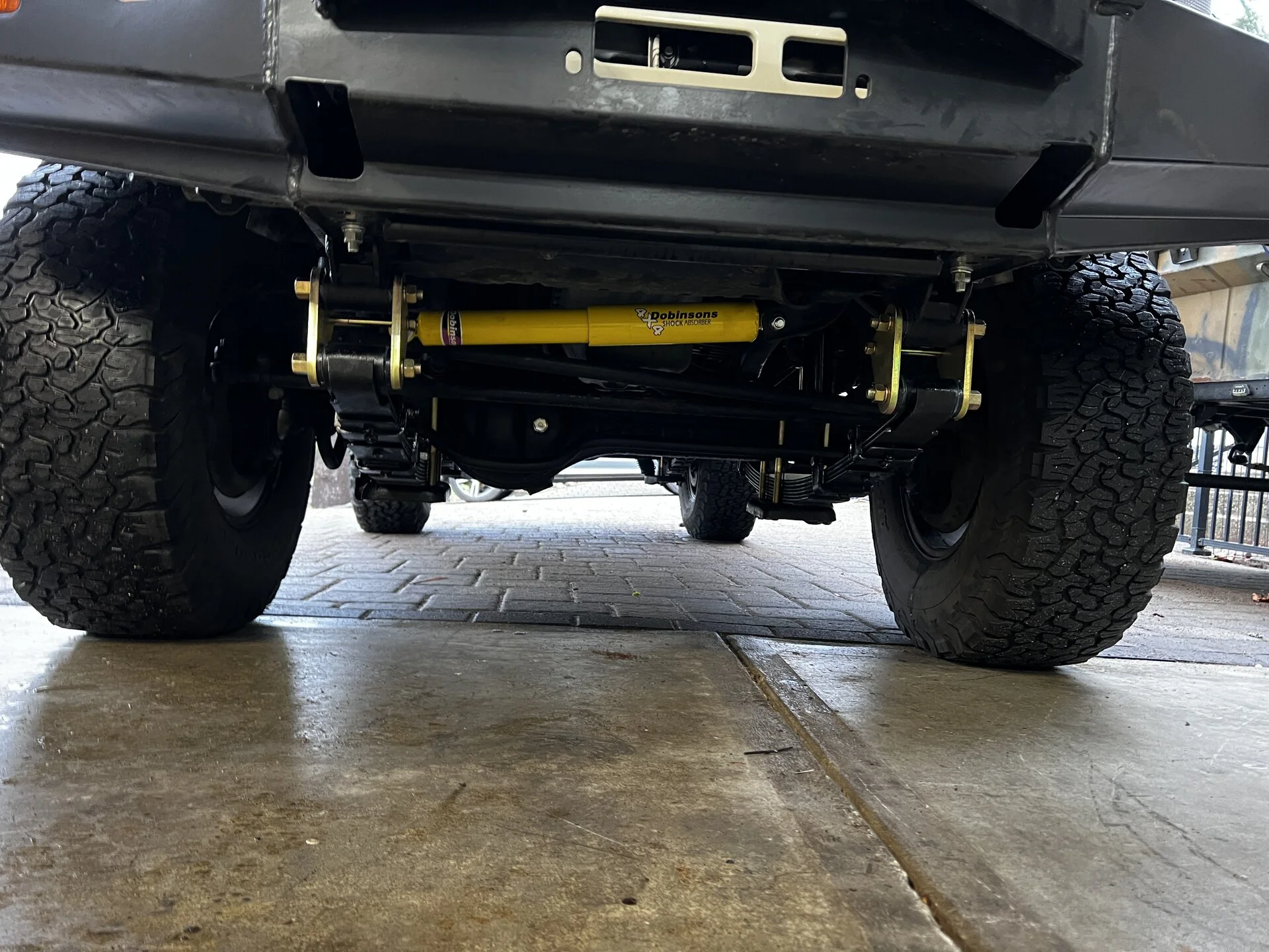

Finished up the lift over the weekend. Happy with the Dobinson stuff. IMS shocks are nice! Ride is so much better without the flat stock springs and the long extended shackles. Gained 2" of lift but expect that to settle some. Happy with how it sits.
Before and after shot>
Extended the rear bump stops with these>
Adjusted the LSPV yesterday and have great braking. Waiting for it to settle to see if it needs more/less.

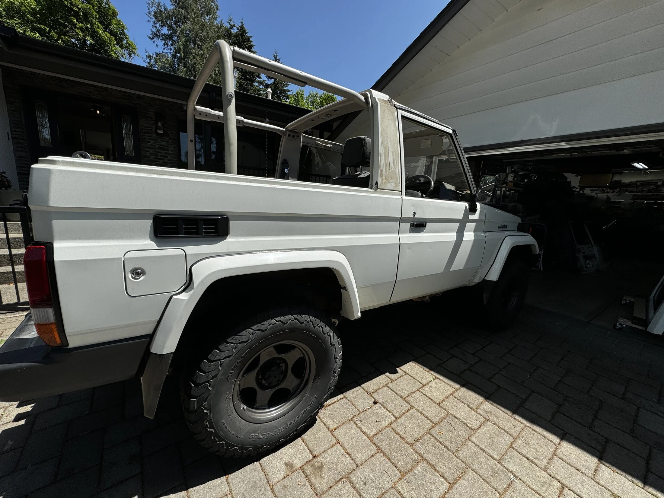

Few super minor things done-did on the 73 last weekend. Sound deadened the rear doors with more Second Skin Damplifier Pro. The doors close with a thud instead of a twang now. Working my way around the rig as time allows. Good to see rust free inner door skins.

On the hunt for some rear doors to chop down. Lost the rear door speakers so will add something in front of my drawers for summer. Rolling without a license plate light for now too. Oh. Way more diesel fumes circulating than I thought. No regerts. Wish I had hair.

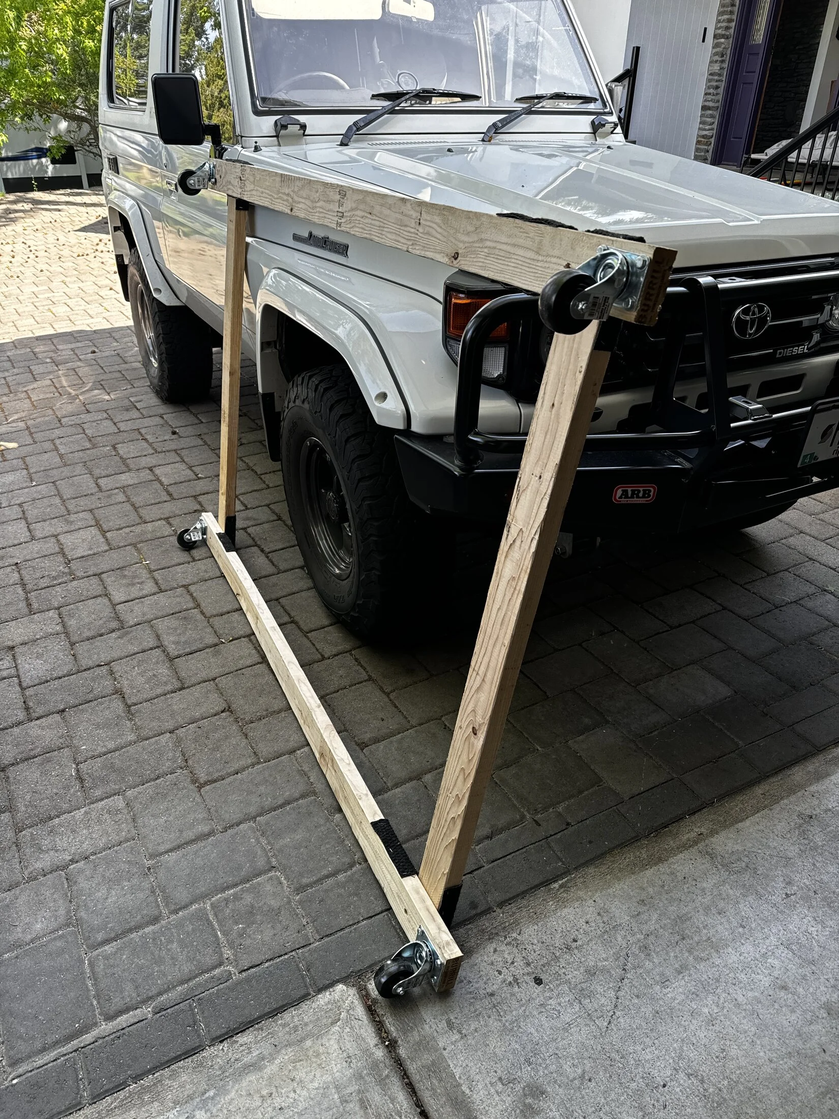

Nice. You gonna replace the top seals and stuff while you have it off?
Also, don't worry: I get tons of diesel flowing in through the rear windows...so taking the top off didn't make it worse. Wish I had hair, too. Nice dog. Bonzo approves. 👍
Yup. Have had all new seals in my stash since last year.
@Guyute ... In what shape were the FRP top seals in? Would you have been able to reuse them if you needed to put the FRP top back on?

Compressed but decent shape. I'd think they'd be good to reuse but haven't pulled them from the top yet. I had noticed that some of my seals bleed black and on the white rig it's pretty noticeable. No leaks. The sliders and windshield gaskets/seals are my worse case.
63161-90K01 for sure. I'll have to check on the others. Was doing mad orders last year when rebuilding the 1HZ in the other rig. So I was hiding happy little Stedman boxes from the wife hand-over-fist.
