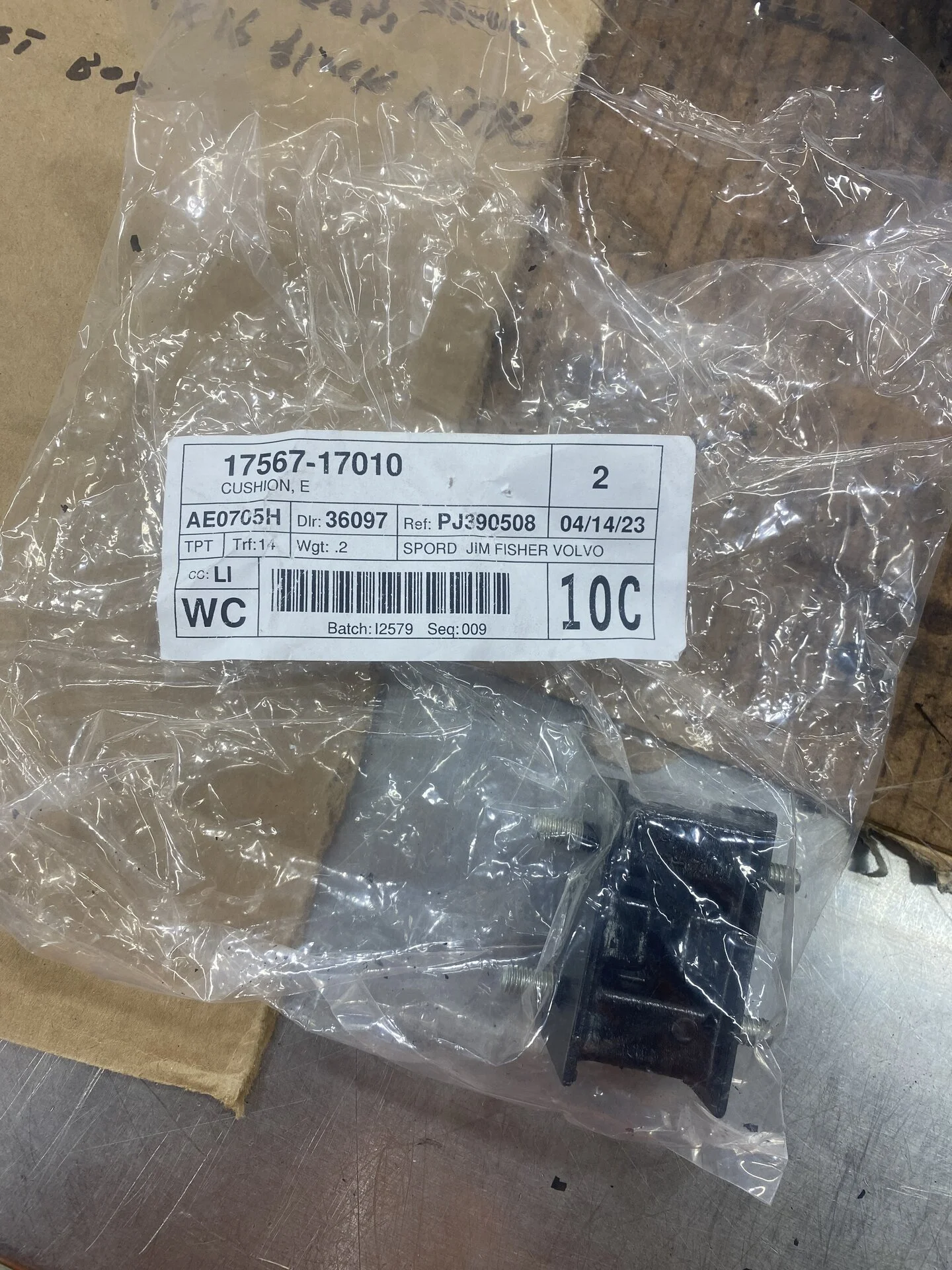

Exhaust hanger mounts broken and exhaust rubbing in drive shafts? Maybe I had a similar noise and this is what it ended up being. There are two. Grab ahold of your exhaust when it’s cold and see if you can move it up and down.
