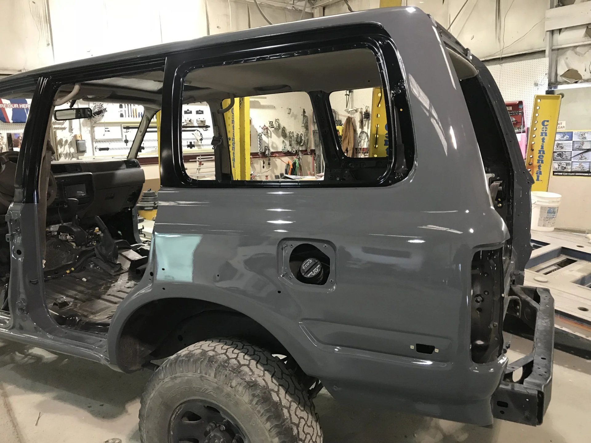

Shell is finally completely painted, bringing back to my shop today for full assembly!
Also getting: slee front and rear bumpers
slee 4 inch lift
4:88 gears along with complete axle rebuild
315s on stock powder coated rims
9.5xps warn winch
all new bushings in the rest of the suspension/ new brakes all the way around
arb draw system in the back
hopefully a new roof rack, but don't have that in my possession yet
and hopefully a turbo when it becomes available from wits end!
