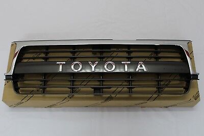

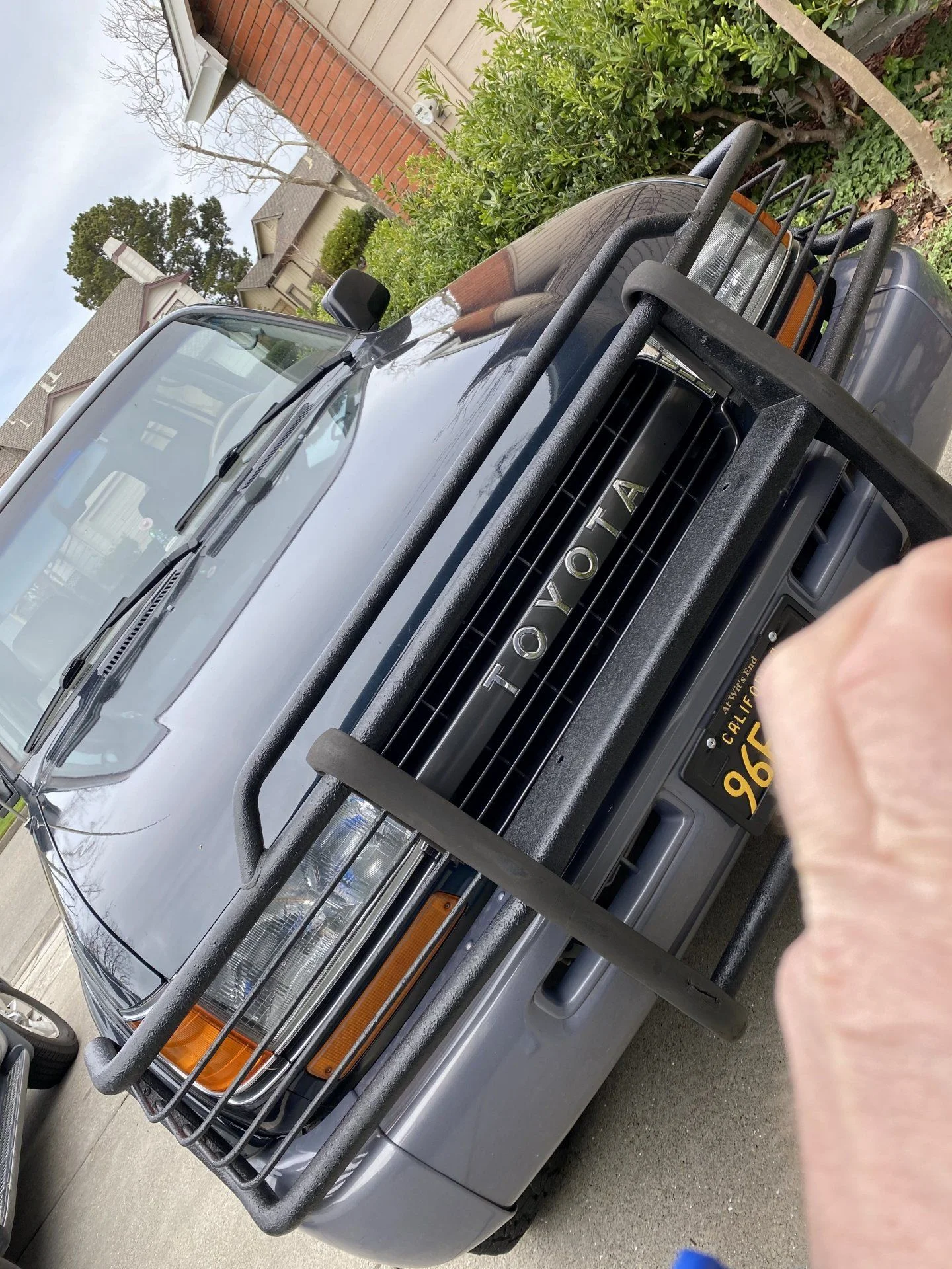

Bought a new grill on eBay for $150. Older model style (94 and before?) Fits well on my 96. I prefer this look! Comments re: damage multiplier expected, and will be duly ignored. I dig it the look, and she's a grocery getter.
I am surprised that it fits. I know that my 1991 FJ80 and 97 FZJ 80 have two very different and distinct lower valance body pieces. I learned this the hard way as cheap import versions are on Amazon for $40 bucks. The bottom plastic part must be slightly different.
More photos please.
It does not fit perfectly. There is a small gap @ the bottom, but w my grill guard you can't see it. I don't think it's a big deal even if you could see it. Grill came from the middle east. And there are 3 very small holes on the right which i THINK are there for the Turbo plastic nameplate which is probably available over there.
Send more pictures if possible. I'd like to do the same but always thought the fit wouldn't be possible.

I believe this one is from a 94, came in the original toyota box with wood and everything. It was a long time finding it as I was looking for one that had the gold package as well.
I wish it was as easy as redrilling the hole. The problem in on the 94' version (new), the mounting plastic is both shorter and does not sit flush with the rest like in the 97' (old). So I would have to do pretty much cut off the entire plastic bracket and not have any place for the mounting screws.

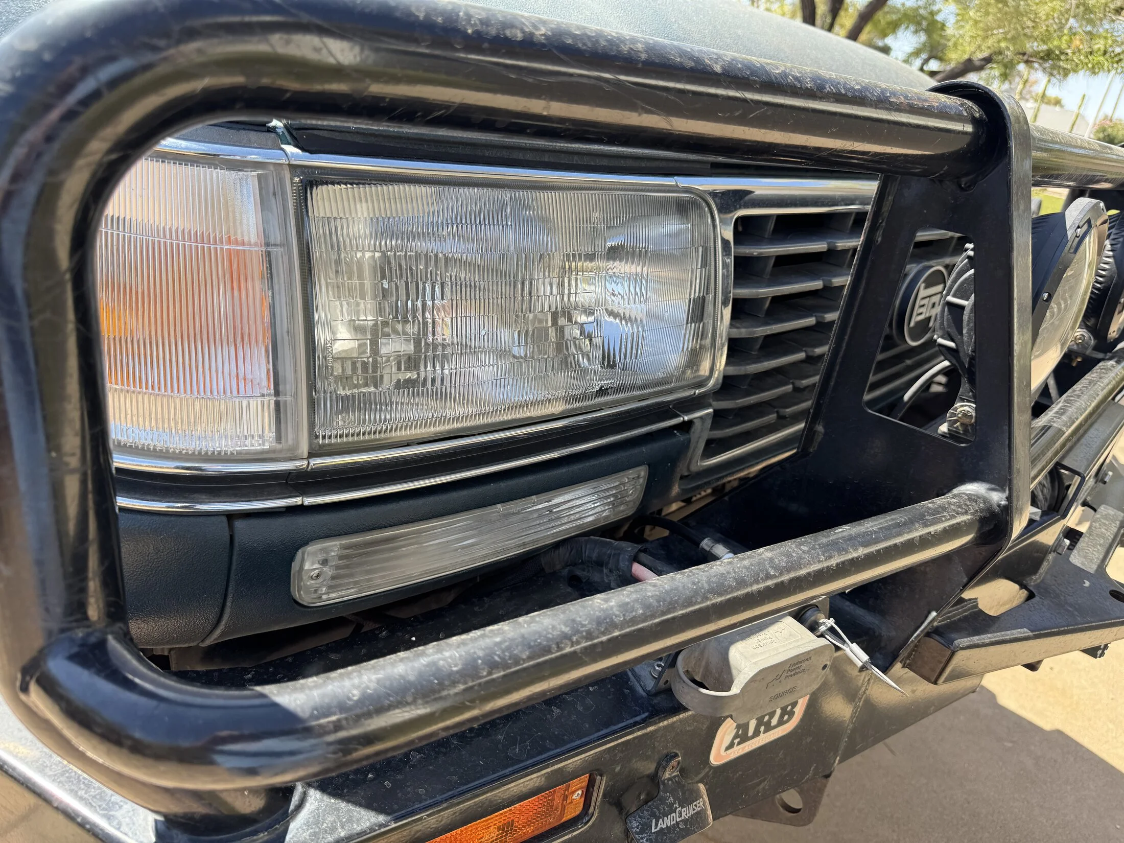

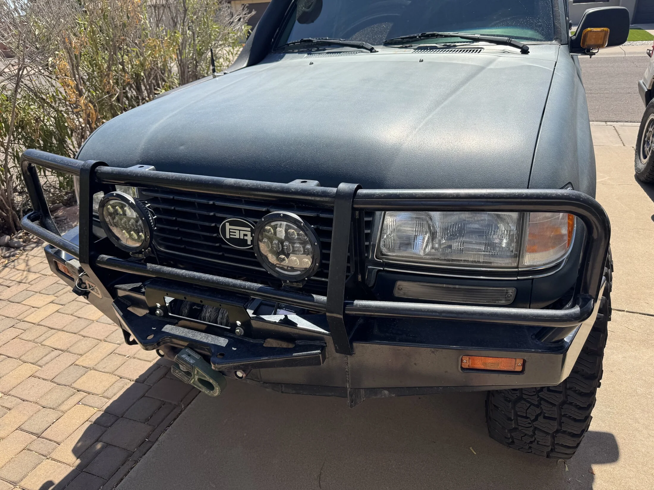

I put the earlier "toyota" grill and matching valance on my '97. Valance bolted up with no issues/mods. Grill required a bit of "dremel" tool work to allow it to sit properly and I may not have installed all of the mounting screws due to alignment issues, don't recall. I did not have to modify the truck side of things at all which was relevant in case I wanted to return to OG at any point.
In summary, you should be able to get the new grill to fit, just spend some time figuring out where the adjustments are needed and take it slow with any trimming/drilling to avoid ruining the new grill.

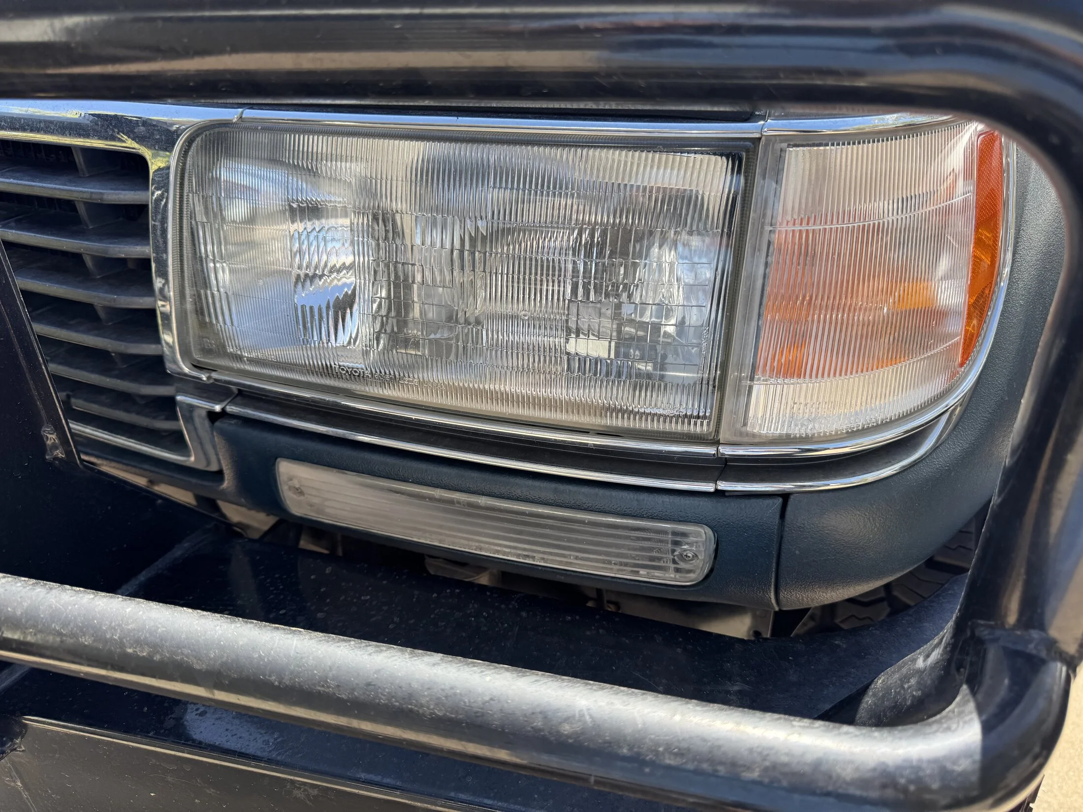

I'm jumping into this with a slightly different problem. The PO of my '94 wanted it to look like a Lexus and changed everything over. I'm currently trying to figure out what 'everything' entails so I can change it back. Seems like grill and headlights at least. Maybe some trim pieces?
