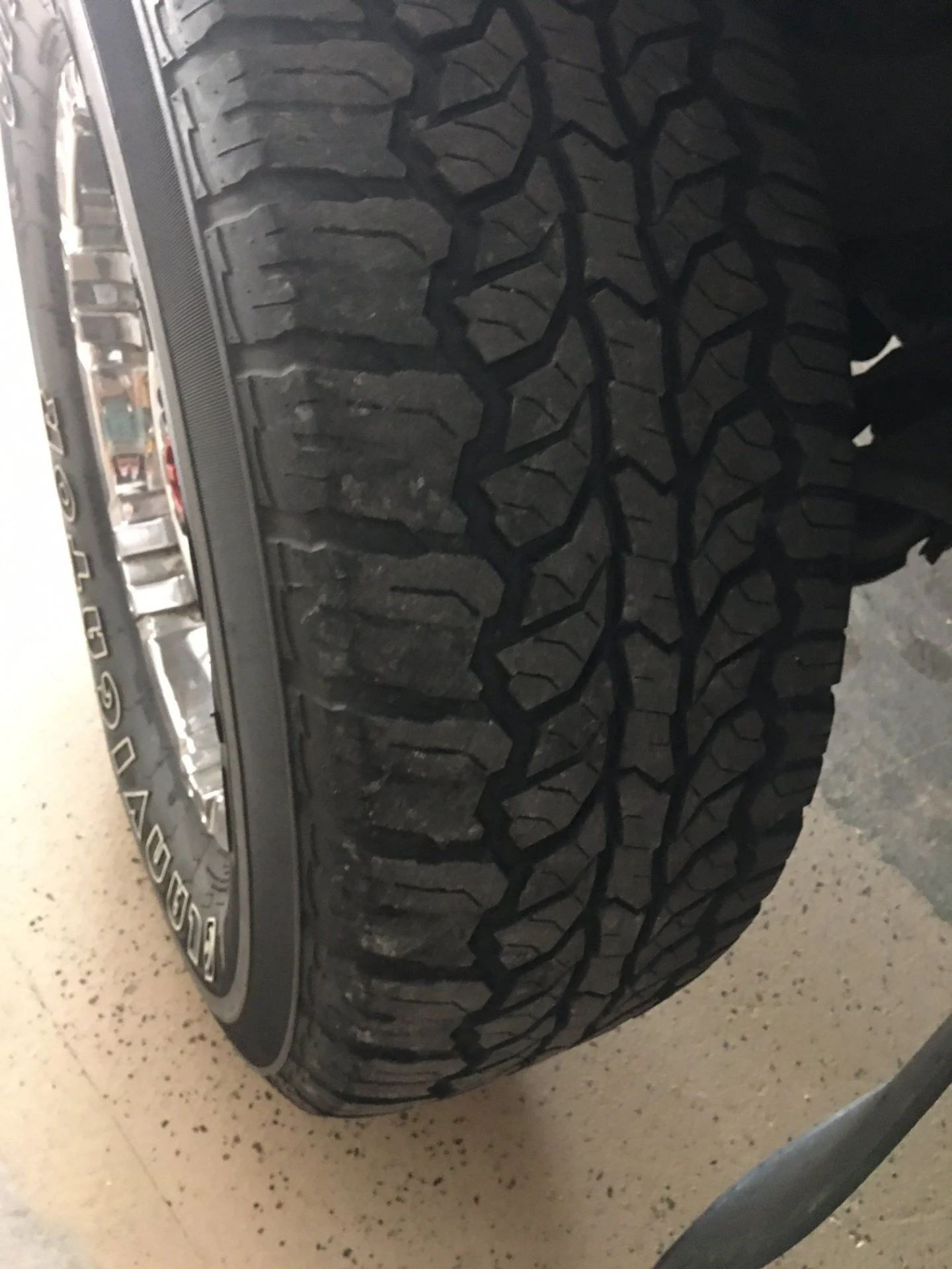

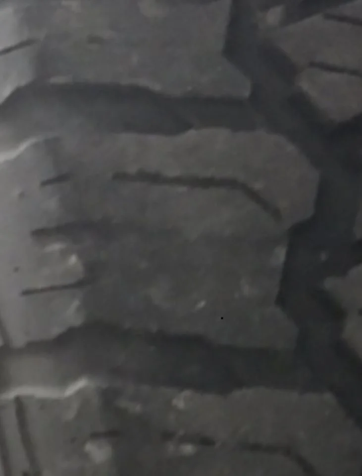

Zoom in on that second pic, do you have a funky wear pattern? @BlueCruiser84 may be right, you may have a worn component or are out of alignment.
This
The tires were overfilled (long story on how my brain rationalized that) which may have contribute to, or have caused the wear funk you (and I) are seeing. I'll report back after hiway driving. Just the short drive I took today was night and day. Uber-Kind, Gents.

I think the suggestion of the front out of alignment is something I would look at. The wear pattern that Grant pointed out would be due to an alignment issue, not over inflation. Over inflation would wear out the middle of the tire, not the edge. Before you take it in for an alignment you need to fix the worn parts that took it out of alignment.

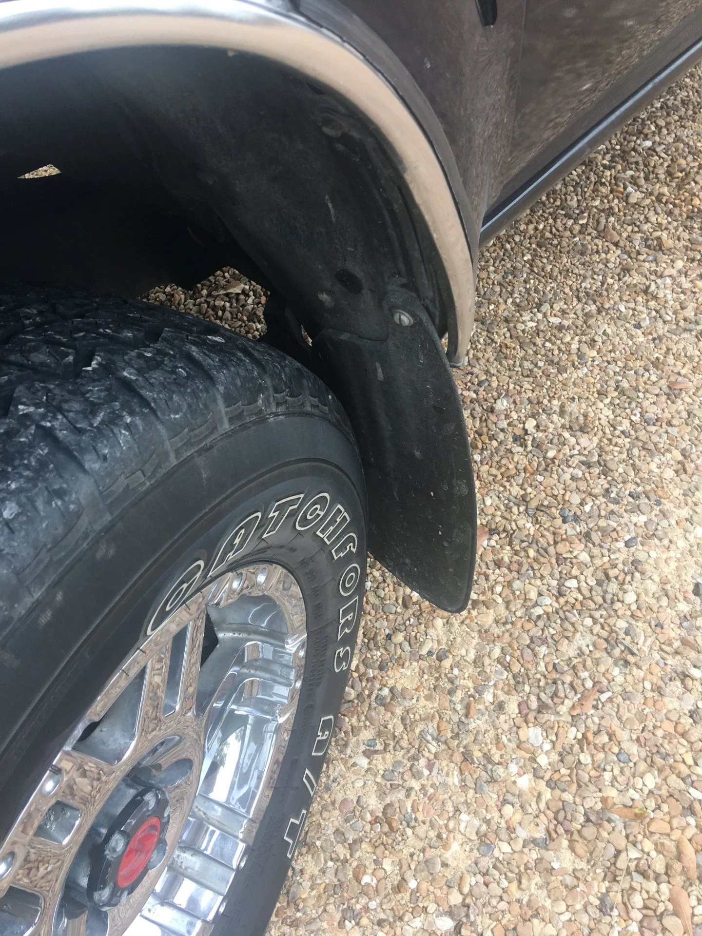

OK - I’ve earned yet another moron badge. Here is pic of front mud flap causing tire tread funk. Yes I’d like new name brand tires, but shouldn’t I also trade the 17s for 16s or 15s? No need to buy new 17 tires if I’m going to get smaller rims.
