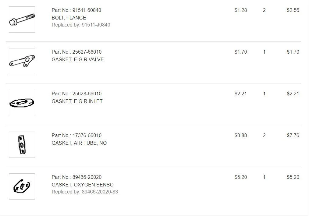

Plate, 17148-41010 (original application 1988 YR3 van).
Gasket, 17376-66010 (same as used by the PAIR tube).
Edited to correct gasket part number typo.

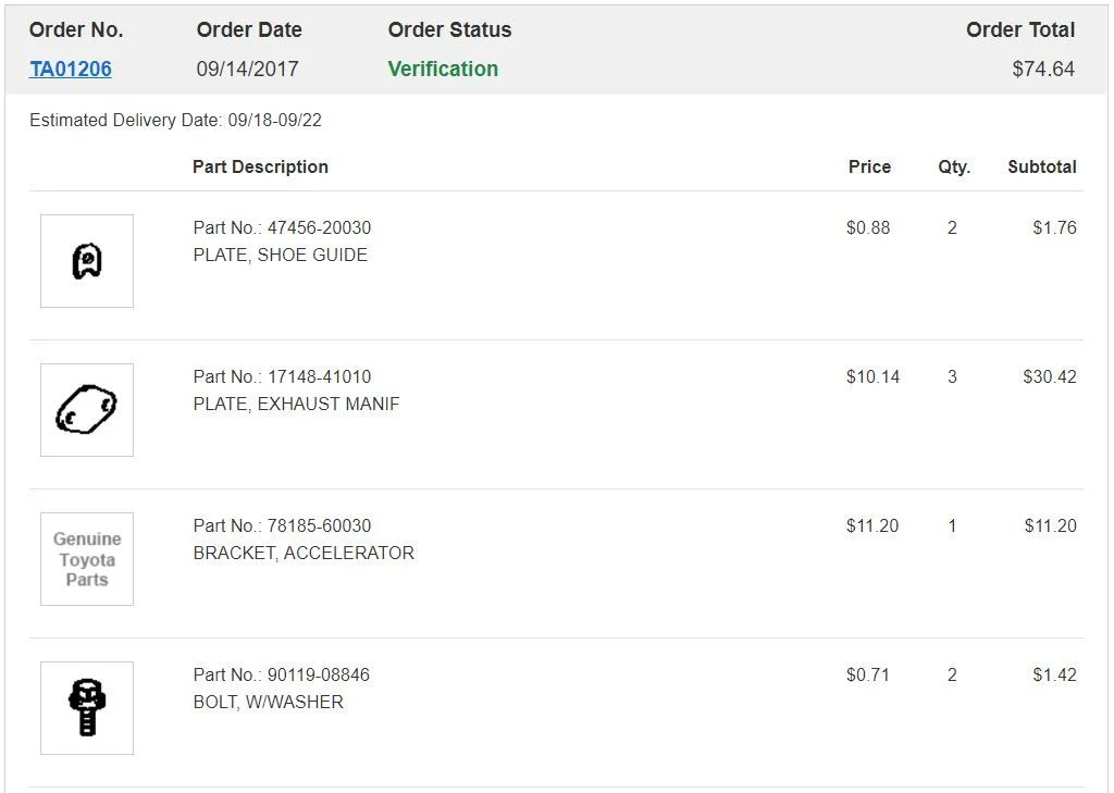

Thank you, thank you very much Sir, if it was not embarrassing I would give you a hug
I worked on Mr T catalog and a few hours ago I ordered what seem to me the correct parts for the job
Happy to see that I got it right
I can Klinger material to cut me more gaskets using the OEM parts as template

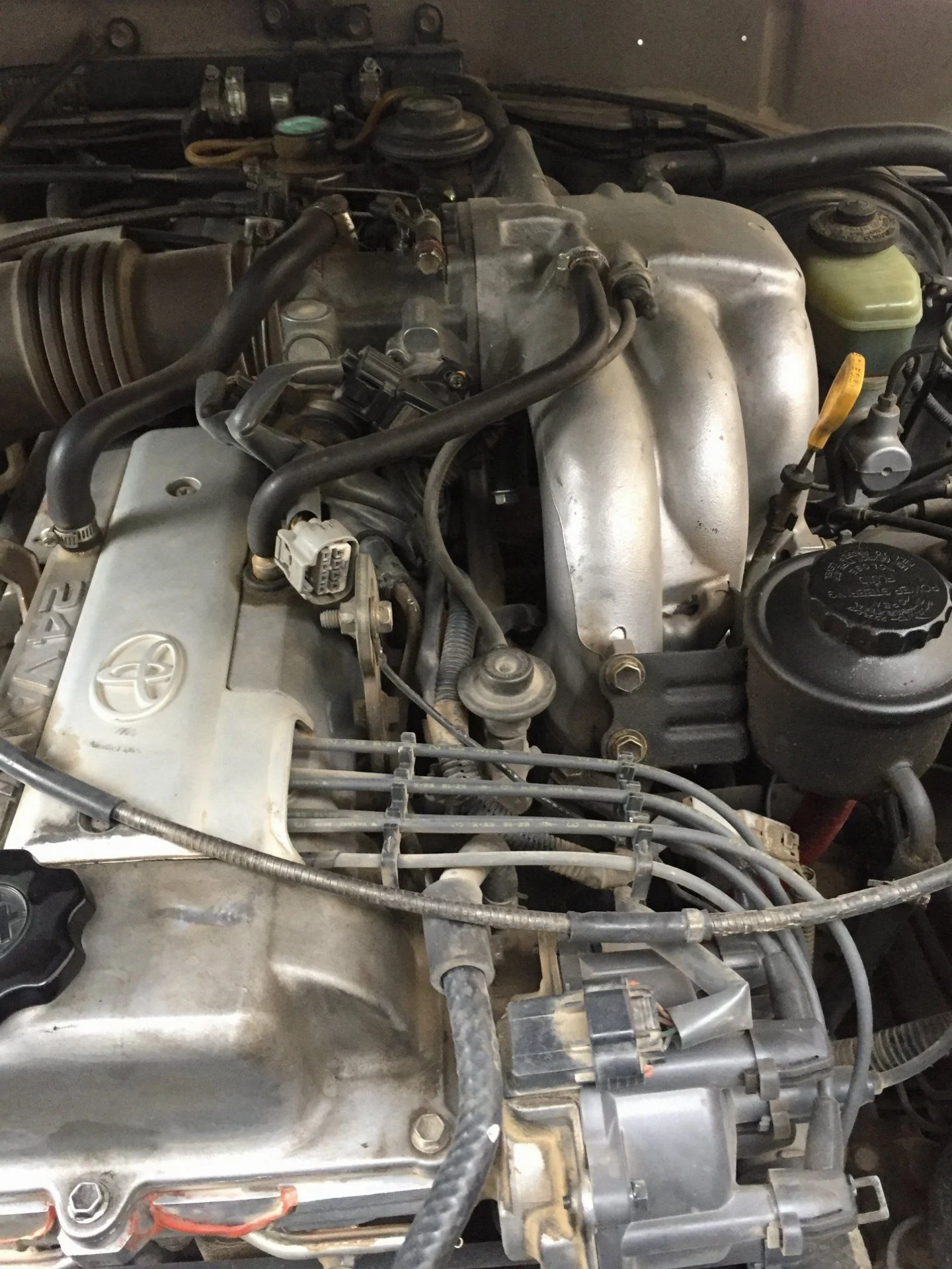

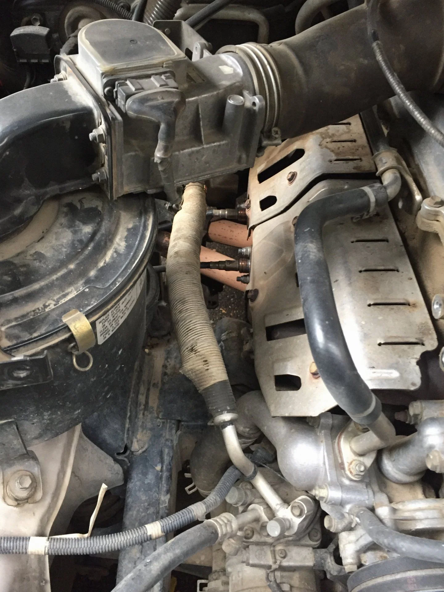

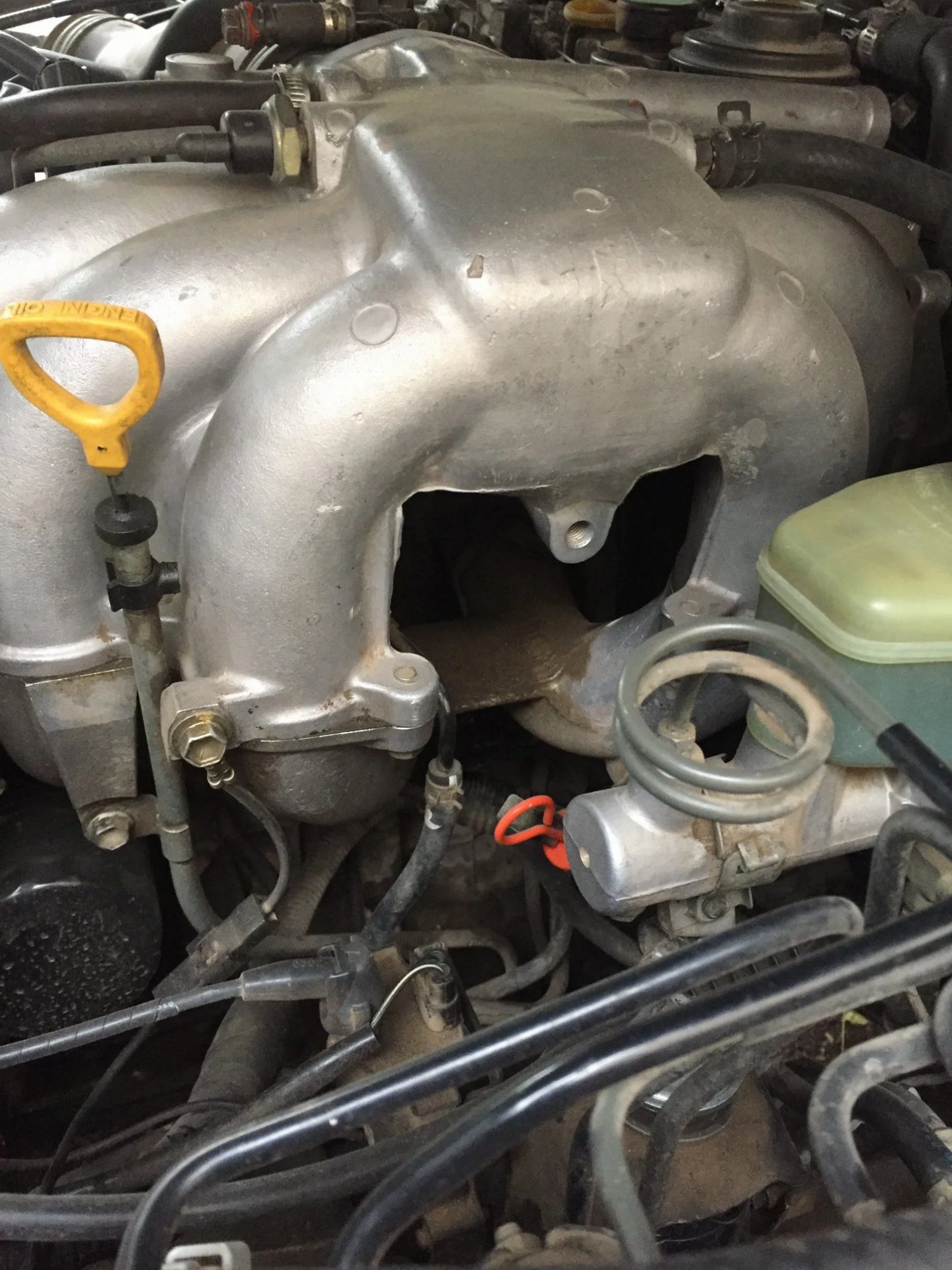

@cruiserdan do you think that the same 17148-41010 plate will be ok on the hole that will be left on the motor side (EGR outlet) after removal of the EGR? If I cannot reach the base of the EGR pipe on the exhaust or is too crowded for the bolts to open I will just block the pipe in the EGR end (EGR inlet) hope this pipe after blocking won't be hot.
Thank you again
The EGR pipe base is not the same shape. You could use the gasket as a template and make a plate out of, say, 1/4 inch steel or aluminum plate.

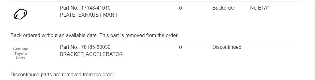

Bad news parts are unavailable (Israel and USA)
EGr on my truck is left on at the moment but is disabled, you can get key chains for the egr from Witts End land cruiser stuff I'm sure he would ship there, or make some super easy

Glad everyone is helping with this. Egr is easy with the head removed. That was half the reason i did my HG. My egr pipe had a crack in it. The intake used plate i made and oem gasket. The head i think had a oem black of plate. Used theboem resistor in the egr harness location.

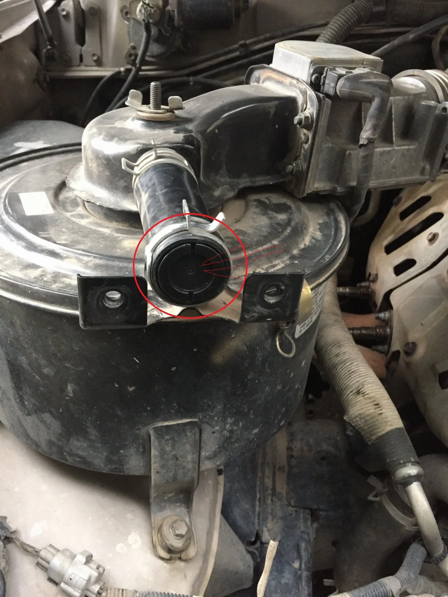

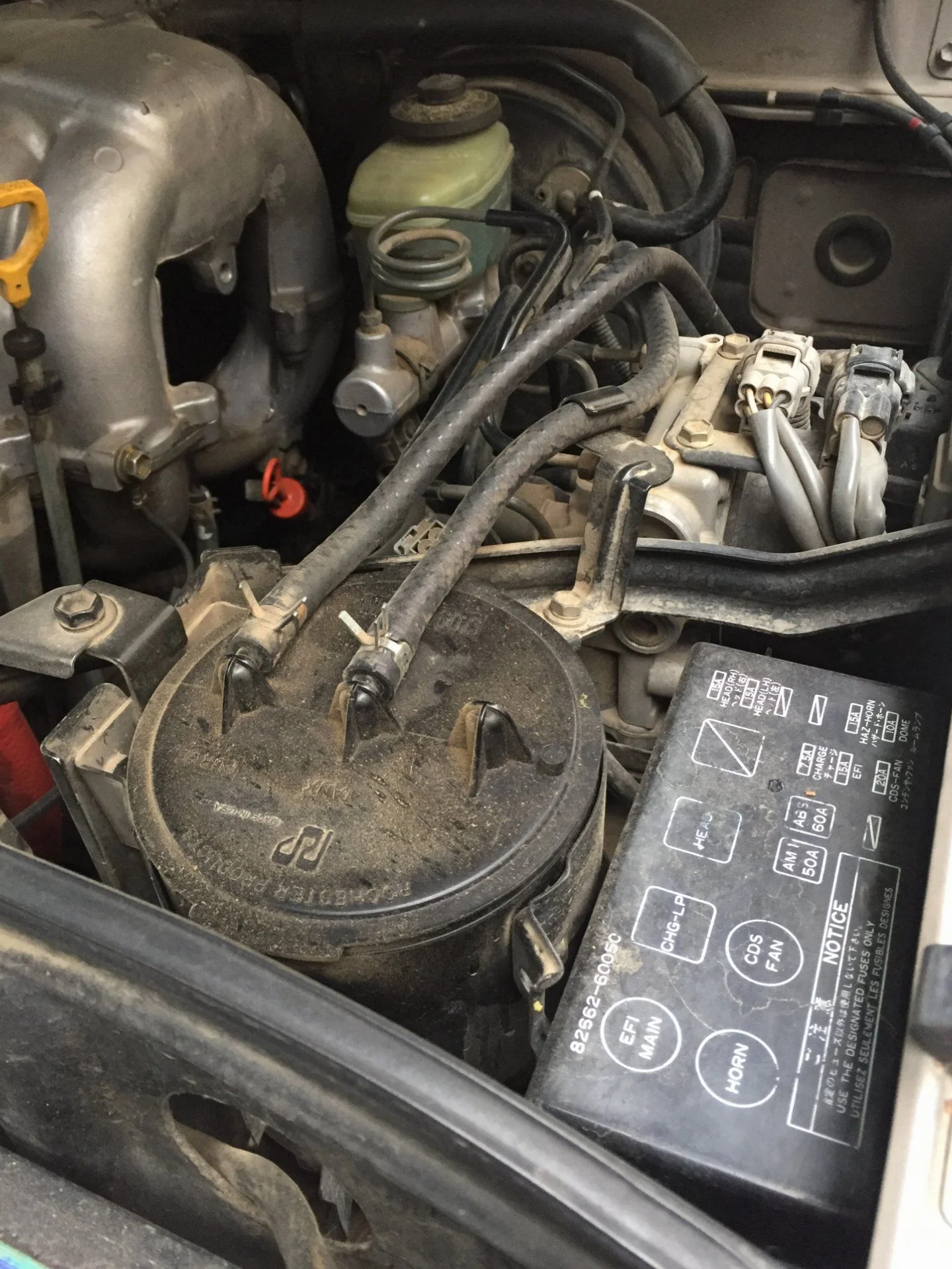

Pair i put O2 up into the manifold and plugged the air filter housinf with a freeze oit plug. Blocked the stock O2 location with the other block of plates.
No codes for about 50,000 miles or so.
