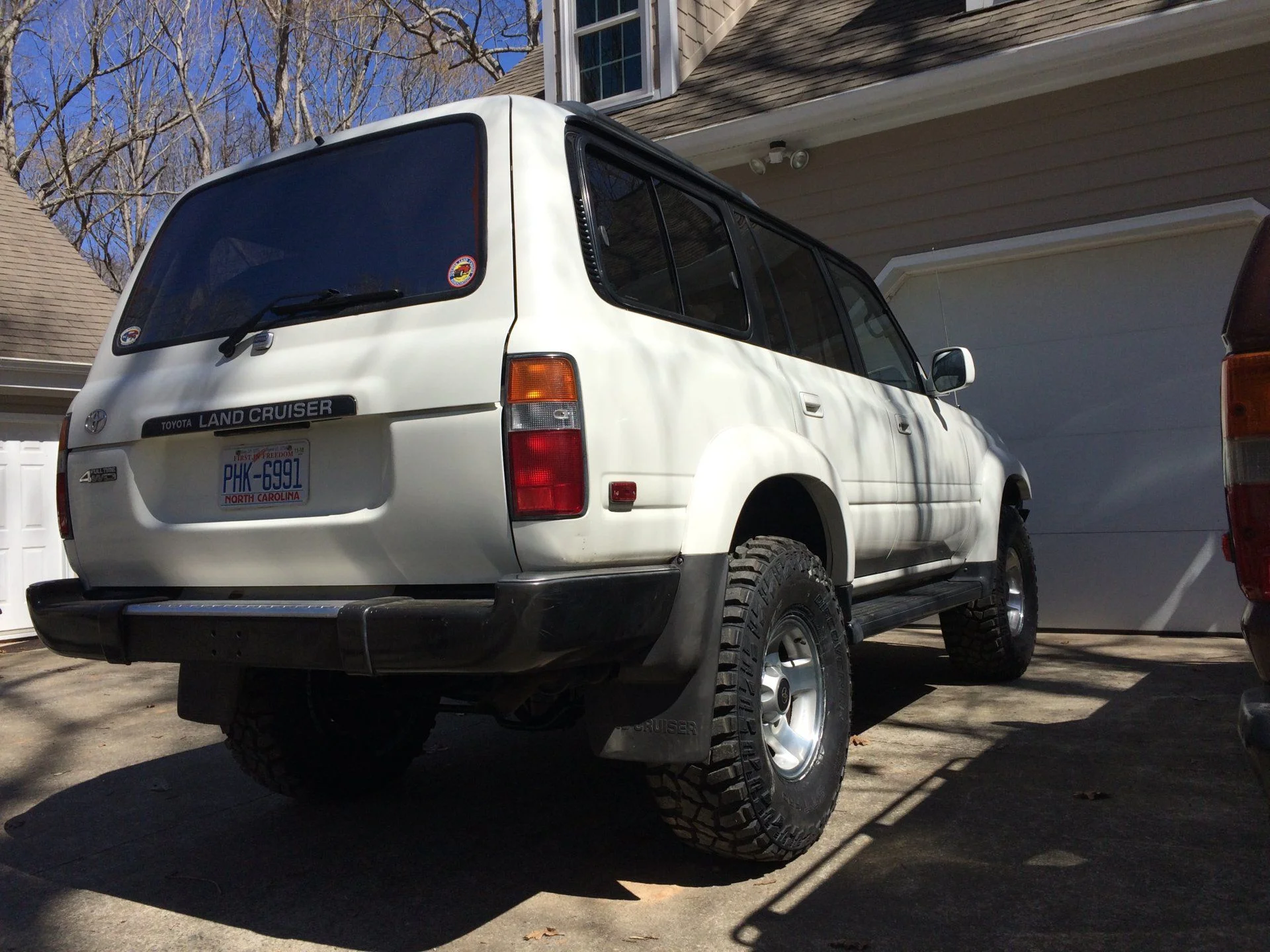

I got the rear wheels back on Cotton. Looking at it as it sits, I can't help but think of an old song by 2Live Crew. You know the one.
A quick trip around the yard was all I needed to verify that the rear locker is indeed working as it should. 2X locked!

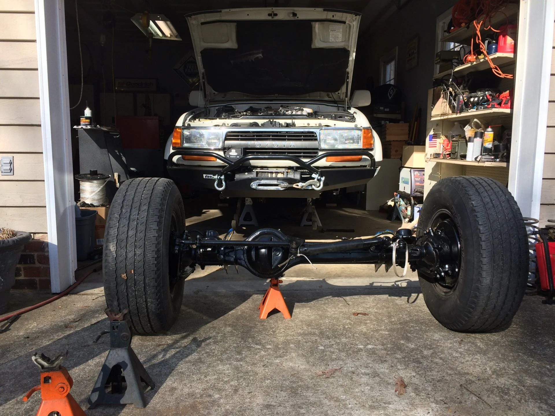

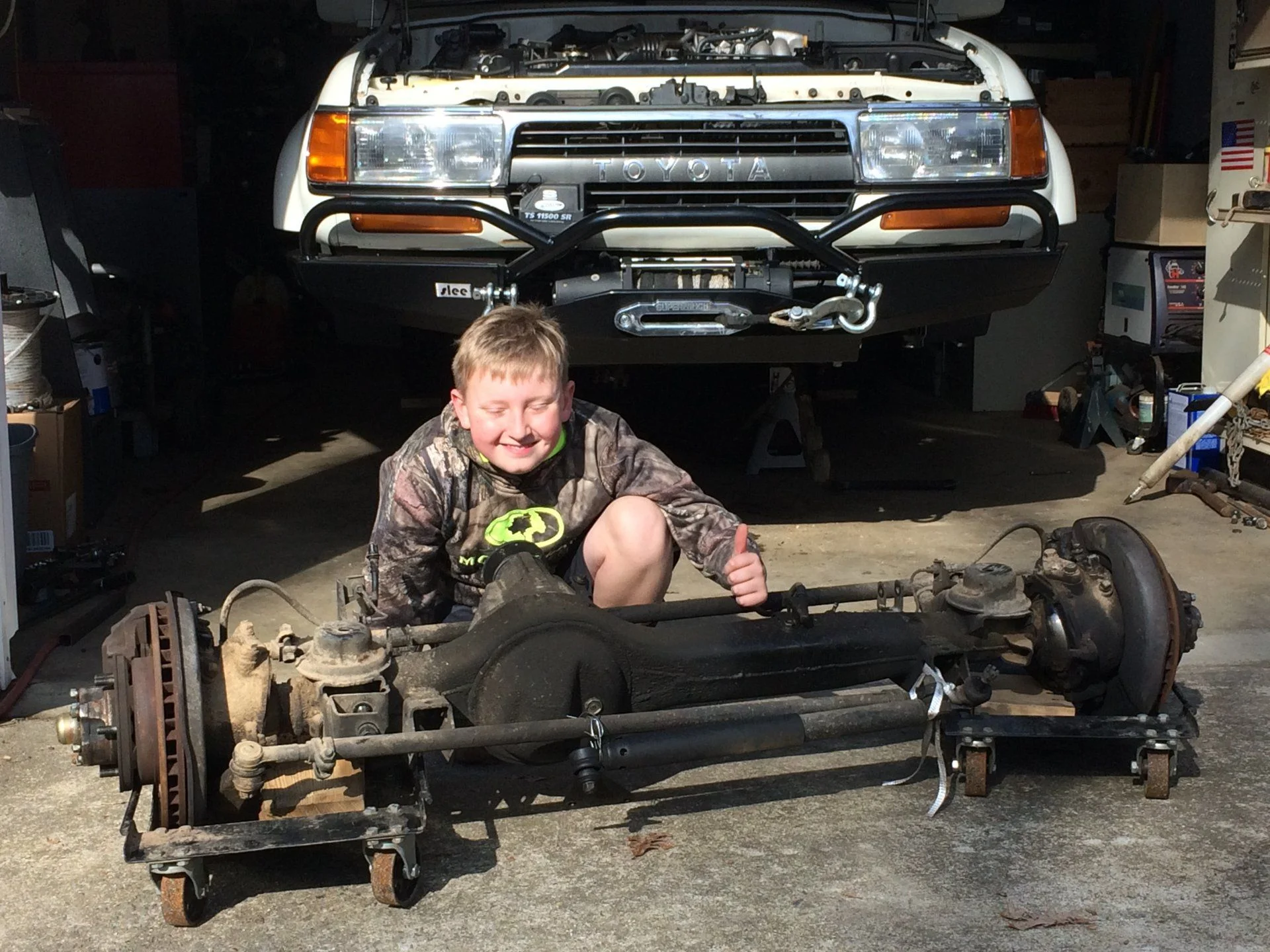

Today, Nathan and I got the unlocked front axle out from under Cotton and got the locked replacement back in along with OME 850J springs. I've still got a lot of work to do. I'll be glad when this little axle swap project is done. It's an awful lot like work.

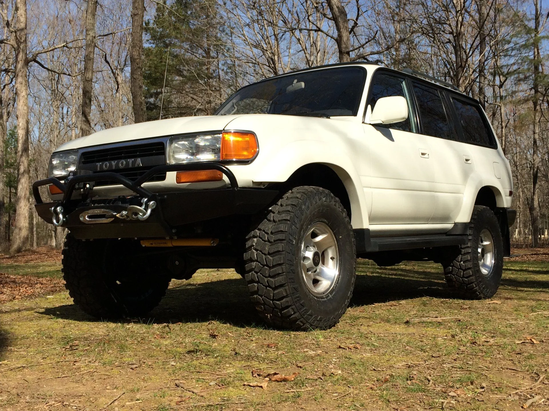

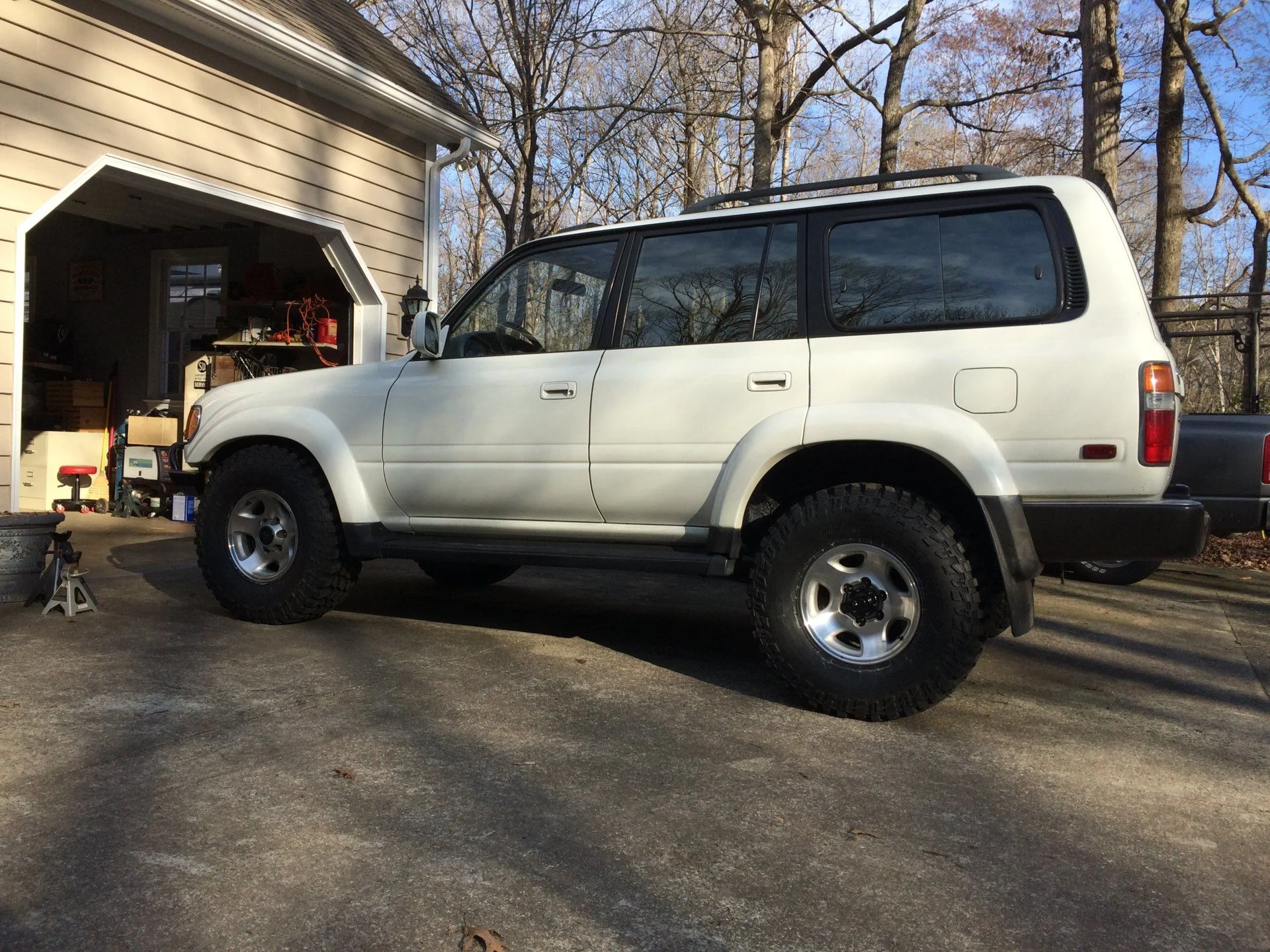

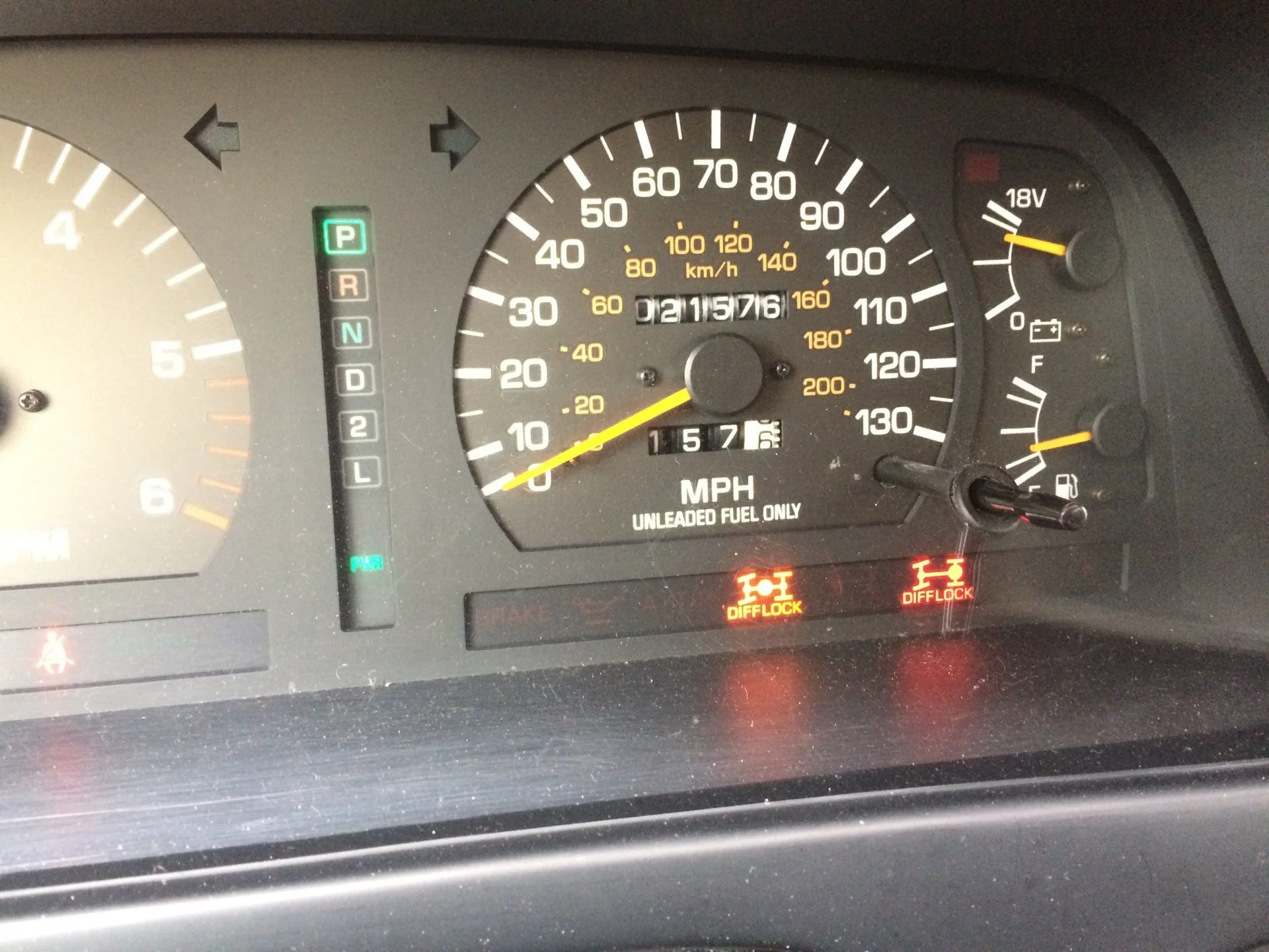

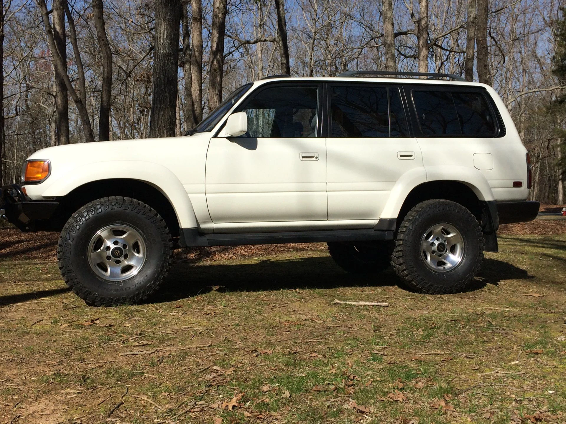

3X locked and lifted! I am wrapping up the lift and locked axle swap on Cotton. Runs and drives fine. Front locker engages as it should. Indicator is not lighting up for the front. I installed bulbs for both locker indicators but I must not have seated the front bulb properly. Either that or I just installed a bad bulb. I need to re-center the steering wheel. I have activated the ABS on my gravel drive so I plan to re-bleed the brakes to wrap up this little project.

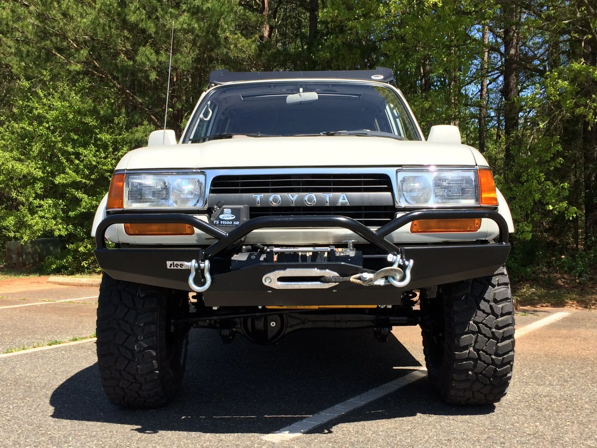

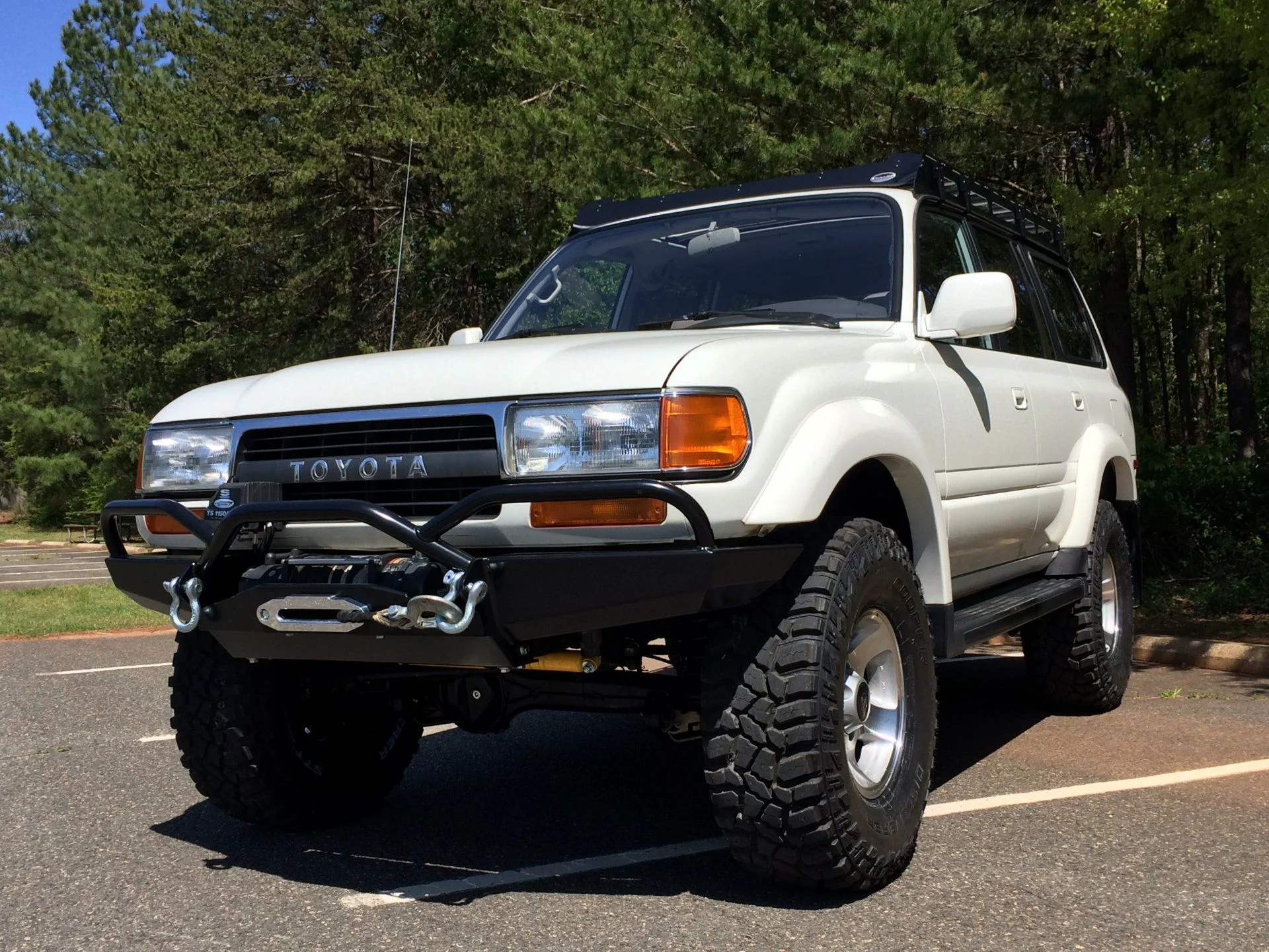

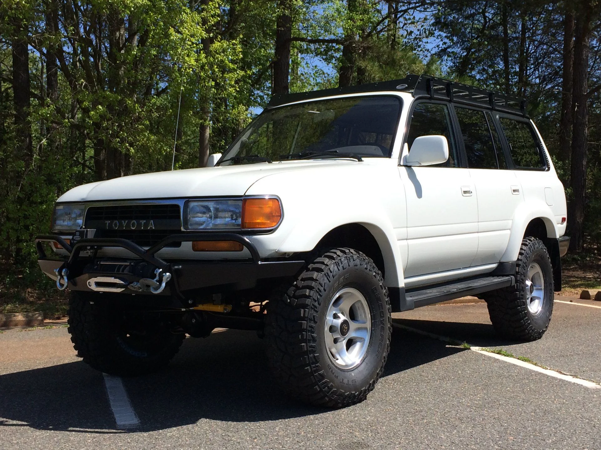

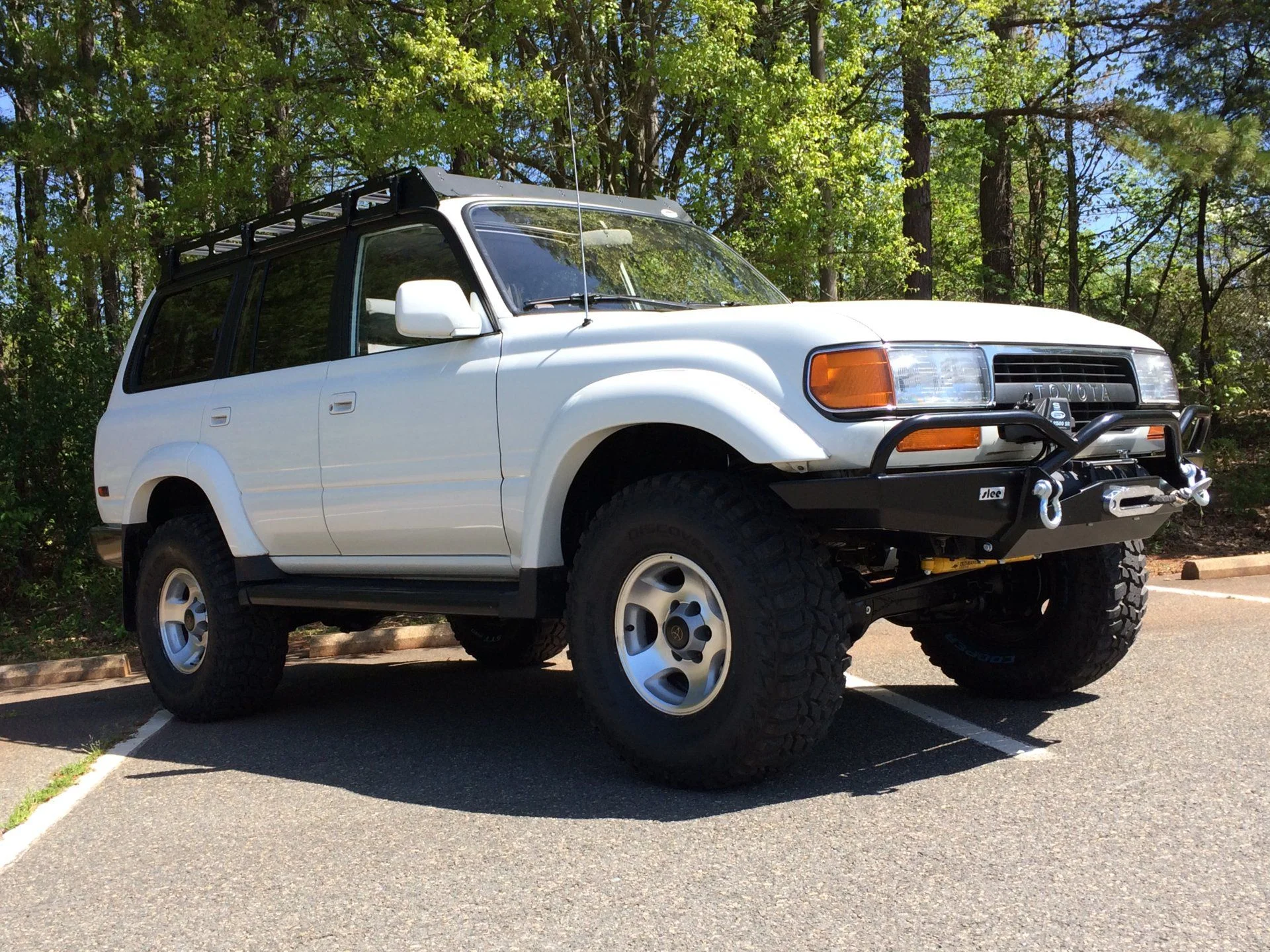

Installed a Bowfin Cruisers @dogfishlake roof rack last night. The rack is a work of art. Well packaged. Fits perfectly. More than enough hardware to install. I'm a very happy customer! The rack doesn't show up well against the dark background in these pics. I'll take more pics later.
View attachment 1679520 View attachment 1679521 View attachment 1679522 View attachment 1679523
Thank you and Beautiful 80! Your truck is a perfect example why I have been wrapping mine white (to be painted white eventually), and am switching back to oem wheels.

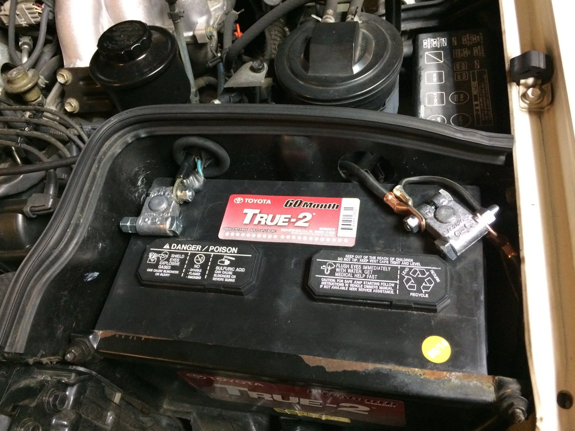

Installed MIL SPEC battery terminals to replace the old stretched-out originals that required sheet metal screws to keep good contact. The MIL SPEC terminals make winch cable and accessory attachment so much easier.
