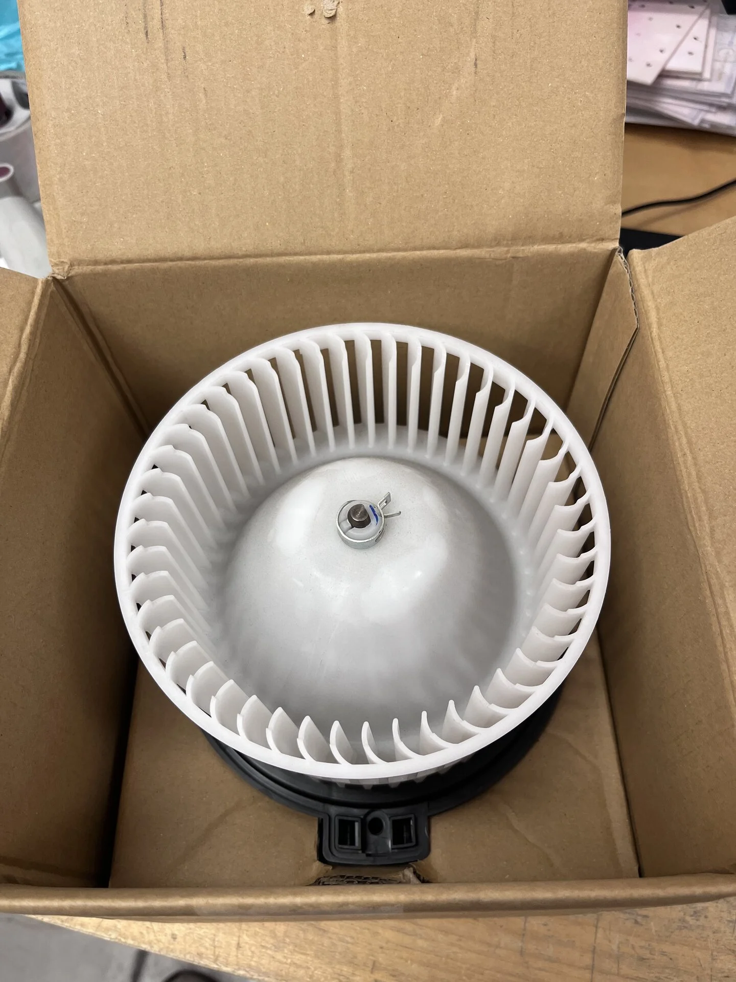

Look at 87103-60150
Still looking for one? I have a couple of NOS OEM Denso unit available.
What year models do your blower units apply to?
Has anyone installed a Four Seasons blower motor, or other aftermarket part, and if so how's it working? IIRC the Four Seasons motors are manufactured in Canada.
