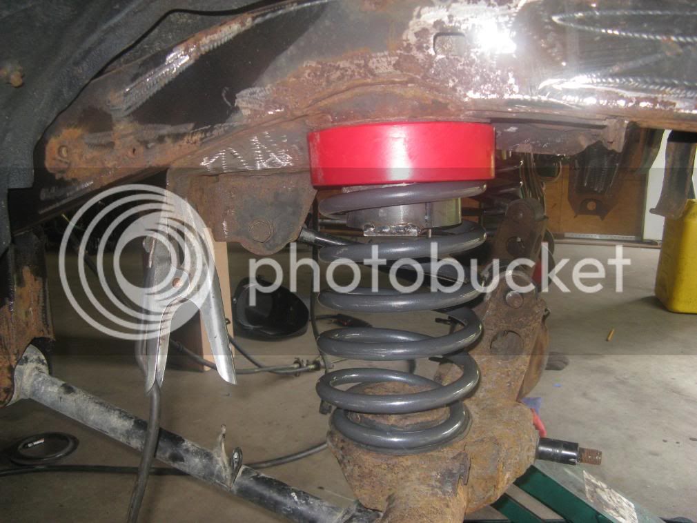

your going to like your kit. I just did the exact same kit in the front. Here's what mine ended up like.

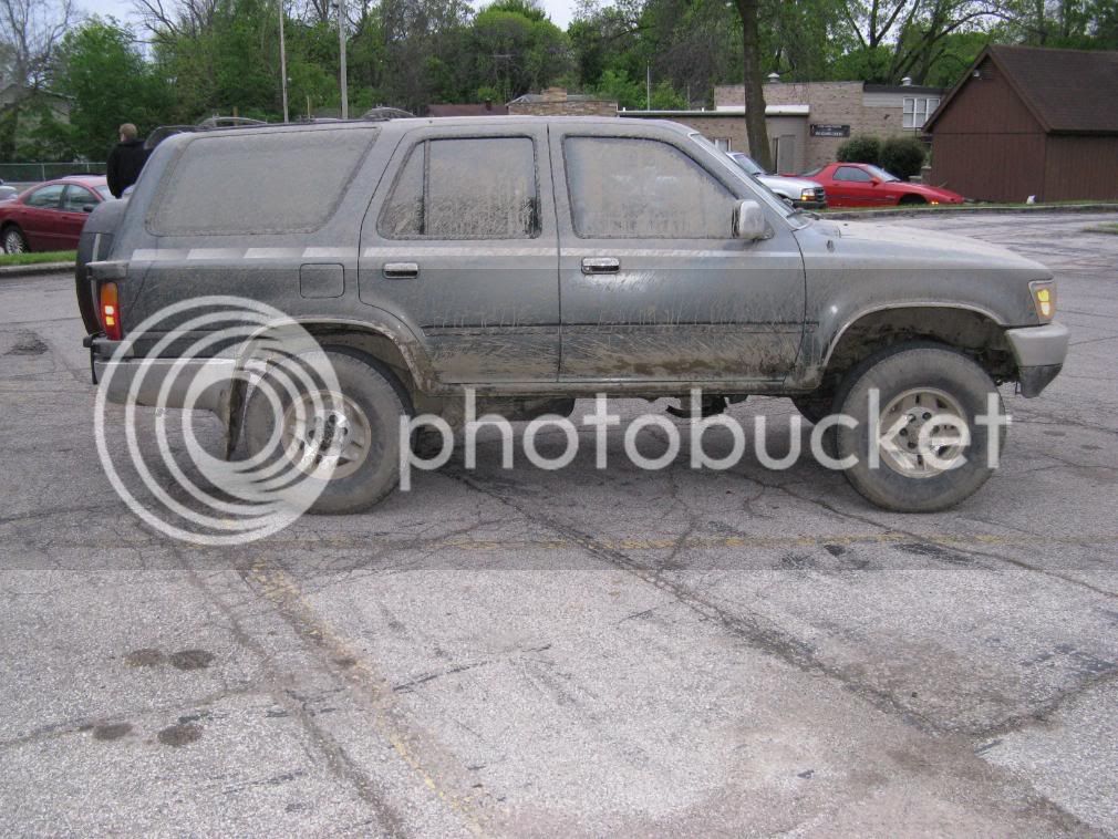

Here is my 91 runner, all stock. with about 138K on it, drives really nice.
This one i am keeping for a long time, it only gets light offroading, like the mounts 4x4 park here by flint.
I take pretty good care of it.

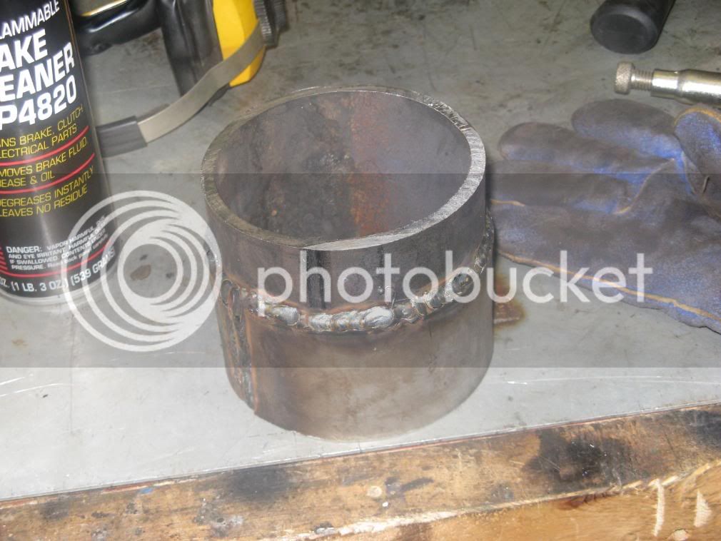

I installed a new sunroof from a junk yard, and am currently working on the rear suspension. My rear coil spring mounts were trashed, so I cut them off with a torch. There was an easier solution, but I did not think of it until after the fact.

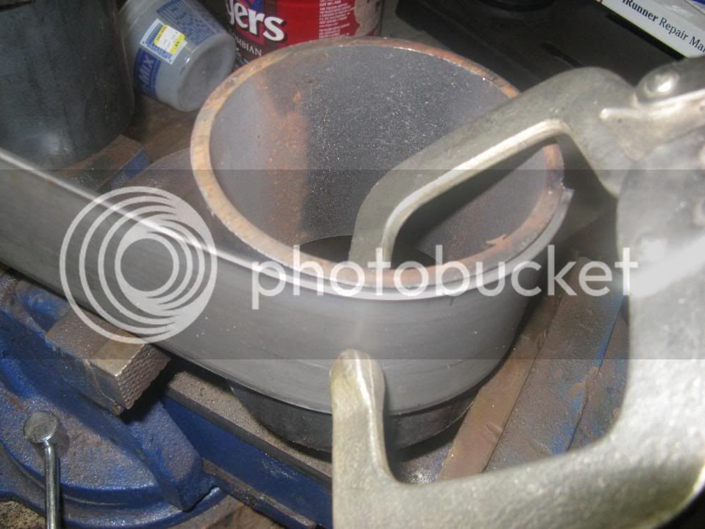

Anyways so I set out to recreate what I cut off, I determined I needed 4.75 inch O.D. pipe. Can not buy it in Ann Arbor. So I had to make it.
I started with 4.5 inch and wrapped it one revolution with 1/8 plate.
After I welded them to the chassis, upside down, with large gaps. Not fun.

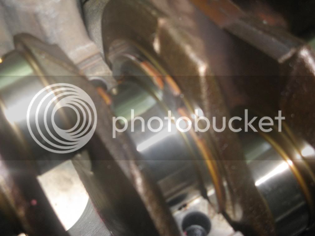

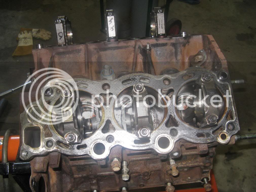

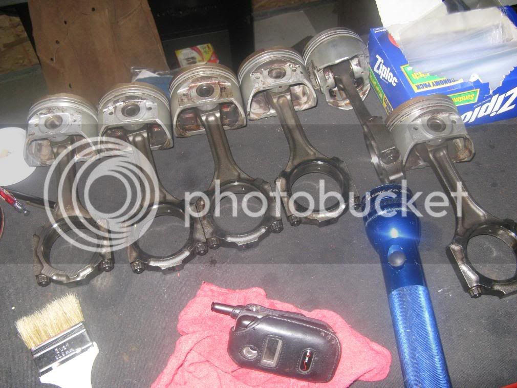

I also overhauled the engine.
Oops, put them in the wrong way!!

I do like my spring mounts alot, I dont see them breaking. Engine rebuild went well, but i am still trying to track down some of those funky pre bent hoses that run along the firewall.

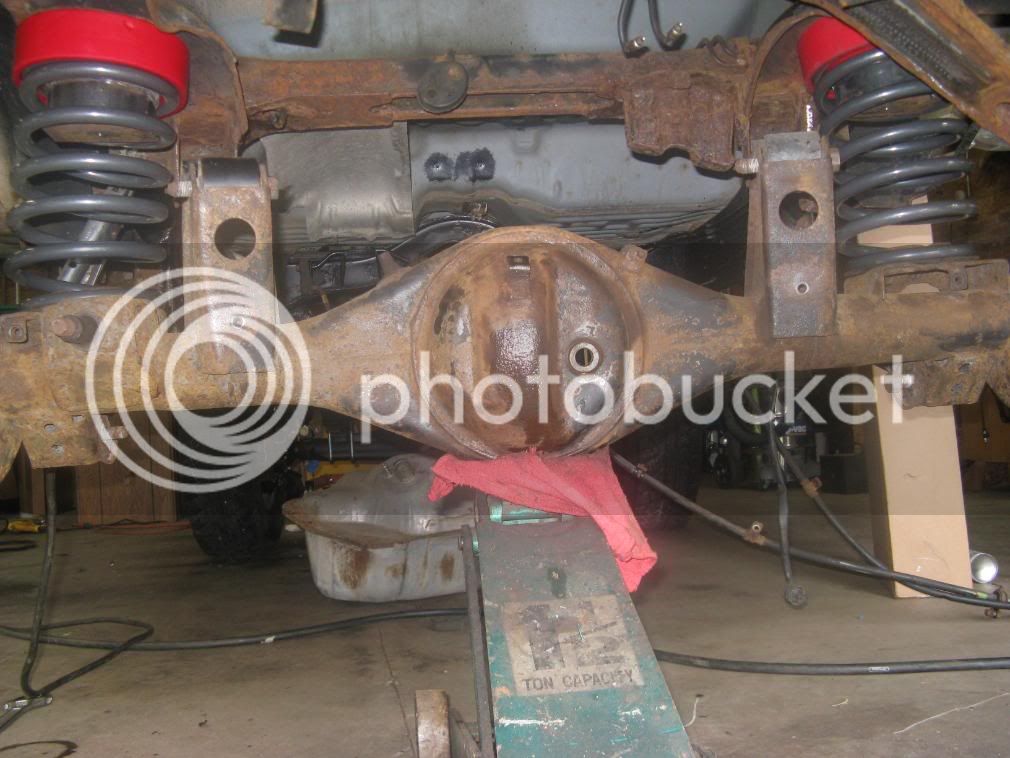

well back at it again.
Currently it sits on all fours, but there is just one little problem.
The front is about 5 inches taller than the rear. I have no expernce with leaf springs, but something tells me they are not going to settle that much.
All in all while finishing up the nic nacs the trail gear kit has been a dissappointment.
Brake lines have been hard to make work espically.
anyone got any ideas on how to fix my lift, other than removing a few leafs from the springs?
