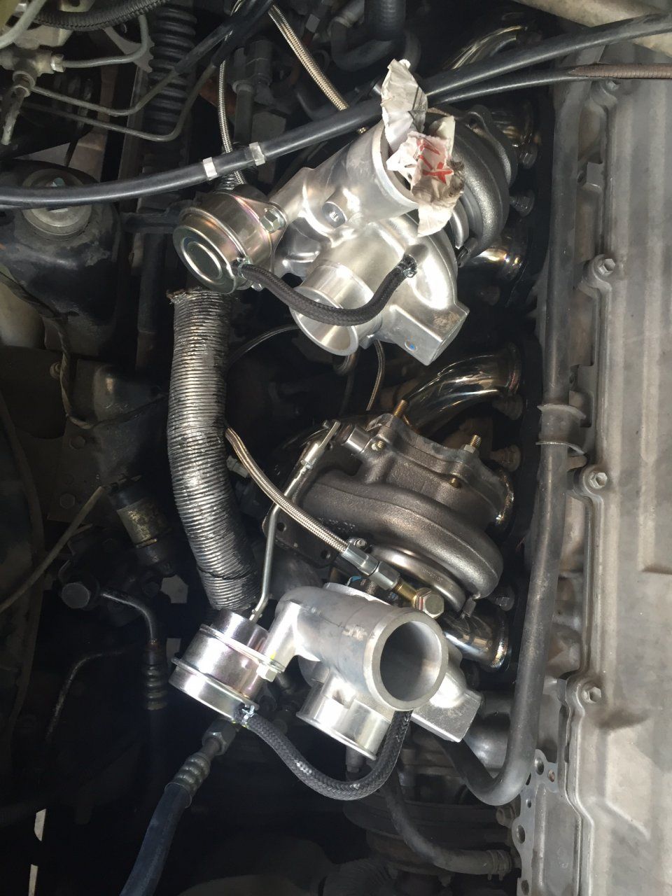

Twin turbo being installed
YES! Wow, looks like the downpipes are gonna be a chore

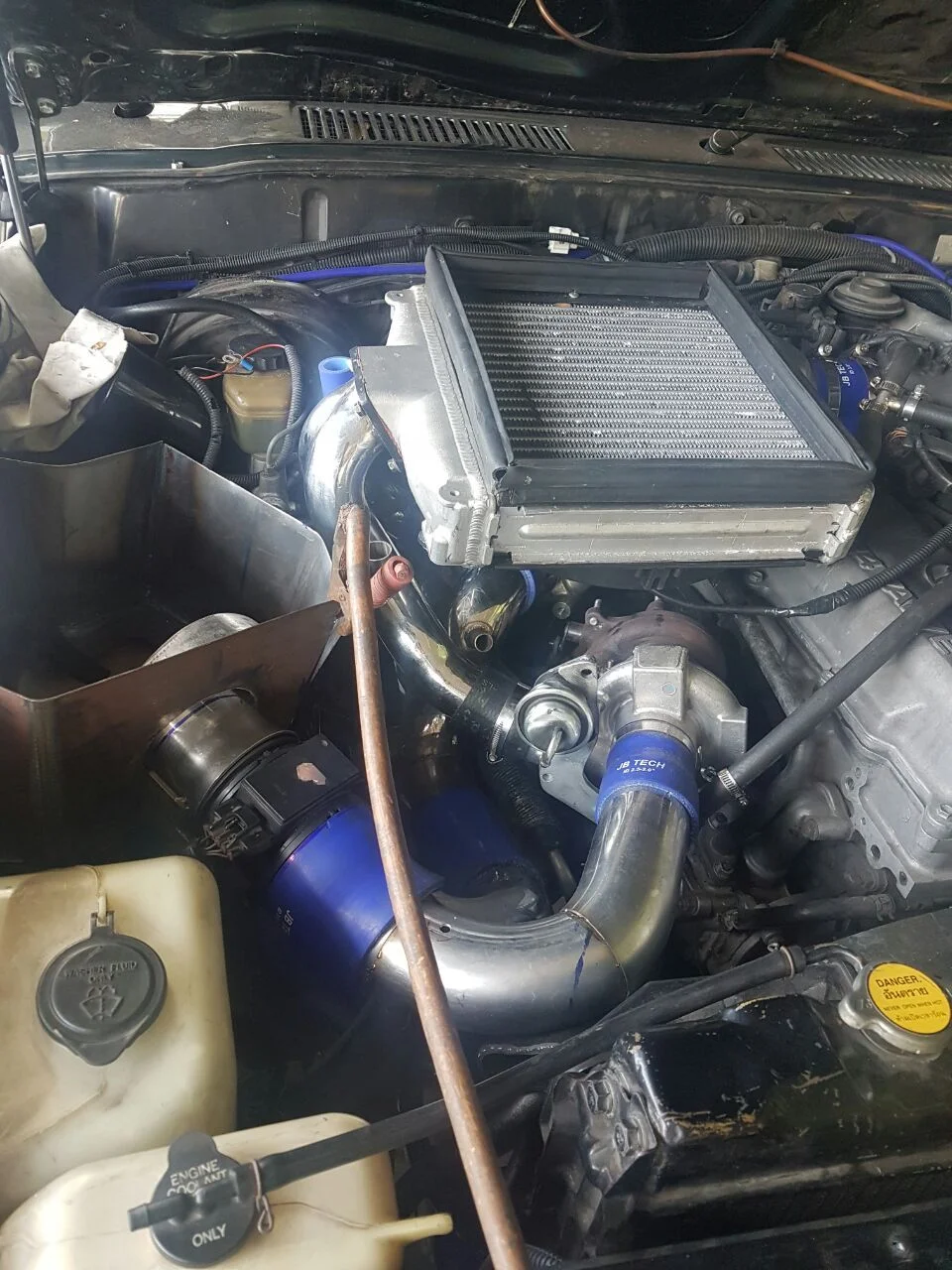

I got a custom build manifold and down pipe. A custom exhaust. All stainless steel. I installed a top mount inter cooler. No mods to ecu and the injectors.
Top mount inter cooler is not a good idea in Thailand as the temperature goes to 38dec C. I did install a 12' fan to suck air. It does help but not much.
