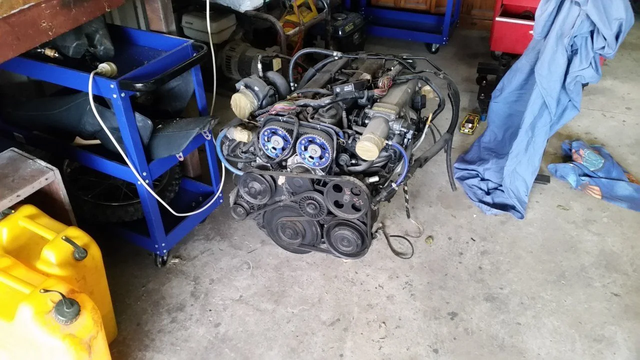

Im just about to embark on the fun task of fitting a 1jzgte into my 93 lux after many hours of research i think im finally ready to get it done,
Details of the engine:
1jzgte from a mk3 factory r154 supra, big single turbo converted

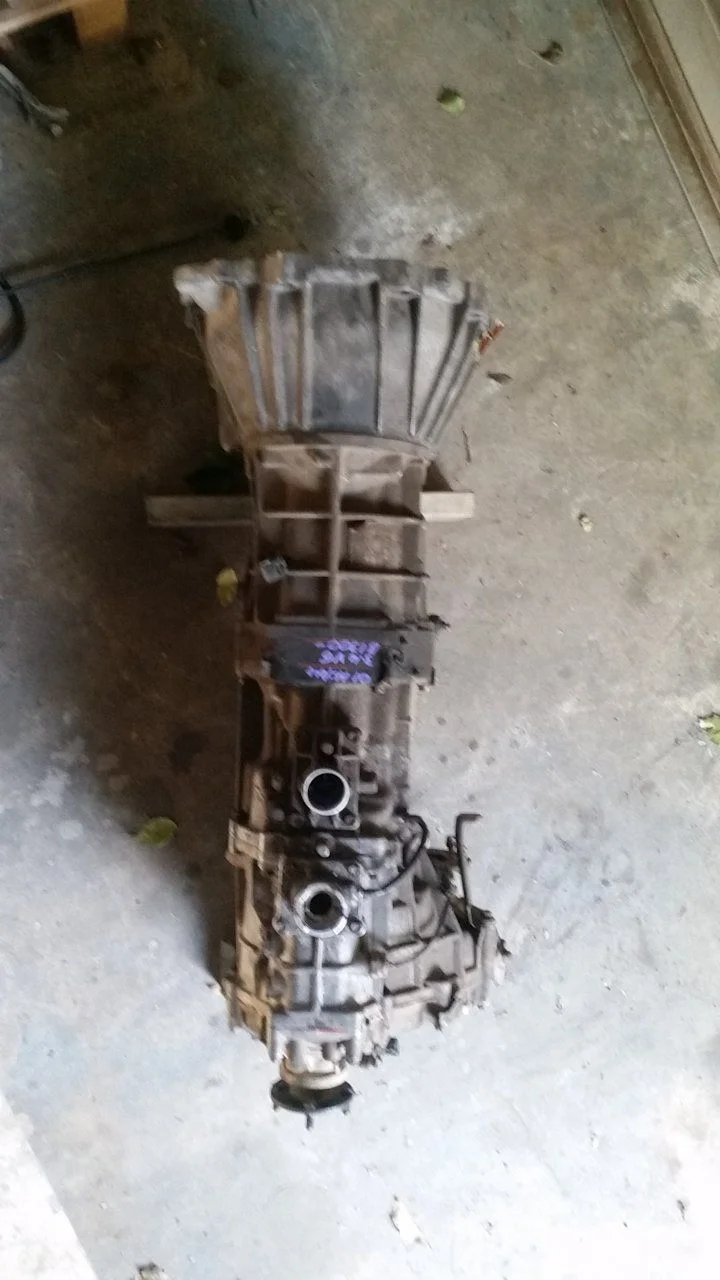

I pick up the gearbox in a few days and ive found a way around the input shaft issue, ive found a r150f box from a 5vz-fe (long input shaft) that has drivers side drop *passengers drop if your state side
So theoretically the motor and box should bolt together no issues using the r154 bellhousing i have already yay for no ax15 jeep crap!

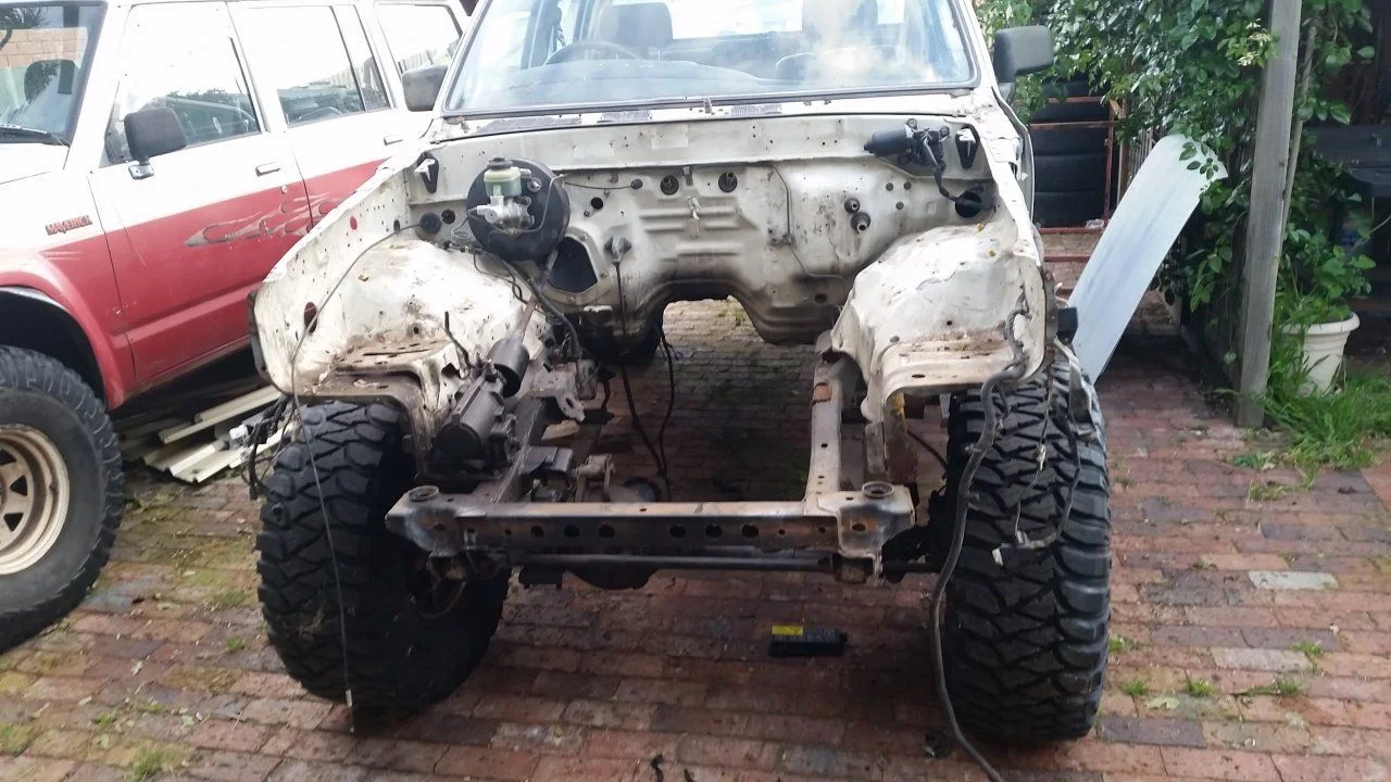

Ok well, it begins the engine bay is stripped out and ready for the motor and box to go in for first fit up and fabricate mounts then it will all come out engine bay respray and tidy up before final refit, also found an interesting gearbox for people struggling with the input shaft problem!

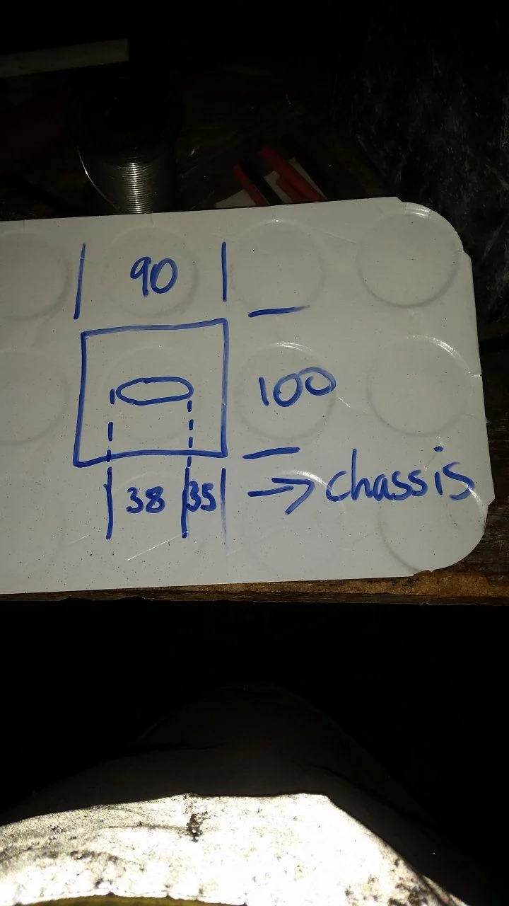

So today i made the engine mounts and its ready to go back in after i move some bits and peices around, using the 2001 gearbox crossmember and gearbox mount, it does have to move back about 25mm
Ive included a photo of the measurements for the mounting plates for the engine mounts, add 2 gussets the shape in the second photo per mount the hole size is 13mm, this has enabled me to use the factory jza70 supra engine mount and rubbers, enjoy! More updates soon
