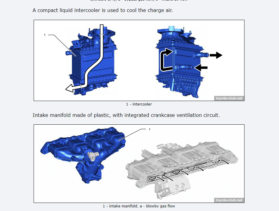

I believe the new 2.4T does not have an EGR system. Toyota was able to pass emissions without it. That should eliminate 99% of the intake carbon buildup issues. Big win for intake valves and engine longevity in general to eliminate the entire EGR system.
D4S has been covered in other comments, but it's a great solution to that issue on direct injected engines.

I don't see an actual EGR system on either of those engines (I skimmed it, so could have missed). They both have a PCV system, which is required on all ICE vehicles. The PCV system is where most of the intake problems really start - the sticky, oily crankcase vapors getting sucked into the intake stream which dirt then sticks to. That's not much of a problem with the port injection of D4S to wash the oil away.
From what I have seen, the turbo on the I4 is easy to get to, not so much on v6.
I was going to say the same as @Jeremy556 - PCV is a different system from EGR.
However, a PCV can double as an EGR if you have enough blow by on the piston rings. :) As a powerstroke owner.
