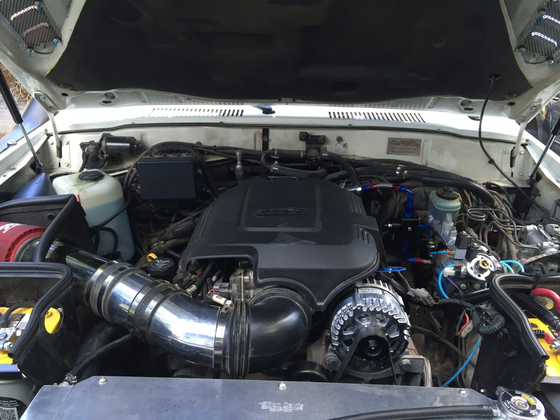

A few years ago, I had a 2009 DBW, 5.3L LY5 with 4L80E transmission swapped into my 97 LC. My first radiator and electric fan choices were failures. The LC would overheat while in 4 low during a long ascent. I changed my radiator to a Ron Davis with dual SPAL fans and have not been above 212 degrees since. My LC weighs about 7500 lbs fully loaded. I am a believer in the Ron Davis solution. I have not tried to tow anything off road yet and probably never will. I thought you'd like to hear about a positive electrical fan/radiator experience. I also added a 270 amp alternator.
Well done. I would have run a dual SPAL set up as well if I was not towing. Very nice setup.
