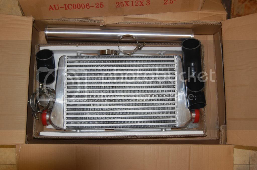

Just ordered my intercooler and piping, $44 for shipping caught me off guard though.
A list of parts required for my IC kit, keep in mind that the core support of the FJ62 is different than that of the FJ60. A 31 inch IC would get in the way of the headlight and grill mounts, so I ordered a 25" bar and plate from cxracing.
Front Mount Intercooler 25"x12"x3", 3" Core: 18"x12"x3", 2.5" Inlet & Outlet 2.5" 90 Degree Turbo Intercooler Black Silicon Hose Coupler 2.5" Long 2
2.5" 45 degree Black Eblow Silicon hose 1
2.5" OD Universal Straight Aluminum Pipe, 2mm Thick Tube, 24" in Length 2
2.5" Straight black Silicon hose for Turbo Intercooler pipe 7.5" Long 1
2.5" T-bolt clamp Supercharger Turbo Intercooler exhaust 6

Got my IC and parts in today, heading over to get to work!
