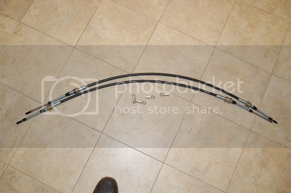

Twin Stick Parts
I don't know why, but for some reason I'm super excited about running a twin stick set up. Happy New Year!!!!

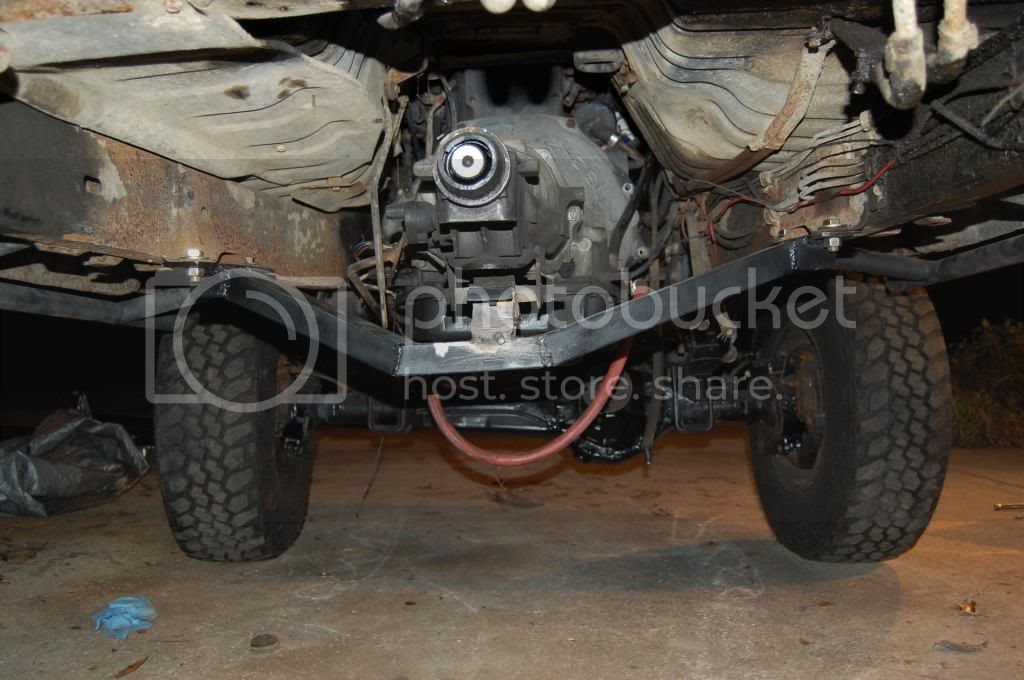

Stevo, you asked previously about my tie rod/oil pan clearance. It's about 2.5 inches directly underneath, and allows for about 6 inches of articulation on the passenger side wheel before contact.
