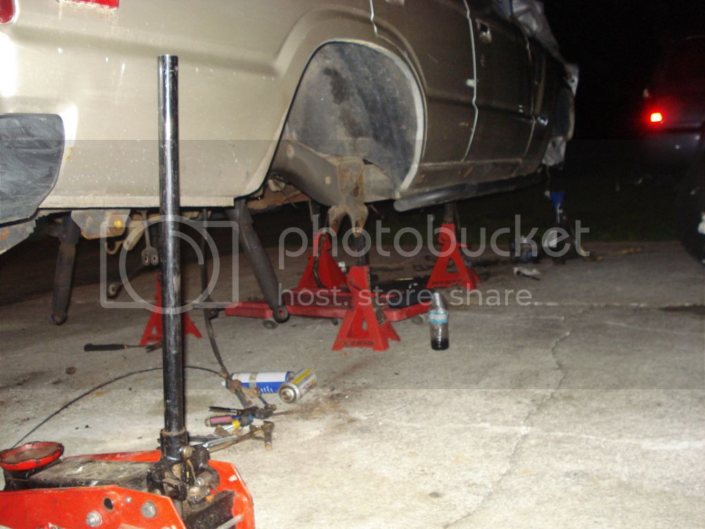

Well, progress has been slow, but I've got the motor and trans out, and have the front axle sprung over and back in. The rear has to be converted to center diff from offset diff to work with the dodge trans, I think the angle would be too much of a bind for the u-joints to handle.
Yay for Oxy-Acetyline torches!!! The motor must come out!!!
No more axles! Be sure your jacks are in the proper position, because when you remove the engine the front end gets REALLY light, and sometimes the truck will "wheelie" so it's sitting on its bumper!!

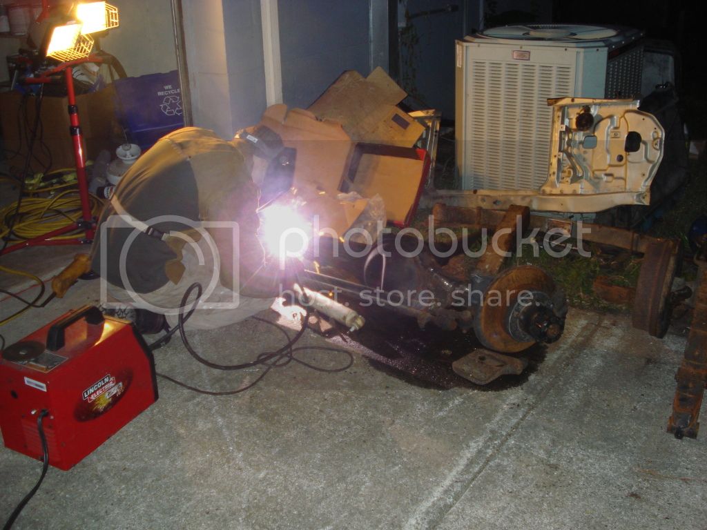

Working on the axles

Got to work on the truck for about an hour today, pulled apart the rear axle for the 3.73 swap, thanks to mel lowe.
When I pulled the cover I heard the "tink" of something metal moving in the diff, and wondered what it could be.
WHAT IN THE WORLD WAS IT DOING IN THERE?!?!?!?
Thankfully there's no damage at all, but I can't think for the life of me why it was in there. Those gears sheared it in half without a problem though!!
