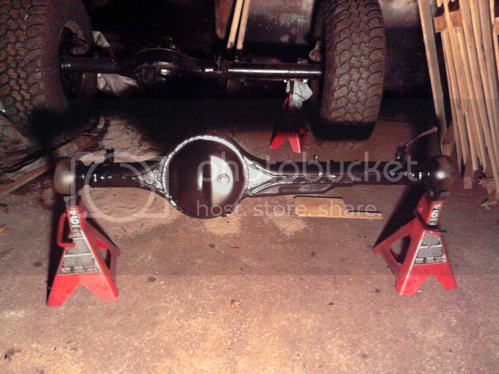

Got the front axle down to the metal, primed and painted. Putting it back together, then painting the leaf springs and mounting it back under the truck.
Slow going, but once this is done I can pull the 6BT and A518 and work on mounting them.

So far I've got 3.70 gears in the diff's (thanks to snowboardonsnow), fully rebuilt knuckles, SOA completed, Hi steer kit installed, and every thing but the rear leaf springs and frame ground to the bare metal and primed/painted.

As of tonight she sits on her own axles again, after a few months of being on jack stands.

Rear axle painted.
Standing on its own again.

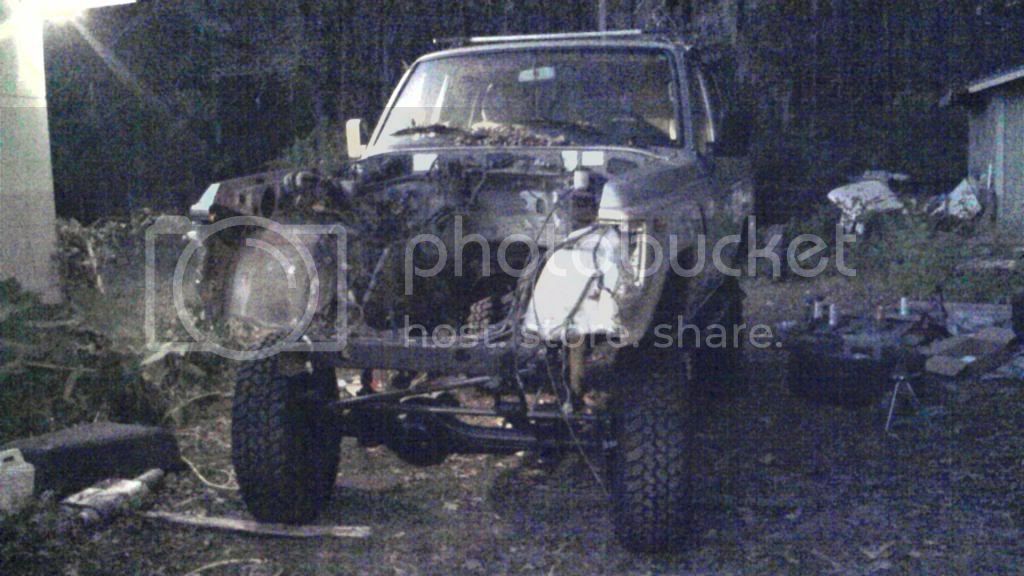

Update for Nov 28, 2012

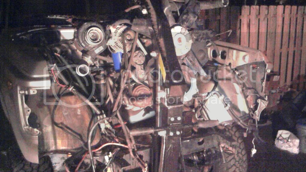

Just got done wedging the 6bt in between the frame rails of the FJ. It's starting to look BEAUTIFUL!!!! It was really nice to feel like I had a productive night of work again.
SOOOO BIG!!
Ready for the transplant to begin.
As you can see in the first pic the oil pan was pretty rusty, so I wire wheeled it clean and sprayed it down with two coats of Dupli-color iron gray engine enamel.
I kept asking myself how it was going to fit!
Now it's a battle of getting the motor lined up straight front to back, side to side, and leveled as well. Does anyone have some tips for effective ways to do this? I of course want everything to be lined up as much as possible.
I've thought of using a measuring tape for ensuring equal distances, a level to make sure the motor is level, but I'm wondering the best way to make sure that it's lined up front to back? Maybe lining the tail-housing up with the reese hitch out the back somehow?
I'll have to lower the motor a little to make it fit under the hood. I had to turn the turbo exit up to clear the frame/fender.
I've got enough clearance right now to lower the motor a little to get it to get snug up in there. Just a little wiggling and shifting it around it seems.
Still needs to go back a few inches, but it's getting tight in that back of the engine compartment.
Heater hoses that are touching the exhaust manifolds, so I'll have to work out something different.

First you might need to cut those frame gussets in the front to make room for the motor.
Either that or remove the AC compressor altogether.
I was thinking about cutting the gussets, but I don't want to sacrifice strength or safety, so if I did I'd have to come up with another gusset that worked with the fit. Not getting rid of the A/C compressor, I like the A/C when it's hot down here. The thing is, I have a few inches to go back, so I think it'll fit fine without cutting. Also, I need to make sure it's far enough back to fit the fan, radiator, intercooler, trans cooler.

Stevo, how'd you get your motor lined up and leveled?
Not a lot. Occasional trail riding will probably be the most. I'd love to have it tough enough to handle a mild trail once in a while.
If you pop over to my build you will see the motor crossmember I modified to line the motor up within the framerails.
Then to get it parallel to the frame I set that when I made the crossmember for the transmission.
I just used a tape measure. And some magnetic angle finders for the motor.
The cummins motor is ok with 13 degrees of angle side to side and 8 degrees front to back.

Some one out there makes a bracket to move the ac compressor up and out of the way. I've seen it on 4bt swap.com. Let me see if i can dig it up.
