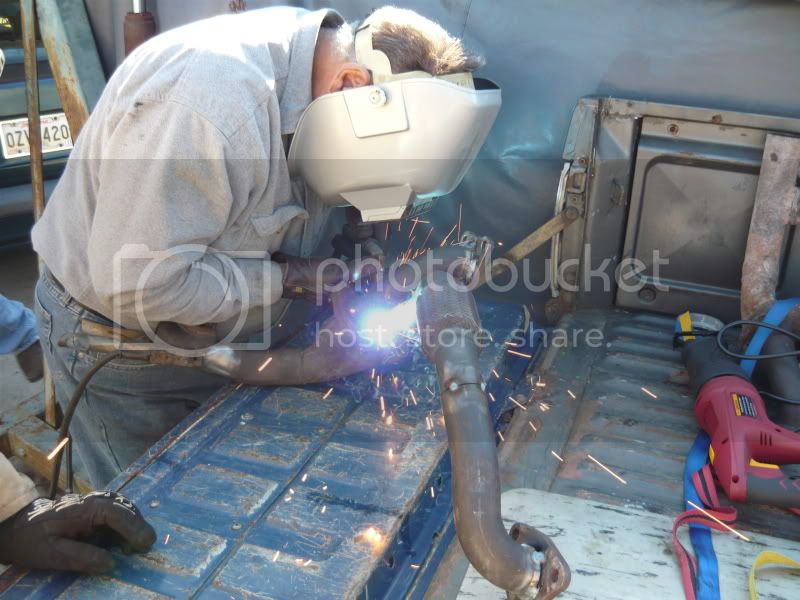

Well it looks like I am a little ahead of schedule with the motor maintence. :clap: Changed the timing belt, valve cover gaskets, rear cam seals, plugs, wires, termostat and alot of cleaning. Installed the 97 wiring harness on the 95 T100 motor along with the 97 intakes and valve covers. Swapped a 3.0L water neck along with 3.0 motor mount brackets. Followed the previous mentioned thread about the crossover exhaust mod, and Mr. Paul stuck it all together for me while I broke some of his tools.:ban:Not sure yet but we might try to swap the engines on Saturday down in Franklin while the shop is closed for the weekend. Those that might want to help stay tuned and I will relay info as soon as we get the OK. More pics follow the link.

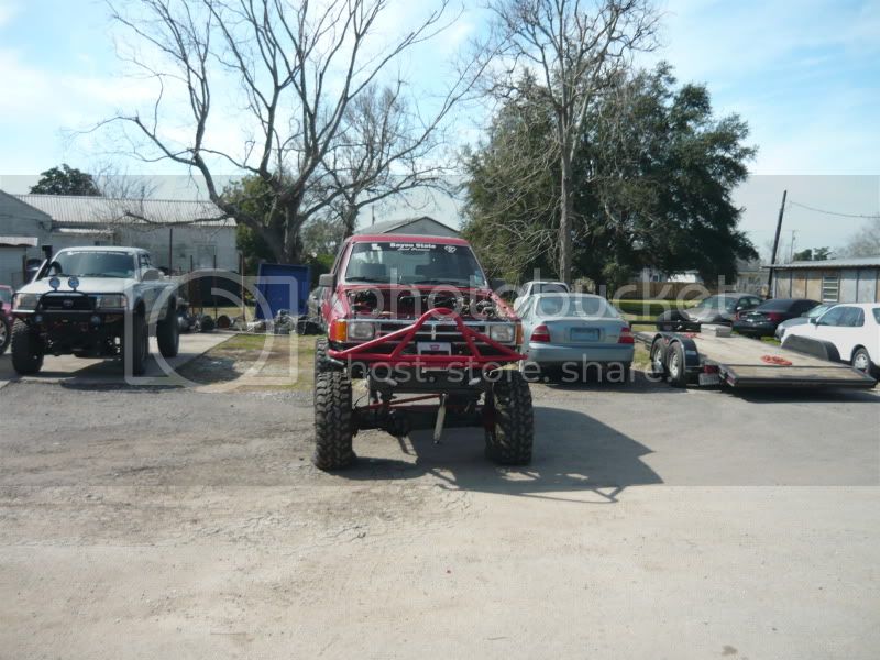

Well we got the ok to use the shop Saturday so those that want to help or watch leaving Lafayette early Saturday return is unknown. The address is: 1515 Main St, Franklin, La.

Started around 8:30 am and by noon the engine and trans was seperated in the bed of the truck. Took a lunch break before final prep of motor to begin install. Discovered a hole in the new transmission pan had to weld in a plug, , grind smooth, clean, and paint. Sealed up the pan reinstalled and mated it to the 3.4, found that the trans harness travels very close to the new exhaust crossover. Wrapped the exhaust with some heat wrap, covered the wire loom with heater hose and also some wrap for add protection. Lifted the assembly as high as we colud and started dropping the new powerplant in with two guys standing on the tail end one operating the hoist and I was underneath guiding what I could into the tight fit. Motor mounts tight and trans held up by a ratchet strap we started connecting what we could around 5 pm. We pulled a vacum on the AC and seems to hold well. My buddy showed up with some beers and the BS started until it was on the trailer and headed home. Still have the wiring, T-case, belts, radiator, and shifter before we are mobile again. But all this was alot easier with the help of my local club members Mike and Dan, along with Kyle and his brother's shop, Thanks guys.
