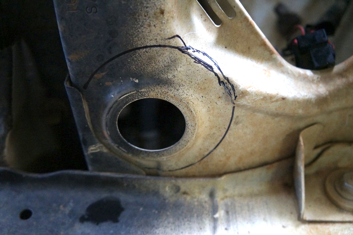

Here's max stuff driver side and max droop passenger side.
The droop is best MAX guestimate. I measured the distance from the frame up to match the shock towers. I doubt it ever goes that far. If it does it should still clear though.
I had to trim sheet metal to make room for 37's. I can trim more up front if ever needed but not so easy if it hits the firewall.
So opinions welcome.
Here's the reality. Once I position it where I want it, that's where it will stay.
Even though I have some adjustment available, there is VERY little room around the frame side panhard bracket to shift anything. Once it's welded on its a big deal to move it. I would also have to enlarge the notch in the passenger frame rail. (Which I haven't cut yet) I need to get this right the first time, or VERY close at least.
I had to cut the tack welds and move the upper link axle housing bracket a little. It was too close to the panhard bar. I'll need to shift the rear upper link bracket a bit as well. Getting down to the fine details now.

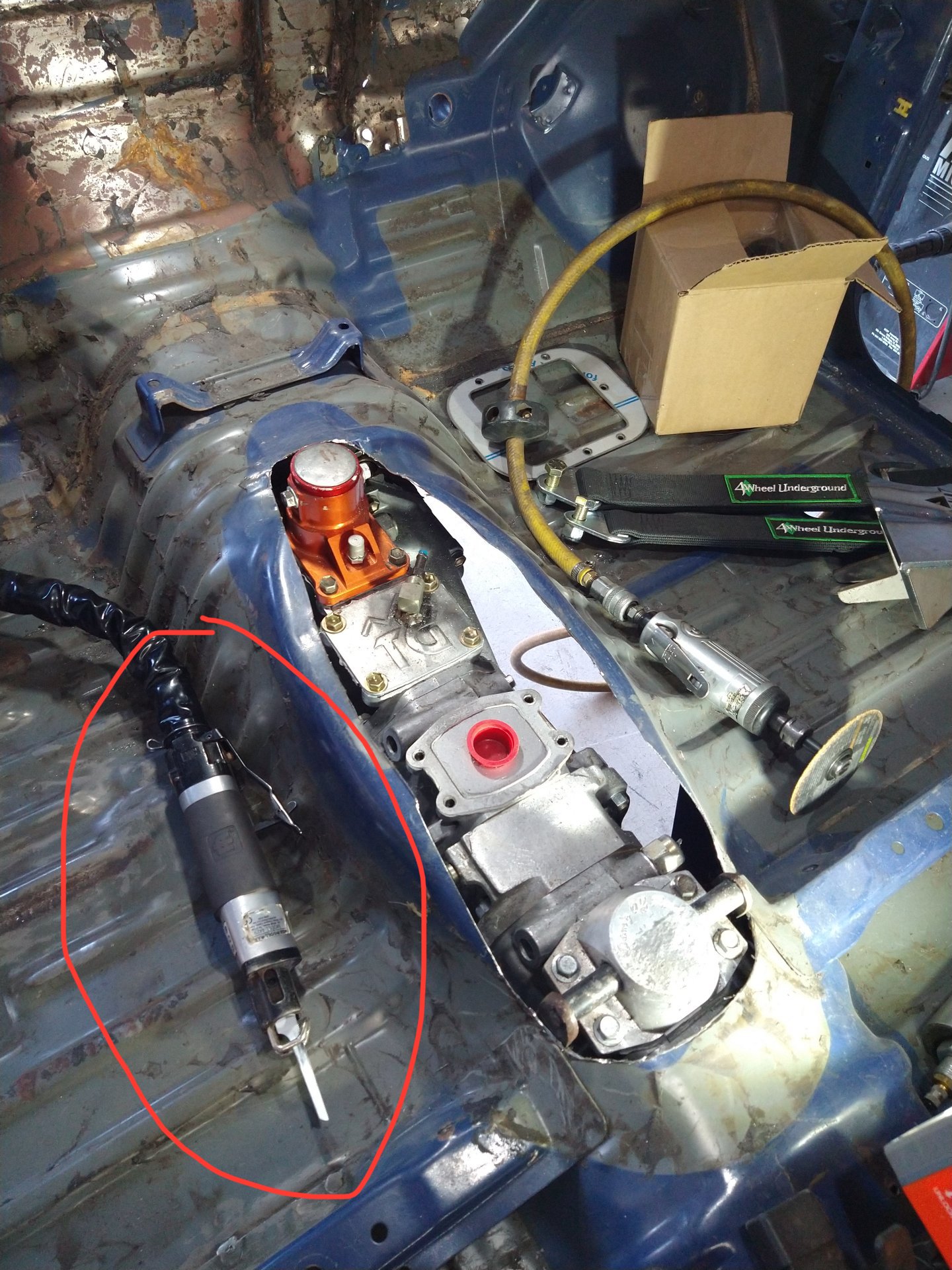

Dumb question - What is the name of this tool? It looks like an air powered reciprocating saw. Does it work well for precisely cutting sheet metal free hand?
Yep, it's an air saw. Harbor Freight sells cheap ones that work pretty well. This one is an Ingersoll Rand I bought years ago.
It's great for dash work and sheet metal. I found that I could cut out custom blades from my old hacksaw blades.
Edit: Will, I don't know how "precise" you want to be. It can be fairly precise in some cases. In some difficult to reach spots or on contoured surfaces it is sometimes tough to get a precise cut so I cut close and trim with a die grinder or similar tool.
I call it a body saw.
I need to make a tight radius cut for intercooler piping. Not sure if a body saw is the best option.
Probably not the best tool option for that unless you get close and finish to size with something else.
I agree. I routinely bend the blades if I try to cut anything that tight.
10-4. Is there a better tool for a precision cut?
for intercooler piping or any pass through, I use a hole saw. In the picture you posted above where there is already a hole where your pilot bit would go, I weld a piece of scrap in place to cover the hole. Thicker steel is better for larger hole saws. Then clean the edges up with a sanding drum in a die grinder.
