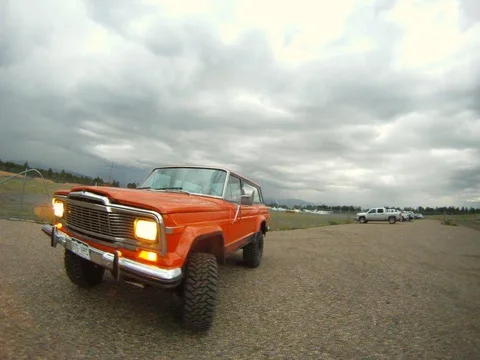

This truck is way cool. Just like the owners.
Thanks for keeping it going. I have always thought these were awesome rigs.
BRAVO!!!
new Wilderness rack, looks a bit wide to me.
My first ride was a 1978 Cherokee Chief S, I bought it when i was 15 and built it with my dad.. Good learning experience for me (Since almost everything blew up on it.) I got to learn how to rebuild everything, made me into who I am today.. LOVED my Chief, I sold it when I was 18 and was heading to college due to the whole "This is not the time to have a project" not happy with the perfect VW I bought... although the car ran amazing it wasn't what I wanted and didn't really fit my lifestyle. Sold that and bought back a FJ60 that was in the family for a long time from a close friend.. Im so in love with my 60.. but I always wonder what it would of been like to keep my Chief.
Rant over.
Love the Wagoneer!
