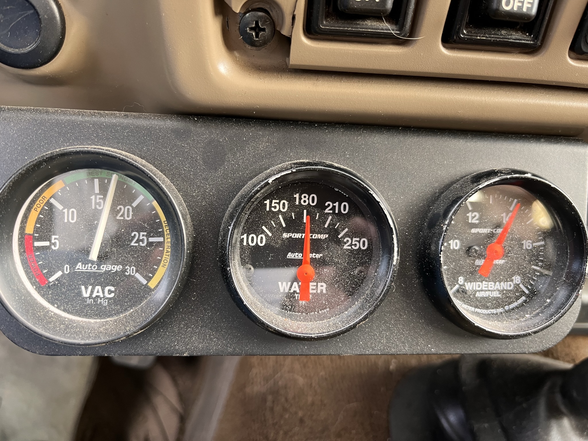

Here’s what I run:
Autometer Sport Comp water temp gauge, electronic sender
The sender is in the upper radiator hose. I use this adapter by Glowshift. Cut the upper radiator hose in half and shorten one end by about 1”. Stick the Glowshift piece in there and thread the sender into it.
Takes probably 90 minutes to install everything. Super easy. Pass a wire through a firewall grommet. Screw a bracket under the dash. Done. Obviously you don’t have to install all the other gauges I have…

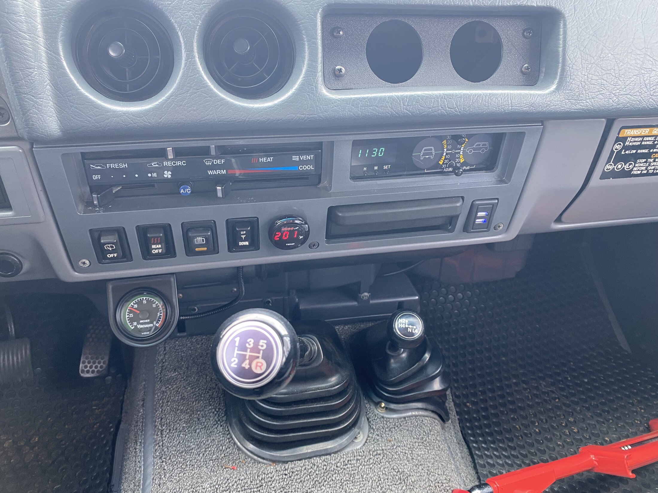

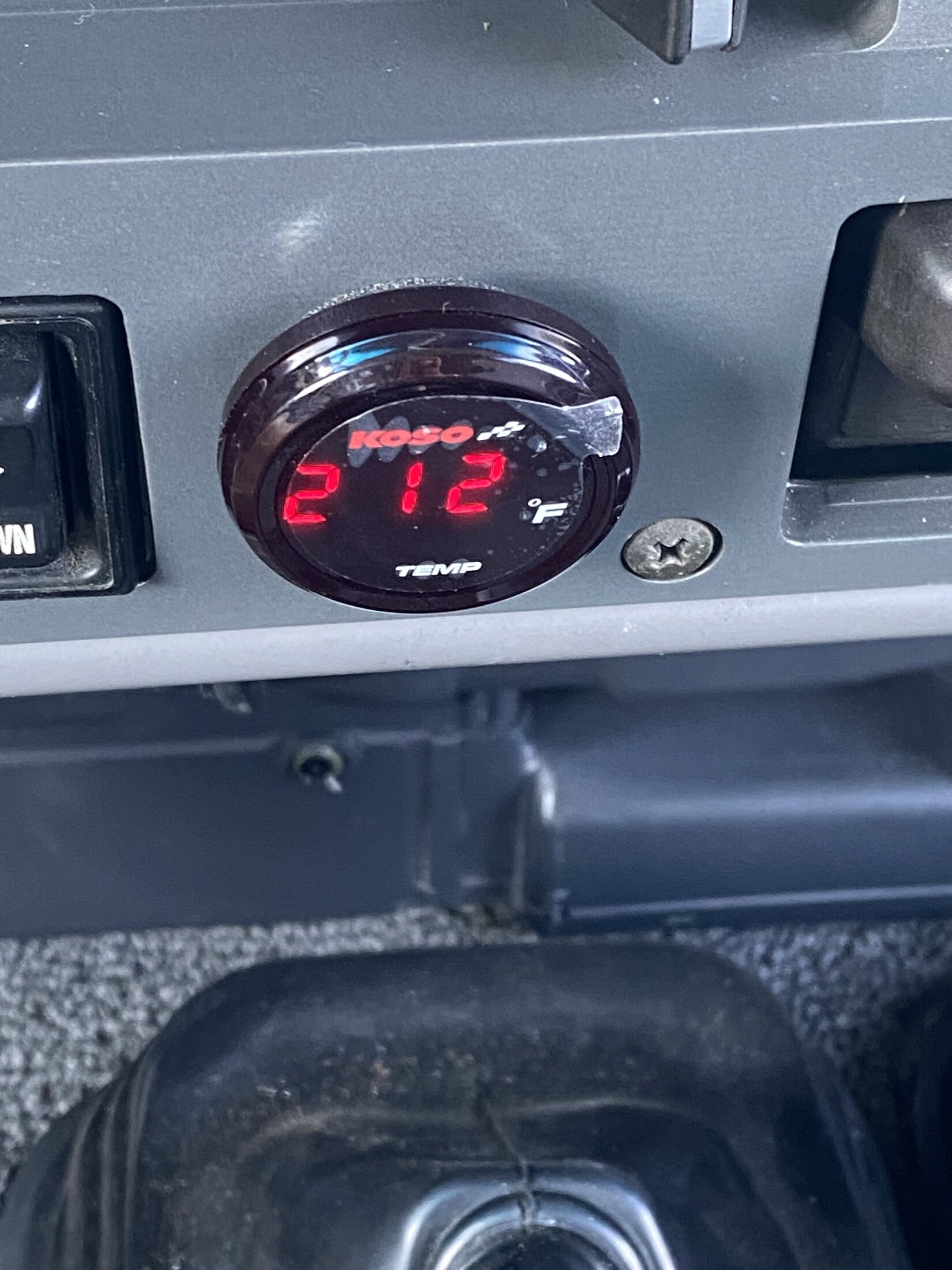

I have an '85 FJ60 also and recently refreshed my coolant system for exact same issues. My stock temp gauge did the usual spike towards high but normal temps via my IR gun. I had changed the water temp sending unit, water pump, and have a HD fan clutch as well. Radiator has no leaks. Because of the stock temp gauge always showing 'elevated' temperature but normal temps with the IR fun, I put in a Koso unit (got idea from @HemiAlex) and its probe is in the BVSV port location. Perfect location for the cig lighter location using the awesome @TRAIL TAILOR bezel (which will likely last well after the rig has decayed lol).
Due to location BVSV probably gets the highest readings and the highest I’ve got was 212 (during summer) but even then with use of IR gun the rest of the engine and the rad hose was never above 200. The 212 was after 30 min highway run at 70 and then idle. Temp dropped to 190 after 1-2 minutes. Can also consider upper rad hose if you go similar route.

I liked the Koso unit and my bezel finally cracked fully at same time - since I had the TT bezel (the bezel doesn't work with a functional cig lighter) - it just made sense for my situation. I am desmogged so my BVSV port was available. You do need to get an adapter due to different threads (BPT vs NPT).
