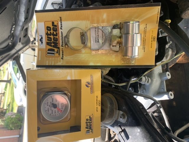

I know I've seen external gauges installed and spoken about, but cant seen to find them.
I though @OSS posted about them......Im looking for a gauge to double check and verify water temps while in use....
Get a good gauge. Autometer or better.
I found the usual radiator adapters are too long for the short curve of the FJ60 hose and push it into the PS Reservoir so I found this one:

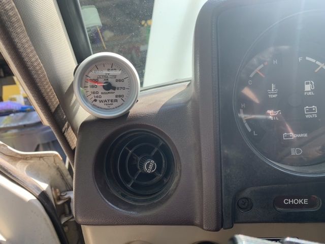

I have an Autometer with electric sending unit mounted in one of the ports on the head. Been there for 200+k miles without any issues. I can watch the temp rise as the engine warms and tell when the t-stat is about to open. Water temp hits about 200 then drops. Good to have a second gauge to monitor engine temps because it can alert you to a false positive when the stock temp and fuel gauges spike.
If you're desmogged you can put the sensor in the lower thermostat housing for a nice clean install.

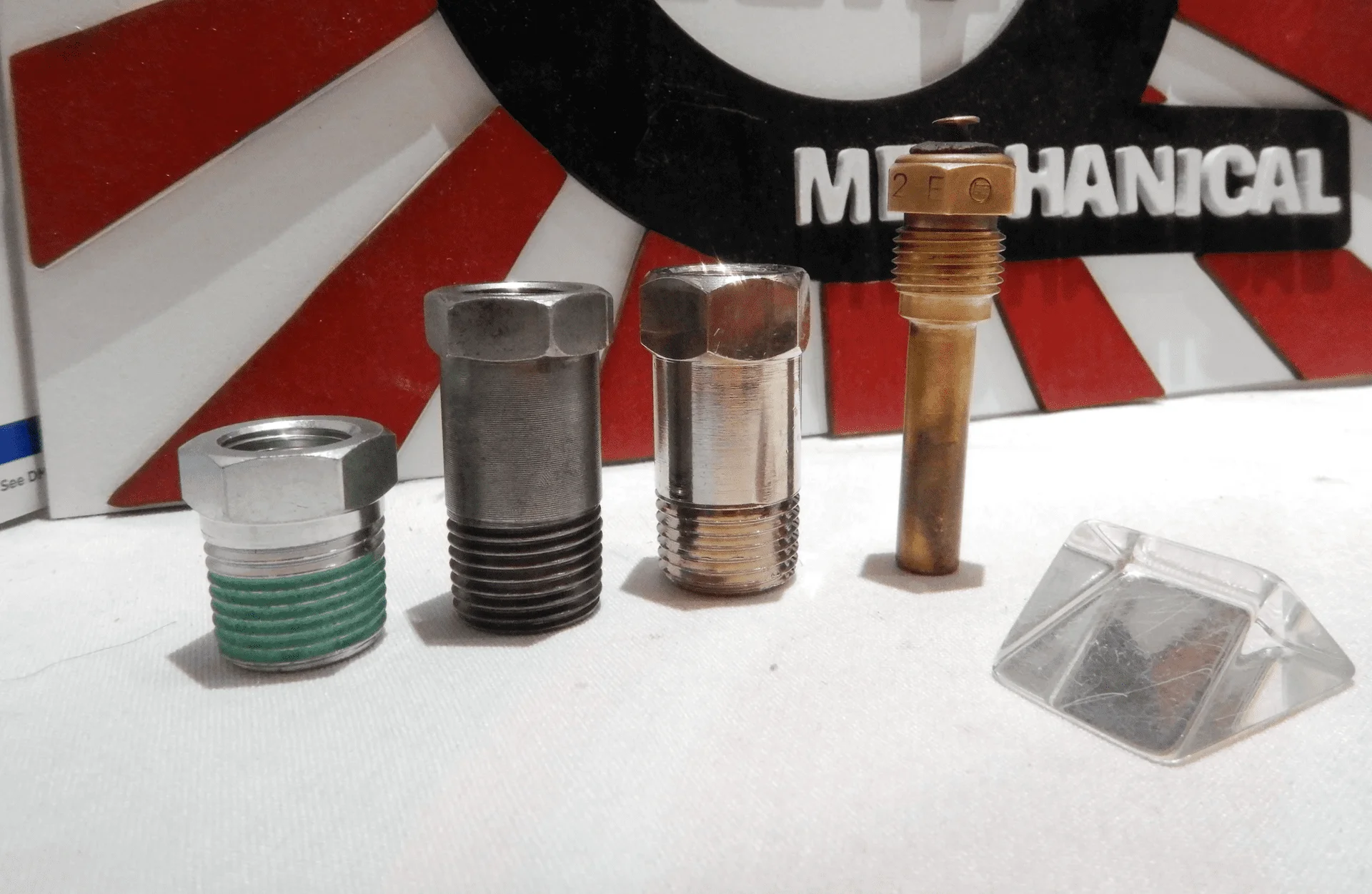

My YAZAKI brand set up came with a Longer early type sender in the kit , i had to source
a early OEM TOYOTA Tall Sensor / Sender Union to make it work ..... like 62-12/74 one
that was before i dreamed up the idea of bringing 90404-16127 back for the dead ... :D

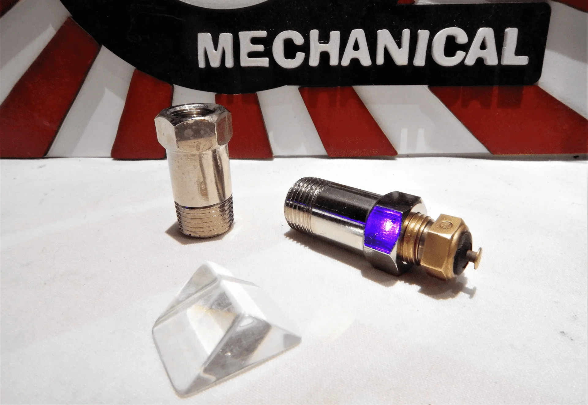

this is a very recent addition to my collection , but may help solve @dannyvp issue
or present him with additional options ?
here is 90404-16127-R :
side by side with the oem toyota 2F short sender , and a OEM original i cloned her
from . Chome Plated solid Brass .......
@dannyvp ,
if you would like to try out one of these , i will be happy to mail you one out as a professional sample , but id like to get @OSS 's take too on this topic, i know
he always has valued input
:):wrench:

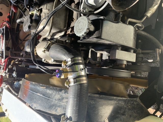

Again, I'll repeat trying to save someone from the extra expense and hassle:
If you use a MECHANICAL gauge, the sender is going to be 3/8" NPT. That's the standard size for Autometer, Glowshift, etc ...
ALL the short upper rad hose adapters are 1/8" NPT (or BSP) because they're meant for an ELECTRICAL sender. You can drill and tap yourself, if you have the correct drill and tap bits.
The only SHORT upper Rad Hose adapter I could find, in 38mm, with a 3/8" NPT is from a guy on ebay who custom makes them (linked above).
ALL the other 38mm (1.5 inch) 3/8" NPT adapters I could find are too long for the short, quick bend of the upper hose in the 60s. I used one of those for a while but cutting as much of the hose as I could still pushed it into the lip of the power steering reservoir and that caused a wear spot on the upper hose at the contact point, and had I let it go, would have ruptured the hose.
There are adapters for the heater hose, if you want to put the sender in the hose that feeds the oil cooler...

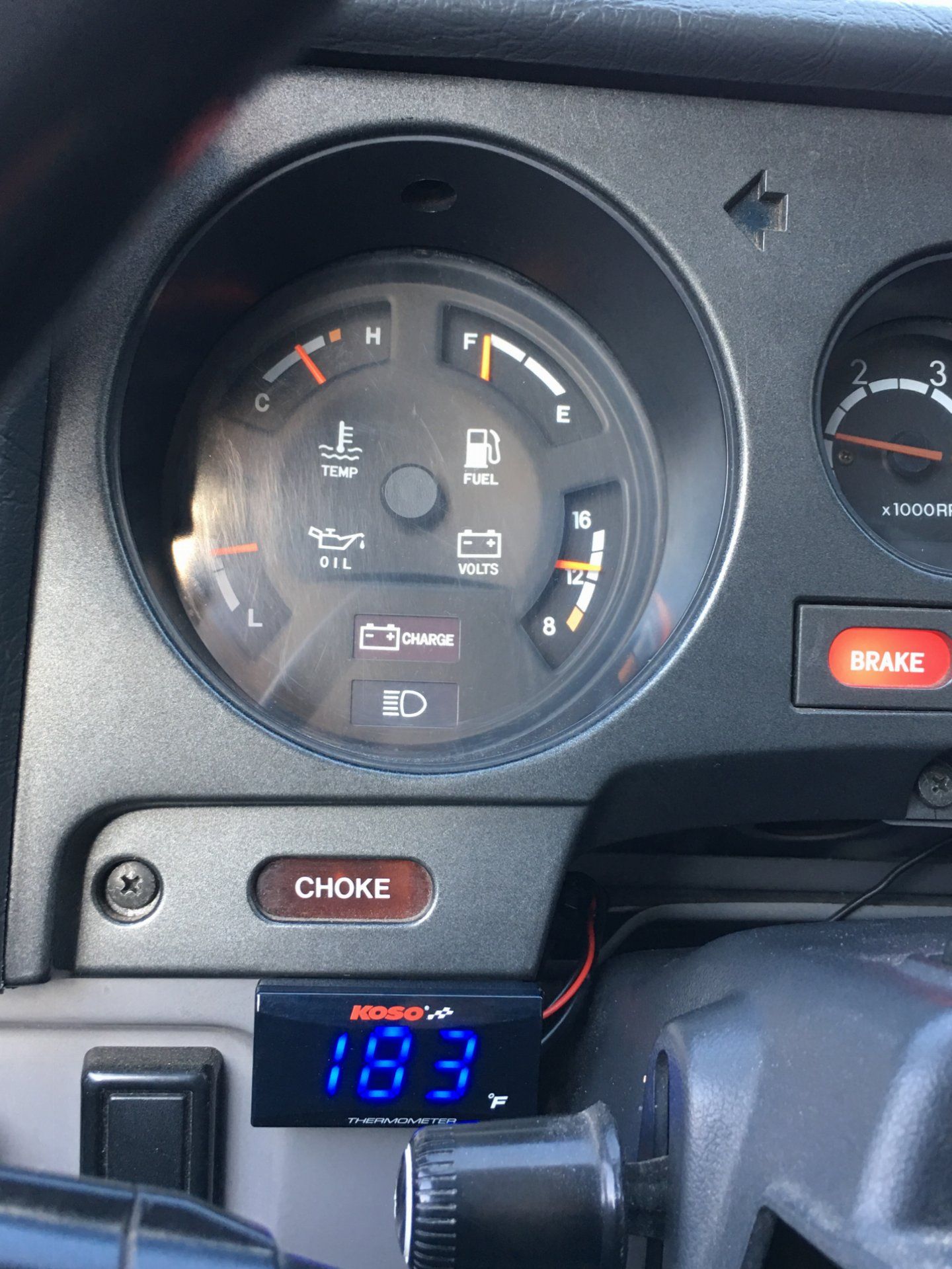

ADD: The Koso gauge co above that Alex shows, has a few different style elec thermometers that are fairly cheap and come as complete kits and very easy and quick to install. I have one on one of my 40s ... Only thing addt'l you'll need is your choice of hose adapter.
Super easy. It’s worked for me for quite a while. If I had to do it over, I would put the sensor in the upper radiator hose.
Alex, where did you pull power from? Is it ignition based? I’m to the point of needing one of these as well. I like your discrete digital display. Also like where you tied into the system on the firewall side. I don’t really want this thing hanging out of the fat top hose in front.
I did a switched on source atc add a fuse. No issues at all.
