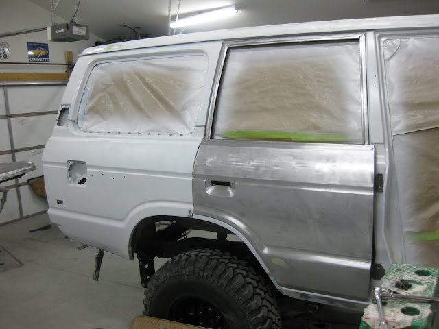

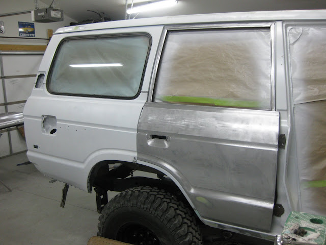

After test fitting, checking, tweaking, checking, test fitting, hanging the rear door, looking at it 6000 times, checking, tweaking, and then looking at it some more, I think it's finally ready to be welded in. Take a look & let me know what you think.
No glass:
Glass (I really dig the way the de-chrome is looking):

I'm going with the factory 033 white for the body & then blacking out everything else. I made a pile last night of everything that needs to go to the powdercoater or get painted (bumpers, grill, bezel, handles, rear trim, fender vents, quarter vents, etc.).
My bumpers have a couple small dents in them now, I'm leaning towards painting them and then coming back later to build custom tube bumpers (put my tube bender & brake to work). All depends on how much they want to powdercoat the bumpers.
As for tint, I've considered it, but I really dig how the cruiser looks with clear glass in it. Dunno yet though, I may change my mind as it's all coming back together.

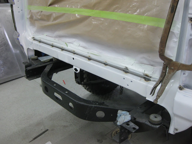

The RR 1/4 is completely welded in now;
I welded in a new weatherstrip flange at the hatch opening (the old one was destroyed by the rust):

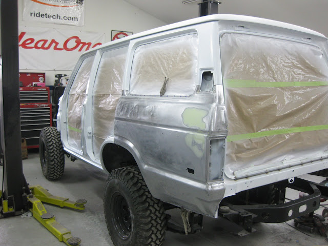

The LR 1/4 is ready to be welded in. Fixed the dent that Greyhound so graciously gave me. . .

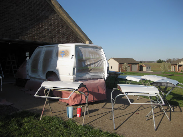

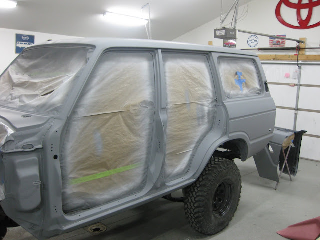

BIG day, BIG update - - - She's in primer. . . (FYI, these pics are proof of why a home in a non-HOA neighborhood is important :D)

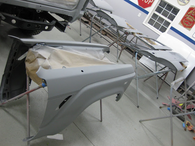

Shot all the bare metal parts with epoxy & then put a 2nd coat of epoxy on everything else.

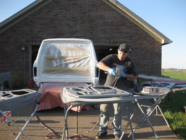

My wife got this shot; I look pretty serious for shooting primer:

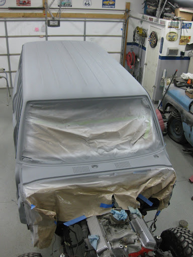

The body in primer; 2 coats:
The roof:
