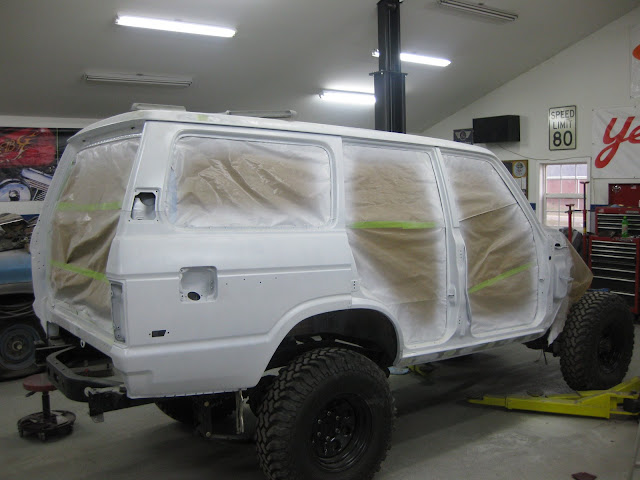

I got the nursery finished, so I have been working on the 60 for the past week. Figured I'd post some update pics; I know it's been a while. I'm still focusing on the body work as of right now. I'm hoping to have it painted before long (maybe within the next couple weeks).

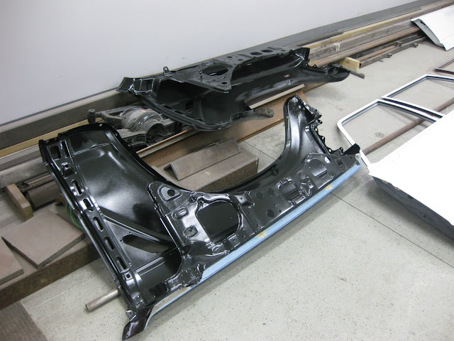

The next step was to finish getting the front clip stripped, the insides of the fenders painted & everything ready for a coat of epoxy and primer. Of course, I also have to get the 1/4's welded in before I can paint. Here are the pics:
Fenders' prime and painted (inside):

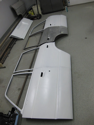

New door stripped & ready for epoxy; all the other doors/tailgate scuffed and ready for coat(s) of primer:

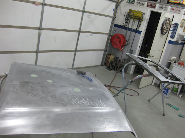

Hood & hatch stripped and ready for epoxy:

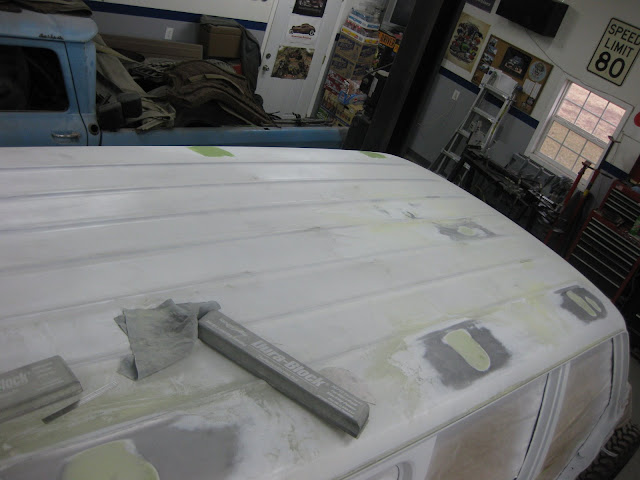

I went back and smoothed out the roof rack holes; I'll spray another coat of epoxy to seal the bare metal:
Quarter panel mocked up; plan is to weld it in tomorrow/Tuesday. I also got the snake blinder holes in the rocker smoothed out:
