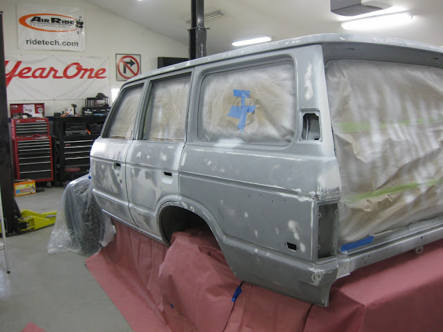

Primer, what primer?

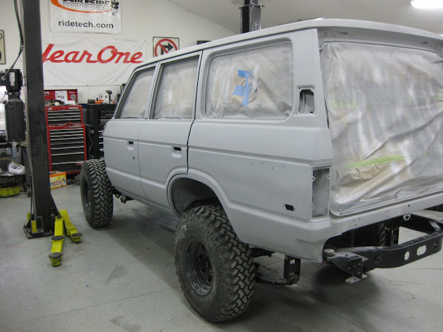

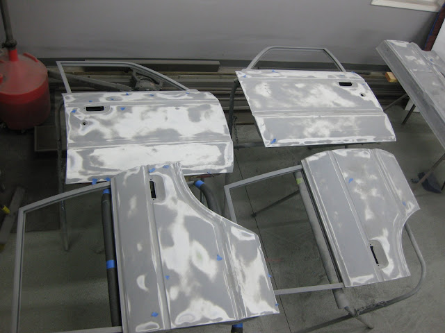

How is it that something that looks and feels so straight in bare steel can be so crooked? Of course, we're talking thousandths of an inch at this point. . . .
I have finished blocking the doors/hatch/tailgate & half of the roof with 180 grit on an 11" block. All of the little blue dots you see indicate areas in need of a skim coat (again, thousandths thick) of metal glaze. I will then spray another 2-3 coats of 2K primer and then block with 400 grit.
Once that's all done it will be a matter of moving her to the paint booth, spraying a sealer coat (reduced epoxy) and then base/clear. It sure is getting closer. :D
Nice... that right rear door looks like its in the best shape!! sigh of relief... Thanks for the updated pictures! Coming along great!
LOL, your door looks phenomenal! Don't know if you recall the photos from earlier, but the other 3 doors were full of dents & dings so it doesn't surprise me that they need more work. I wish all 4 doors could have been as straight as the one you sent.

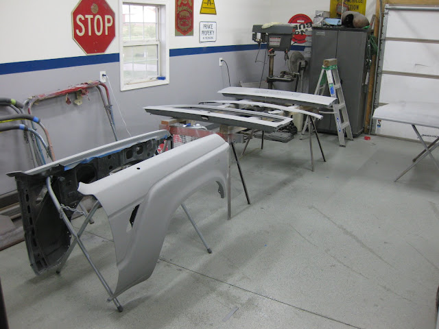

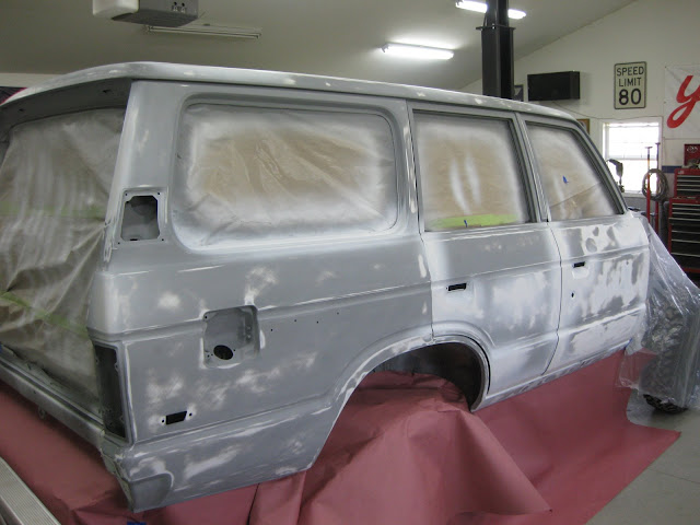

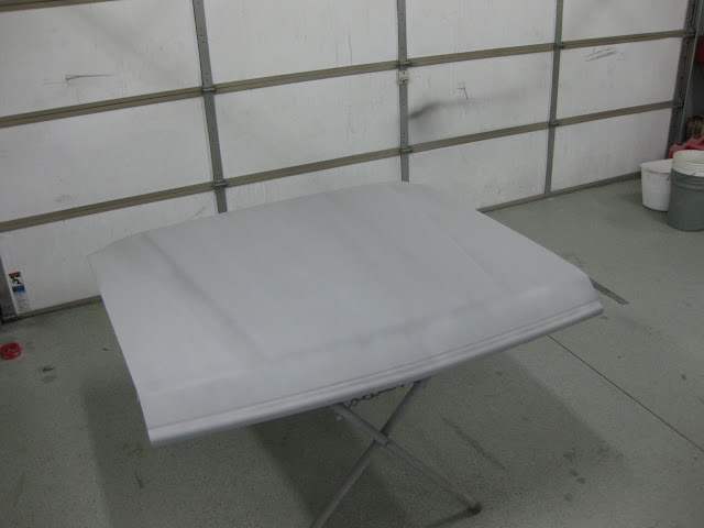

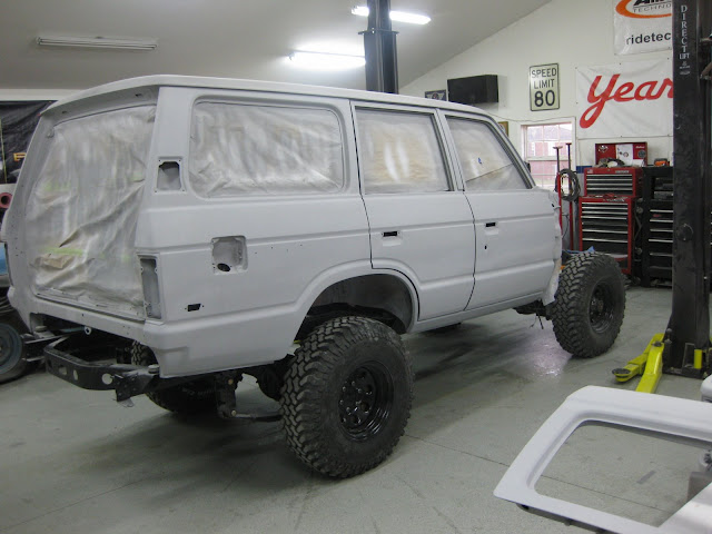

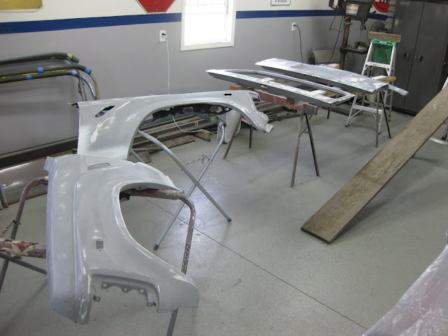

Figured I'd post some updates. I've been blocking my butt off. . .
Finally was ready for another round of primer today. I shot another 3 coats on everything. It's been really windy in Southern Indiana, so I sprayed in the garage (which I hate doing). On the bright side, a good buddy of mine is about 1 week away from having the paint booth in his garage up & running :grinpimp:.
I'll start blocking everything back out with 180 again this week. Assuming all is straight I should be ready for base/clear before too long (keeping my fingers crossed).
On to the pics:
:cheers:

You know, in all my time I have spent on mud, I have never seen anyone say how to remove the fenders. Either it's really simple and needs no explanation or maybe no one does it that often. It's not in the FSM, and I noticed you have pulled your fenders off. So what is all involved in doing so?
Disconnect the fender light harness, a few bolts in the engine bay, the inner fender liner, and that's basically it. Fairly straight forward.
Don't miss the bolt right near the bottom of the a-pillar. You can't get to it unless you open the front door.
