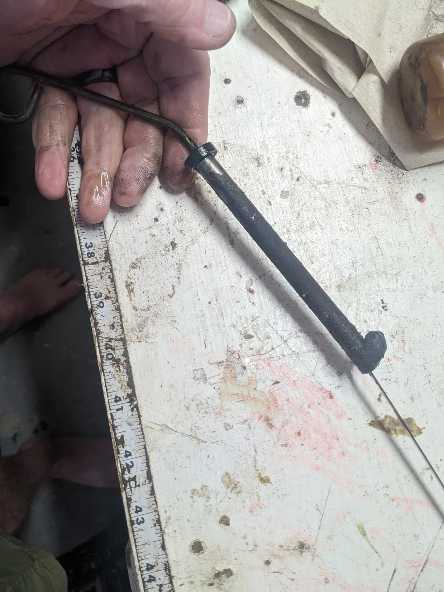

Ok, so I have had the truck for about 5 years and I do remember the dipstick always being loose...the tube you slide it into anyway. Well today I pulled the stick to check my oil level and the tube pulled out with the stick. Not entirely sure what I am looing at and where to start with a fix. It feels like the tube sheered off as it is rough metal where it was connected to the truck. Is that the case? does it actually screw in or what? and what is my fix here? The black wad at the end of the tube feels like melted rubber. Thanks for the help. For now I stuck it back on and just tied the end if the stick to a hose to hold it into place.

It appears the blob at the bottom of the tube was an attempt to glue it back to the block?

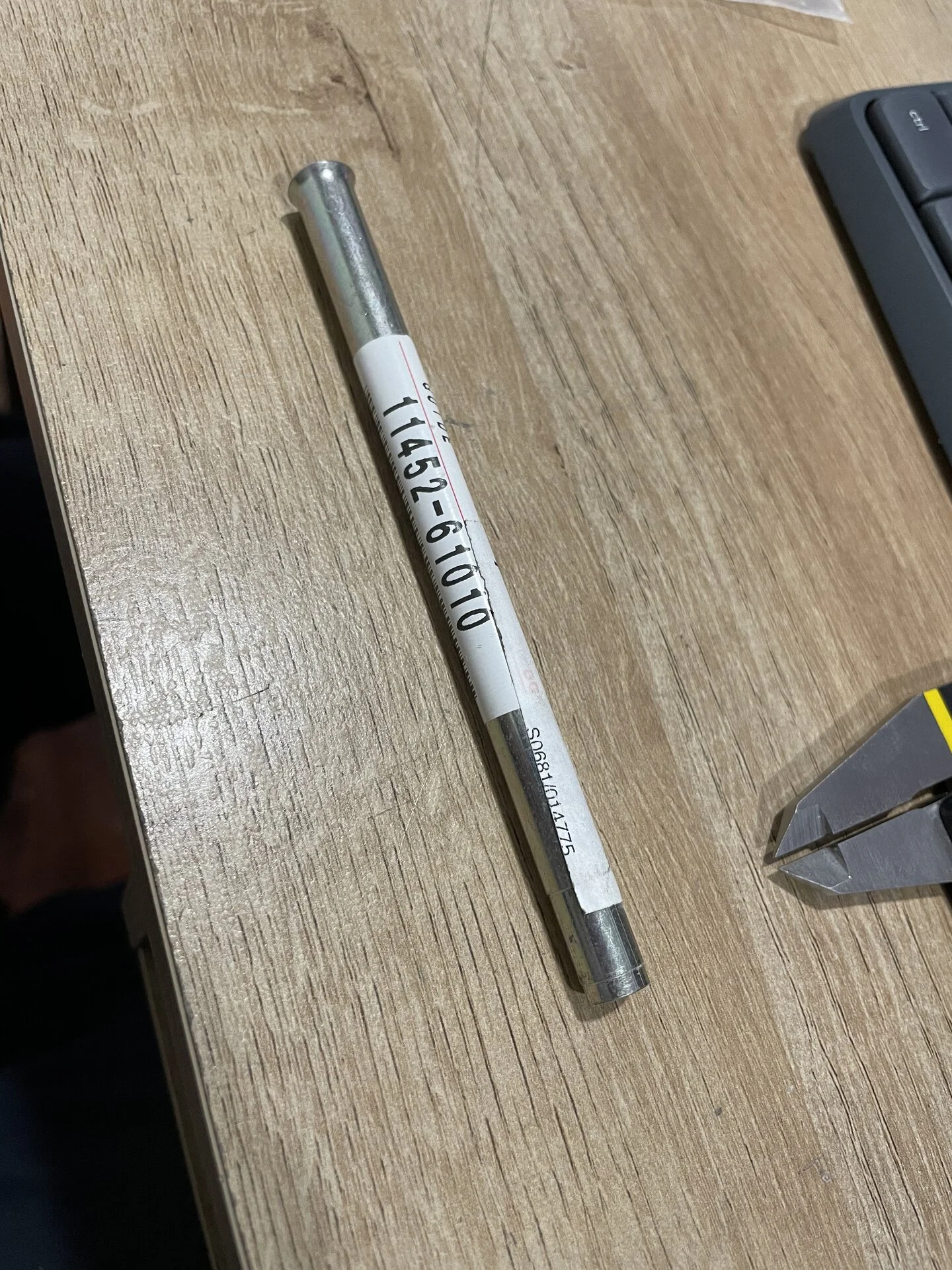

Upto 1983 the 2F part number for the dip stick guide is 15301-60013. This is the part that is posted above that shows a bracket in the schematic. I believe this part is NLA. It is substituted with the guide from 1984 and up 2F engines which has part number 11452-61010. This is the part that is still available and it does not have a bracket. The change of the part number (and perhaps design) of the dip tube guide somewhat correlates with the phase out of the FJ40 (which also used the 2F engine).

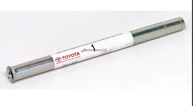

there is no bracket AFAIK. The part number is 11452-61010. If you google this, you will find pictures like the one below from CruiserParts LLC.
thanks...that looks like what I pulled out. Wonder why I get a different part number and pic from where I was looking at toyotapartsdeal.com Looking again and they actually shows both the one you posted and one with what looks like a bracket listed for my truck. Anyone get a chance to take a look at their truck and tell me what you have that would be great. Wish me luck getting the broken piece out.

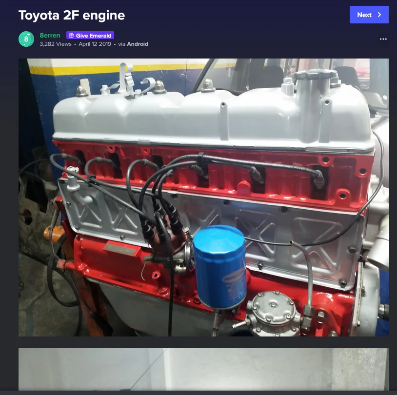

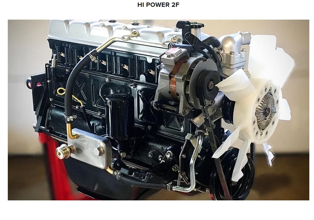

I found this nice picture of a Mosely Hi-Po 2F engine that shows the straight dip tube guide.

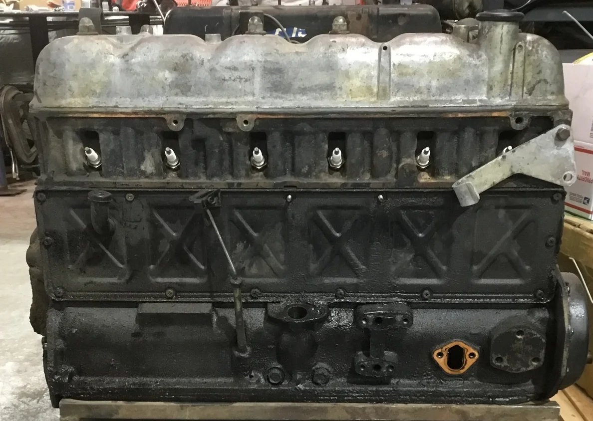

I also found this picture of an engine that shows where the guide fits into the block.
