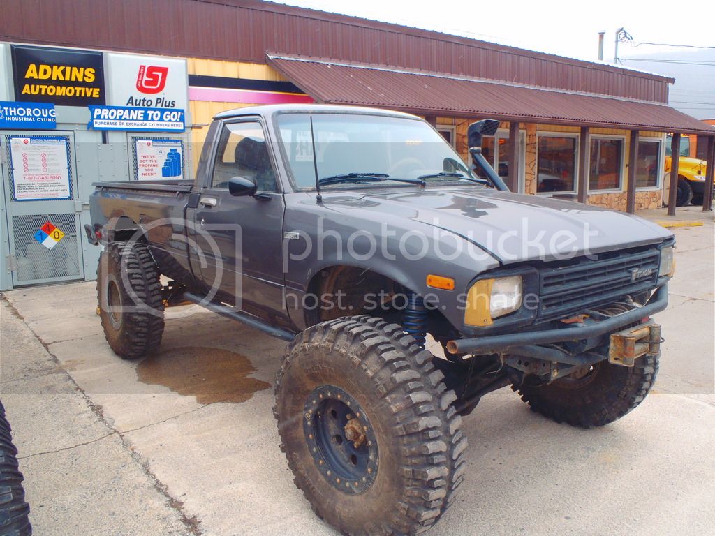

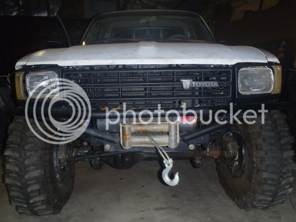

81 Toyota Diesel 2wd becoming 4x4 with landcruiser axles and dual t-case

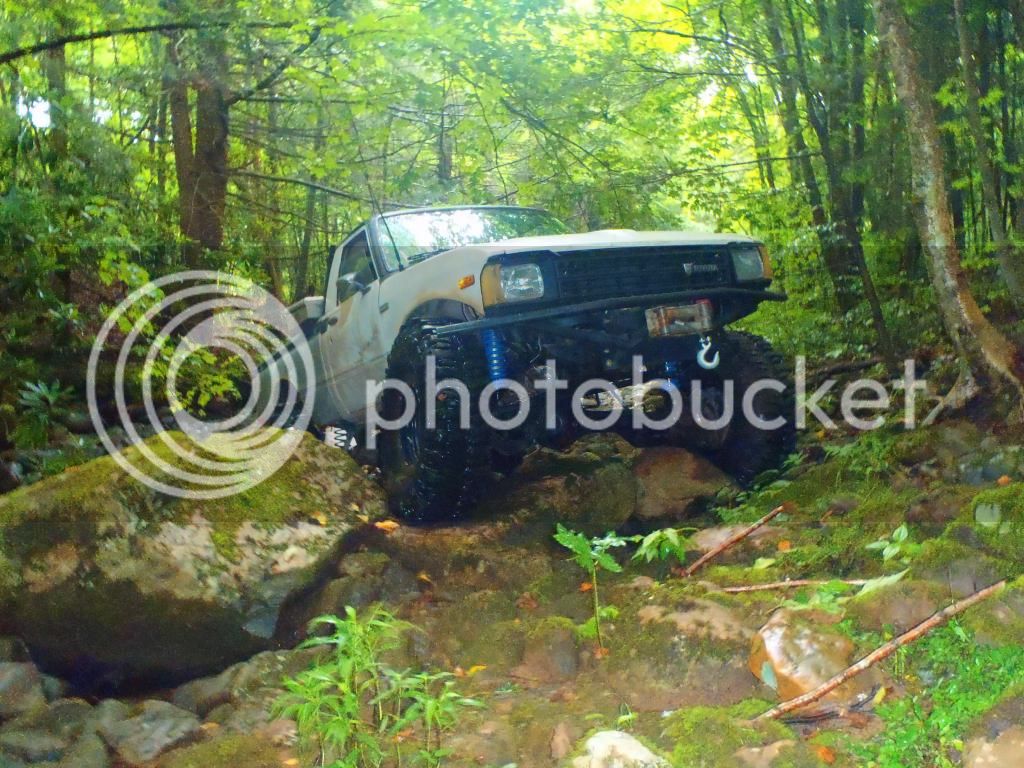

Tinkered with it last night and was able to determine the alt. is charging.Turns out the positive cable from the battery to the alt is highly deteriorated.I ran a heavy gauge jumper and the lights went out.After starting it a few times everything seems to be working properly.But I will be happy to keep the alt. stocked in the shop till I may need it!

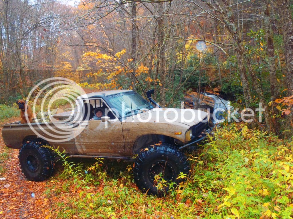

Got the truck out this weekend.It preformed flawlessly.I didn't do anything wild.Crawled along for 4hrs with perma grin.LOL
happy you got it out! looks great! sounds awesome!

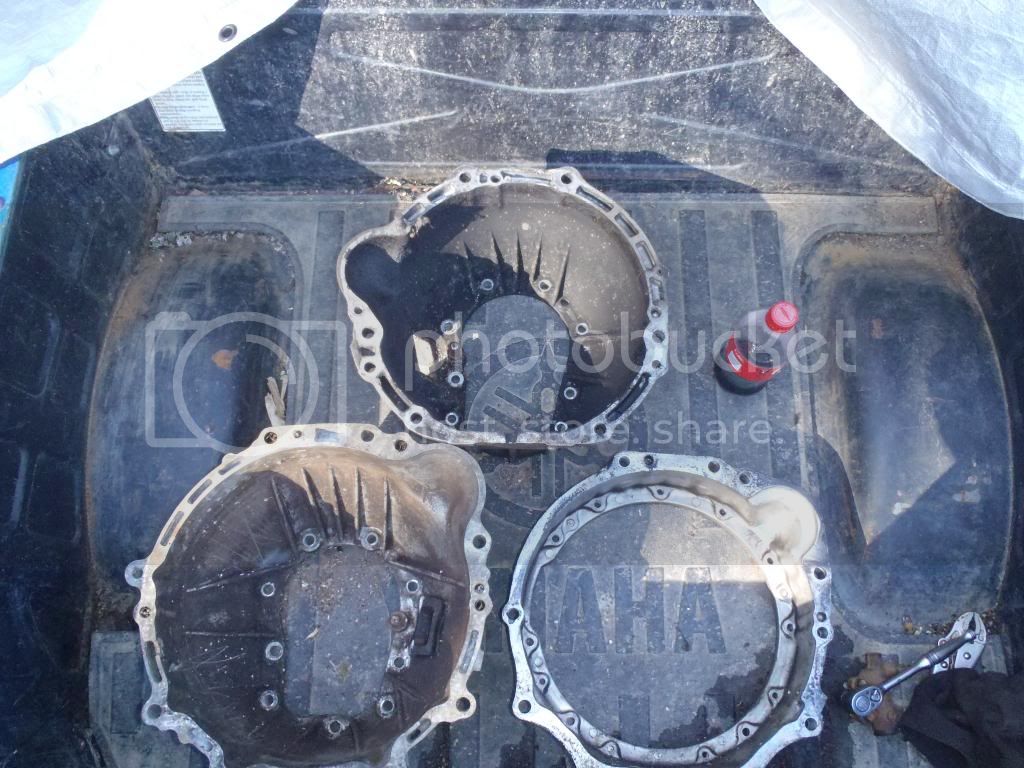

Does that motor bolt directly to the four wheel drive trans or do you need an adapter or different bell housing.
You must have a different bell housing.It is specific to the diesel engine.Starter is on the opposite side compared to the gasser
Top is a gasser,bottom left is a 4x4 diesel,bottom right is a 2wd diesel
