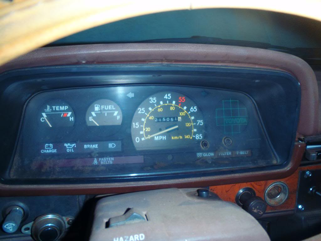

this is my dash

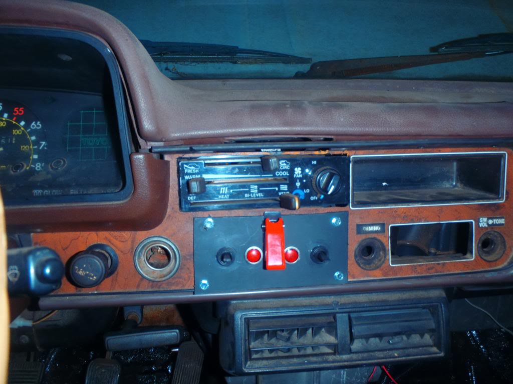

the heater control.And the elocker setup.Complete with safety switch,engaged lights and safety relays
nice dash cluster !!! more info please ...........
I'm not the guy to ask.lol Its just a cluster to me,pretty self explanatory.The grid to the right in the dash does nothing from what I can tell.Never noticed it till this pic really.Guess the flash made it easy to see
All this talk of the dash cluster has jinxed something.lol.I not for sure but I believe my alternator has quit charging.After starting my charge,brake,filter and tbelt light all stay lit.The oil and glow plug lights go off like normal.Any one else had a similar issue?
