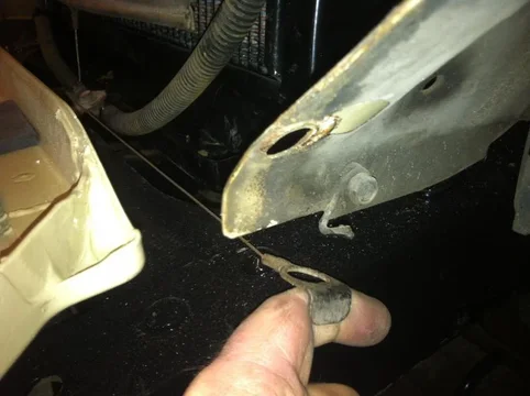

The wire runs through another bracket on the front frame cross member. And there is a hook on the fender to hold the shade down.
Thanks for showing all of this. What is the material used to block the radiator made out of?
Its canvas with a rubberish coating on one side

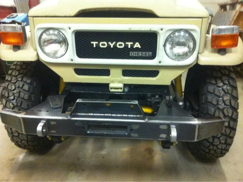

Bumper weld tonight and send to powder tomorrow or Friday.

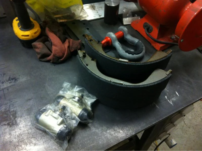

Transfer case re-build this weekend and brakes too if time permits.

Locker install, possibly at the same time as the brakes but I have to get the locker out of Coastal Kevin's 40 first.

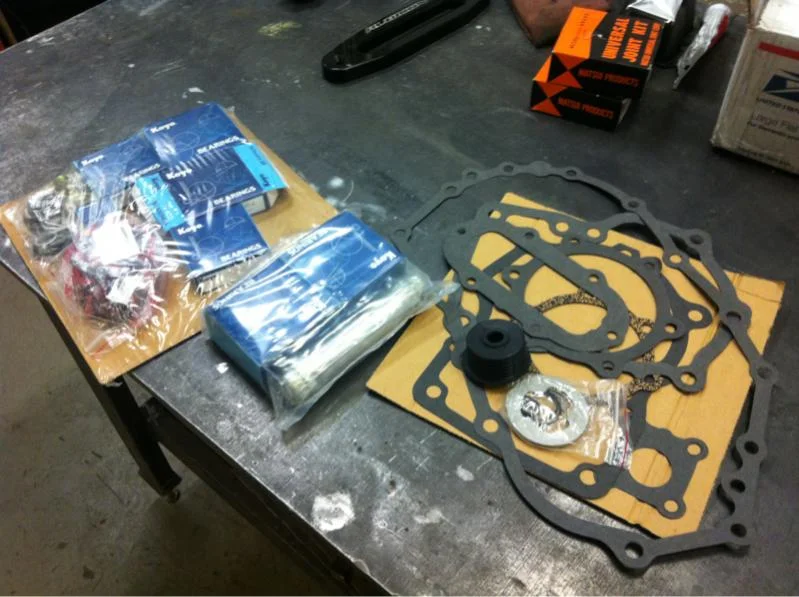

I didnt know you had to rebuild the t-case as well.
Its not a must do. It is leaking from all the gaskets and I want to seal it up. If I'm gonna tear it down I may as well put in new bearings too. It has some play on the rear output so it needs a shim in there. New bearings should tighten it all up. I have not noticed any issues and don't anticipate any gear damage.

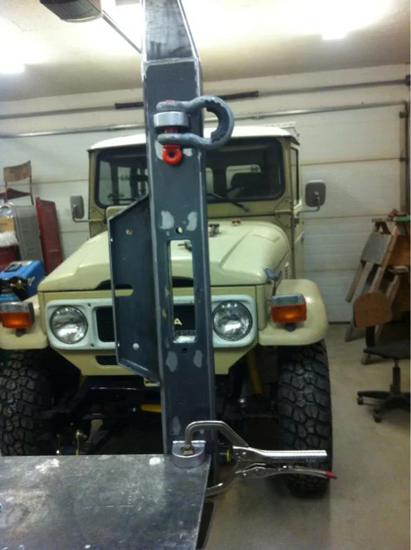

They are handy when working on the bench and flipping a part around. I can't seem to get them as tight as the regular vise grips and the big one I have needs lube or something cuz it doesnt like adjusting from thin to thick without a whack.
Bumper welded and ready for powder. Almost. Welding it caused a slight bow out in the middle so I will attempt to straighten it at the shop monday. It sticks out 2" more than most because I didn't want to remove the factory frame horns for the factory bumper. Eventually this unit might get the factory bumper re-installed.

That looks even better on the truck than just drawings. Is that an aftermarket gasket set for a transfer case? Be real meticulous using it. I've had some leaks out of my set that looked just like that.
