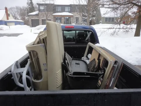

Got all the sheetmetal off to paint today. :eek: Holy $$$! I'm feeling the pinch on this one, but I'm hopefull that having a nice 42 to drive in this summer will help cure that.
