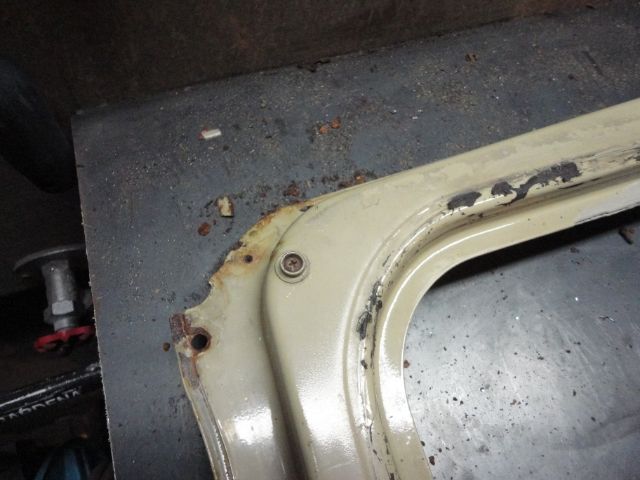

A lot of time spent on this:
And now the bib. you can see the previous fix.
Welding/brazing?
Soooooo..... what I really need now is the dimensions of the lower bib flange. Volunteers?
Bib rot cut out
Fitting the new piece I had had made
Had to grind the welds where the inner support would conflict. you can also see the tabs that I have replaced since not much steel was left there.
Fitting the inner support. I re-used the curved ends but had to blast them,
Ready for mock up tomorow
