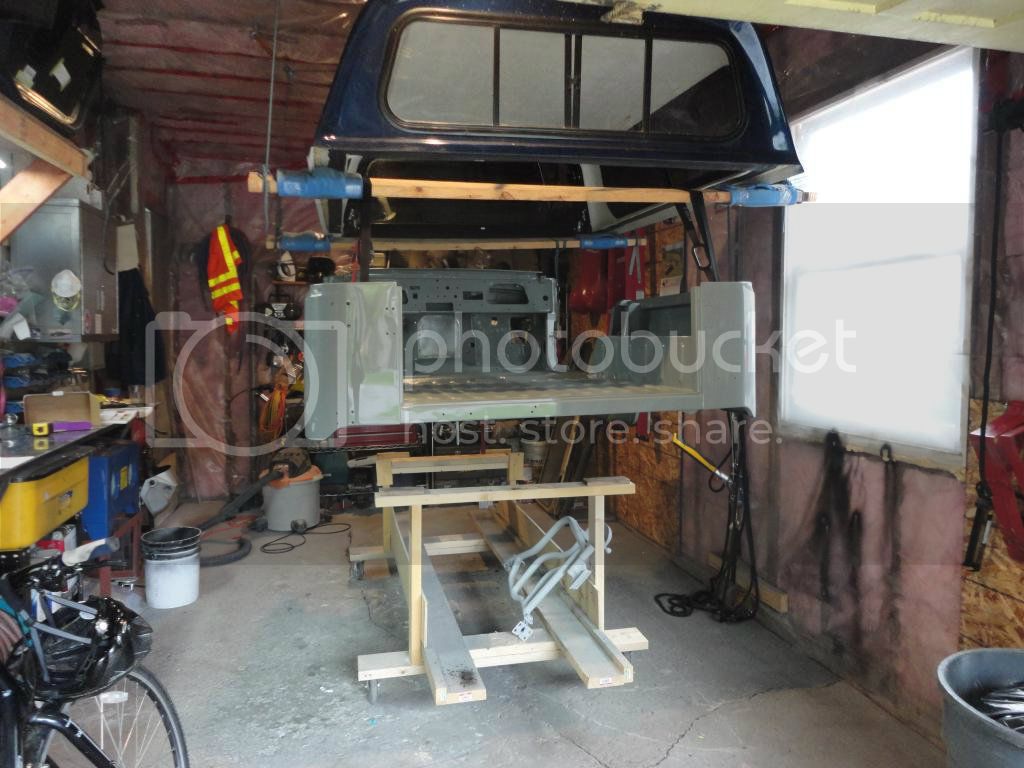

Hey buddy!!! The tub is looking good. I like your 3 finger seam sealer. I was hoping to see some paint

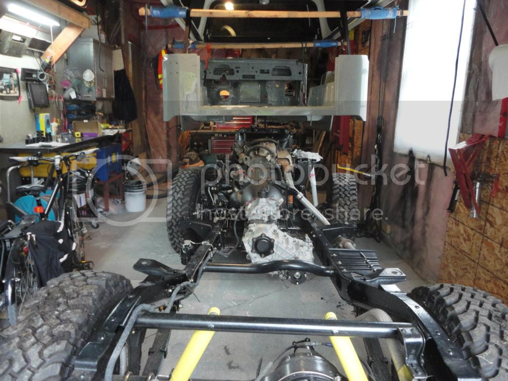

It is starting to look like a Land Cruiser again.

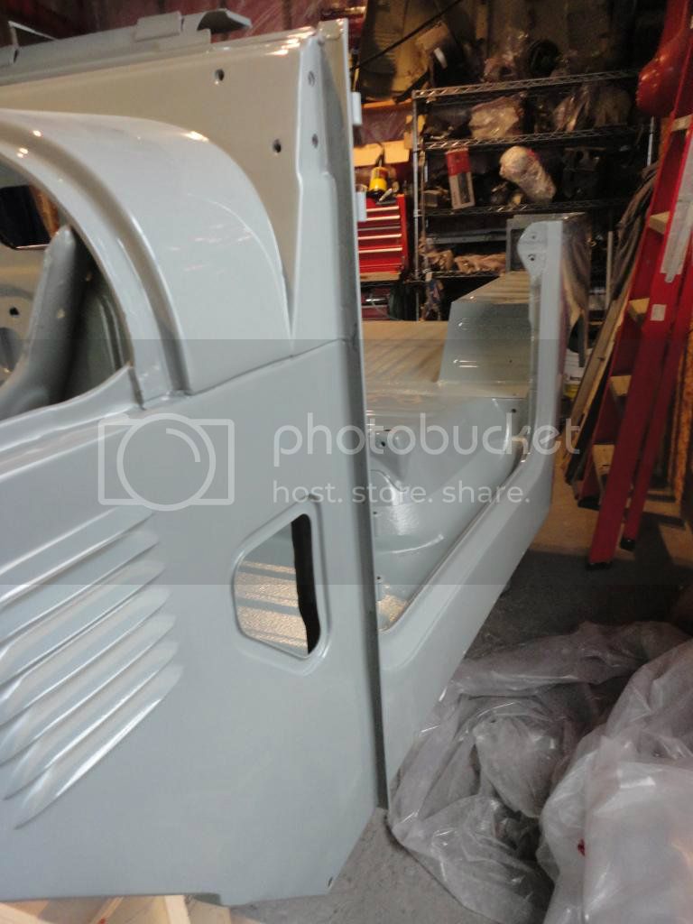

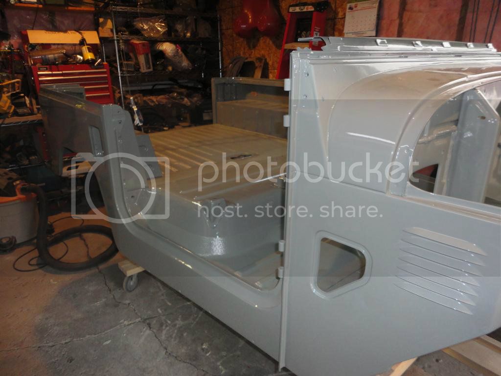

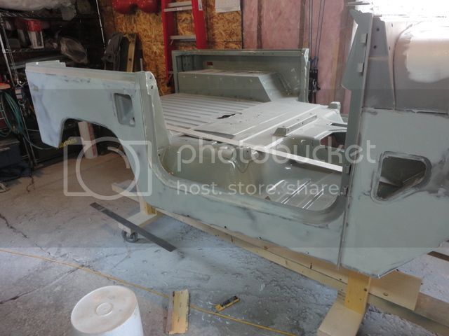

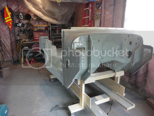

The onslaught of summer has taken it's toll on cruiser time. BUT progress is beign made! I wasn't going to put any bondo inside the tub, then the perfection gug got me. I filled a few nicks and grinder marks where I would see them most. Then, noob mistake, I primered the fixes without masking off the rest. Now I know better.

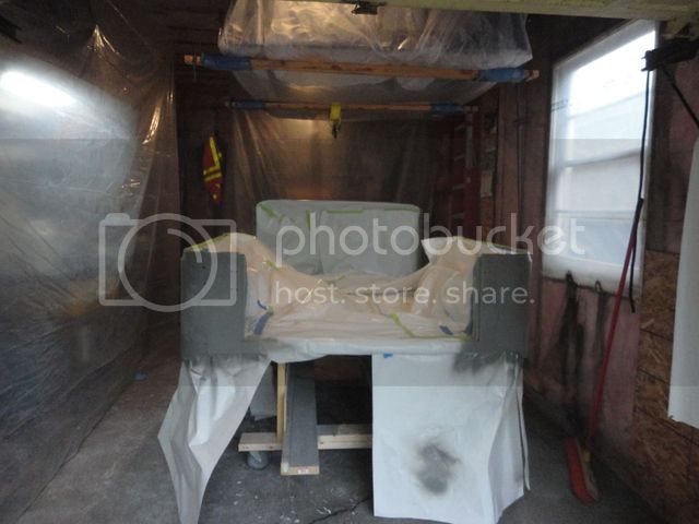

So after much sanding, I got another 2 coats of colour in the tub. I'm pretty happy with it, but the dust specs are a let down. I'm thinking of having the outside paint done in a booth, we'll see.
The color is Heath Gray, from the LC colour chart, 1974.

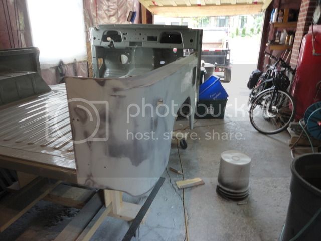

I know now why people pay to have body work done. Combine that with a general lack of motivation and things are moving slow.
Also, had to fix the dump trailer due to hauling bricks..... not easy on the floor!
Patched up

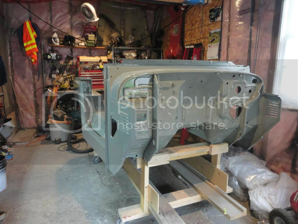

Putty, sand sand sand putty sand sand sand putty sand sand sand and so on.
And finally 3 coats of primer filler. I've now sanded the outside with 400 grit, 600 tomorow. After all this work I think I will have it painted for the final coats. It would be a shame to have a paint job full of dust!

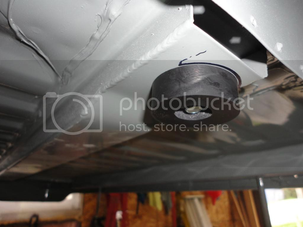

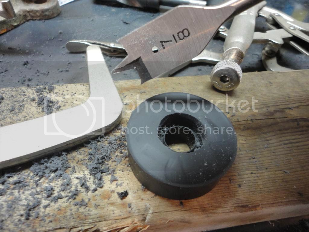

So I've tried to find a writeup on this to no avail. this is what I did:
Place the tub on the frame, and see where it lines up. Mine were not centered.

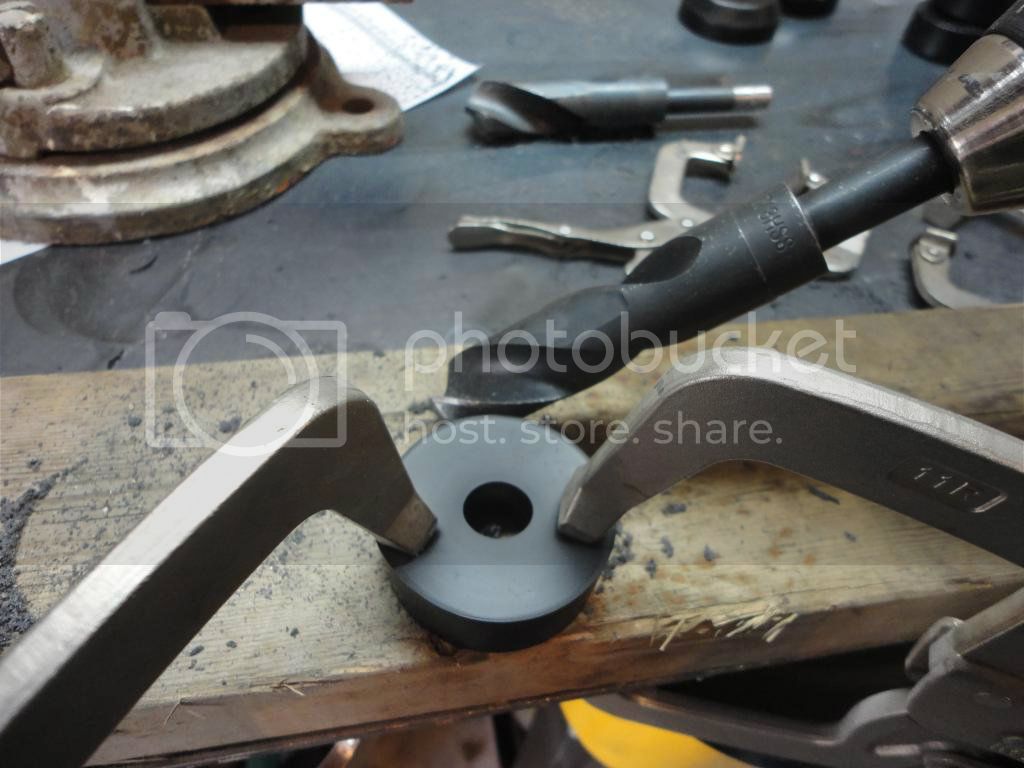

These are from the Daystar kit. Drill with 7/8 bit just deep enough so when you use a spade bit, it wont wander.
I drilled deep enough to hide the head of the self tapping screw (#14 x 1") once it would be in place.
and voila:
