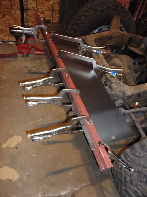

While I was waiting for bolt, decided to go ahead and figure out the rockers.
Rocker mockup
I needed a bender, so a couple pieces of angle iron and some imagination
http://i141.photobucket.com/albums/r59/ihatepickingausername/DSC00761.jpg
The final product

"I needed a bender, so a couple pieces of angle iron and some imagination"
What kind of "imagination" did you use? Looks to clean to be a hammer-
Looking great- keep it up!
