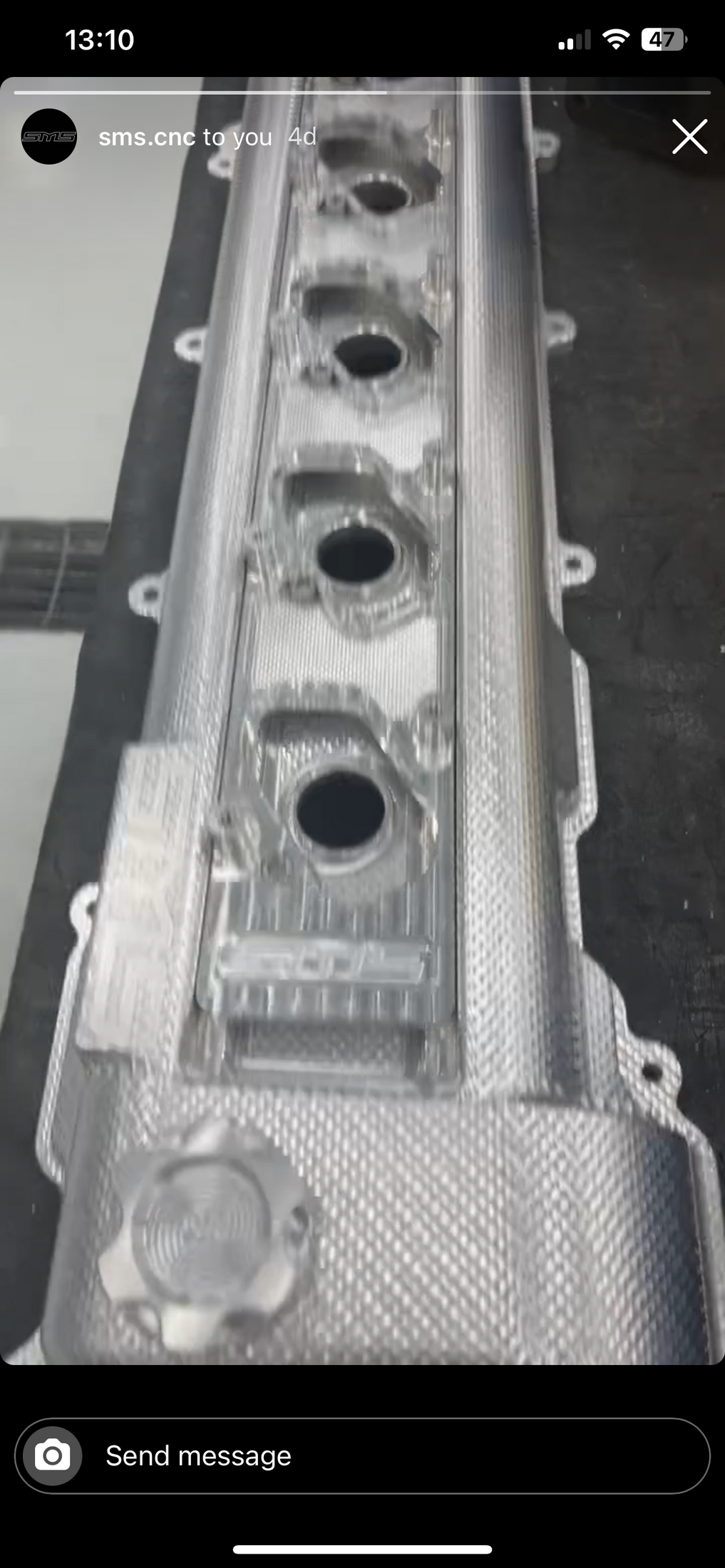

Yeah this will likely be my last Land Cruiser build so I kind of want to put everything into it, so I am not wishing I would have after it is done.
Yeah I don't necessarily love all the texture but to smooth everything out evidently would have required a lot more machine work. I think it will look cool once it is coated.
That texture is very intentional they added the crissy crossy stuff after the whole thing was surfaced. It took a lot of extra programming and machine time to add that.

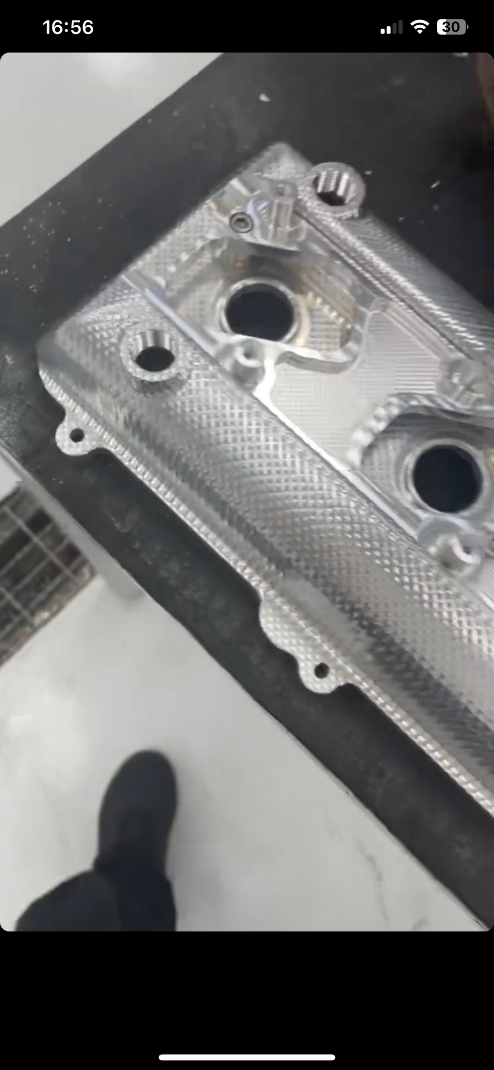

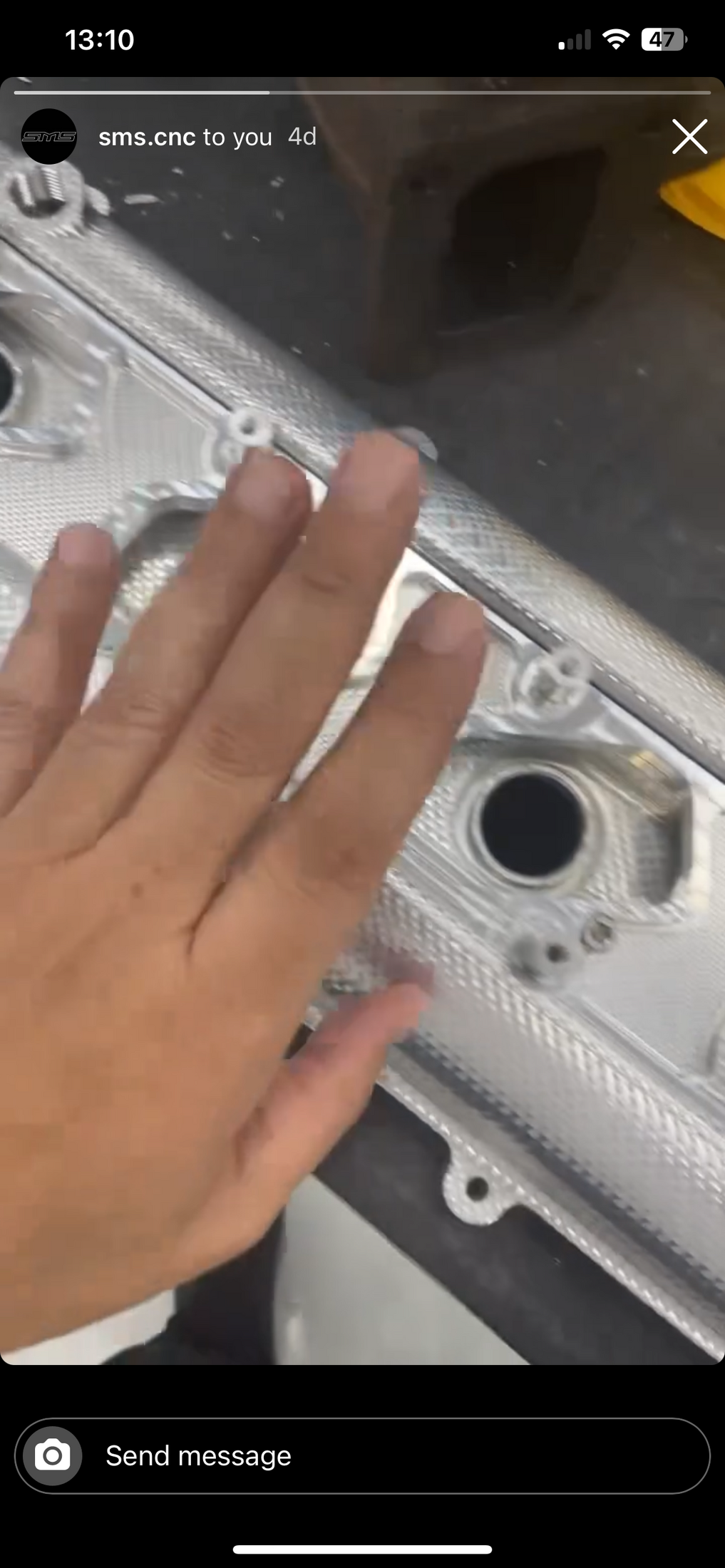

Actually yes, he just sent me a video on Instagram Saturday that shows it is done and completed with the GTR coil plate that I requested. But I will believe it when I have it in my hands. lol.
It looks killer at least! Where are the breather and pcv ports on this design?
AN bungs machined into the back of the valve cover with baffles on the inside.
Sorry these are just bad blurry photos from the video he sent me. Once I have it in hand I will show more of the detail if you’re interested.

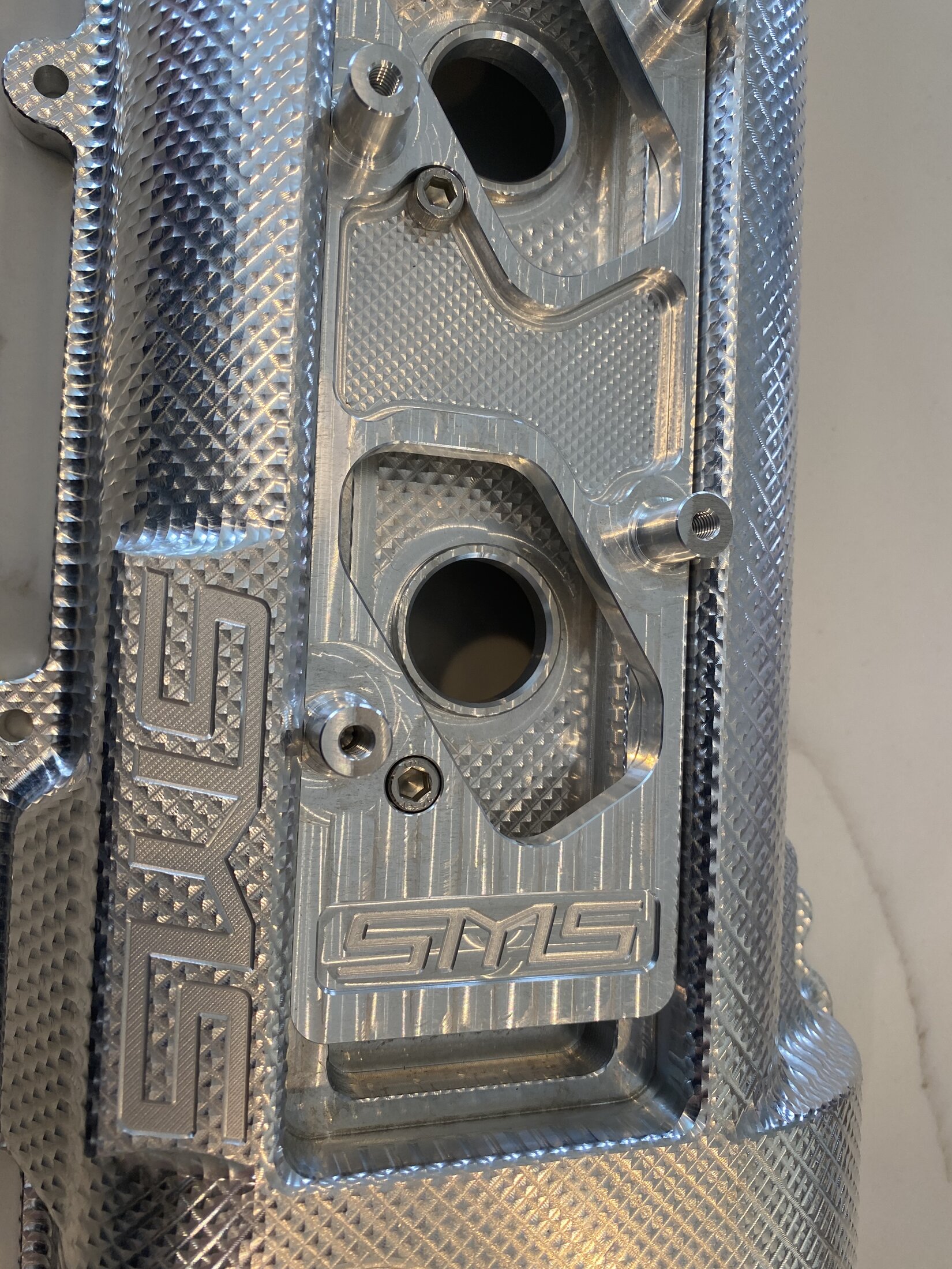

Well it actually arrived! About 6 months wait after sending a money order I thought for sure that money was gone. Haha.
But pictures don’t do this thing justice. It is definitely a big chunk of aluminum, there are no weight savings here! Lol. And yes I know there is zero performance gain from a billet valve cover but I just think it’s cool. Lol
If anyone wants any specific photos or anything let me know.
CNC billet cap and the threads are incredibly smooth.
Valve cover is cut with a o-ring groove for the oil fill cap
CNC adapter plate for Nissan GTR ignition coils. You could have this plate adapt to any other ignition coils.
Nicely machined for the spark plug oil gaskets
AN ports for blowby.
