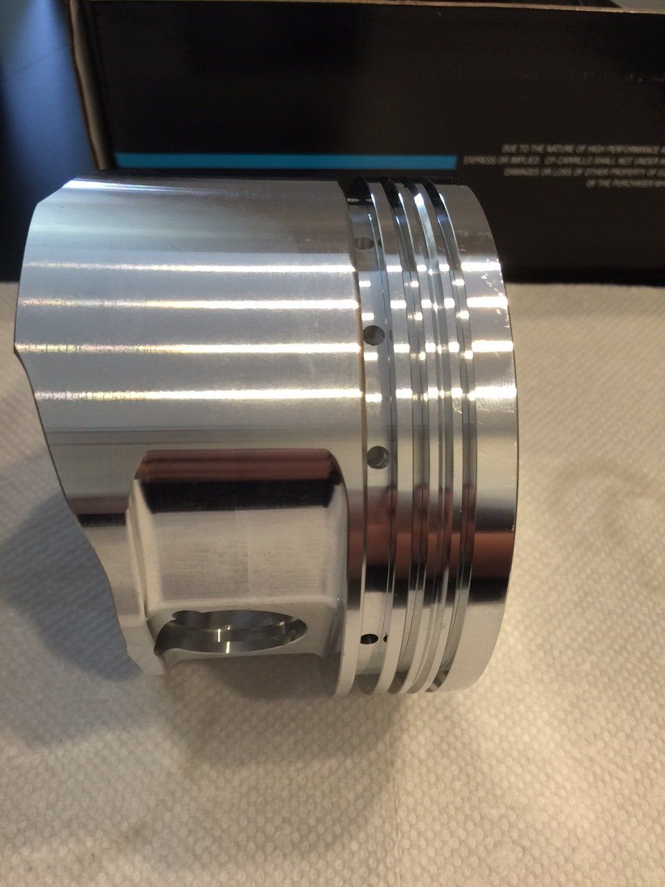

Huge thanks to Nero at Titan Motorsports for basically "sponsoring" me. He gave me $600 off Carillo rods and CP pistons just because he wants to see where this project goes. That savings allowed me to go from the Super-A rods to the Super-H rods. Super-A's are rated from Carillo for 150-200hp per cylinder while the Super-H's are rated at 275hp per cylinder so I should be able to go as crazy as I want with this motor.
Nero is also thinking about starting up his 1FZFE performance engine program again so we might see some things of use in the future from them.
Super-A's on top Super-H's on bottom

I have Titan working with CP to see if they can get a forged piston blank the size I need for around 9.5:1-10:1 with a 101mm bore and a 95mm stroke.
This should give me about a 4.6L engine.
