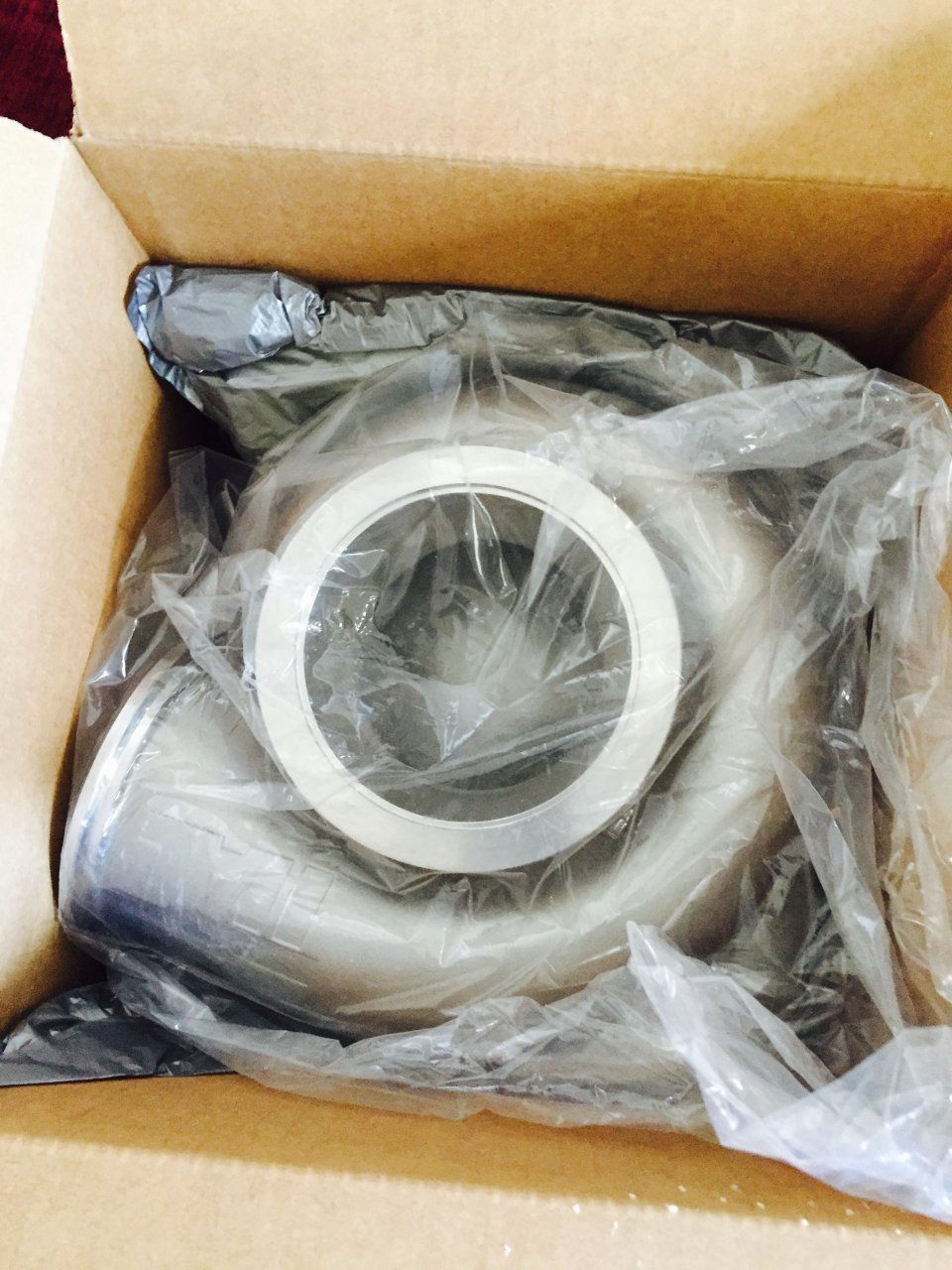

Yes that is exactly right. You will have a new exhaust manifold flange, on that exhaust flange you will have mandrel bent schedule 10 stainless steel welding els, that will bend and snake their way to this turbo merge collector, the turbo will use a V-band flange to connect to the collector, then the gasses spin the turbine wheel and exit out the back of the housing to the downpipe.
If we go back a few pages you can see the stainless steel turbo housing. The opening on the left is what will sit on this flange, and the large opening will be what the downpipe bolts to also with a v-band flange.

The closer you can get the turbo to the engine the less the exhaust gasses have had a chance to cool. The more volume the exhaust gasses take up the quicker you can spool the turbo. SO we will try and tuck the turbo up fairly tight. It will occupy the space where the current exhaust manifold sits and extend out toward where the current air filter housing is, The air filter housing will not be reused.
