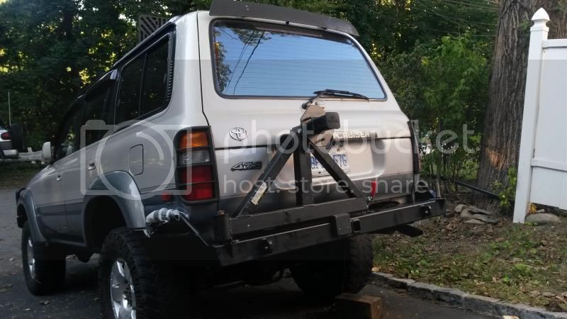

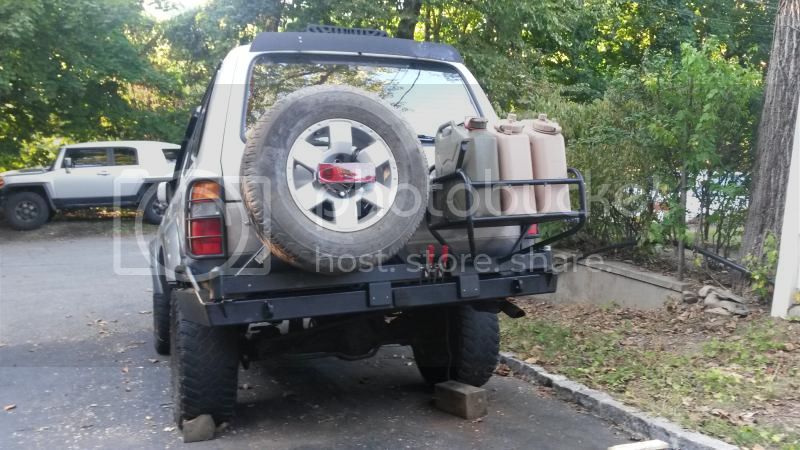

I finally had the free time to installed my bumper I bought from you.
GREAT BUILD QUALITY. (now I will be waiting on a 100 series bumper).
My daily configuration set up (of course with a spare in the holder).
2" hitch warning brake light in the extra 2" hitch receiver on the spare tire carrier.
(I actually wanted this option for a hitch bike carrier, to make it easier to get into the trunk)
