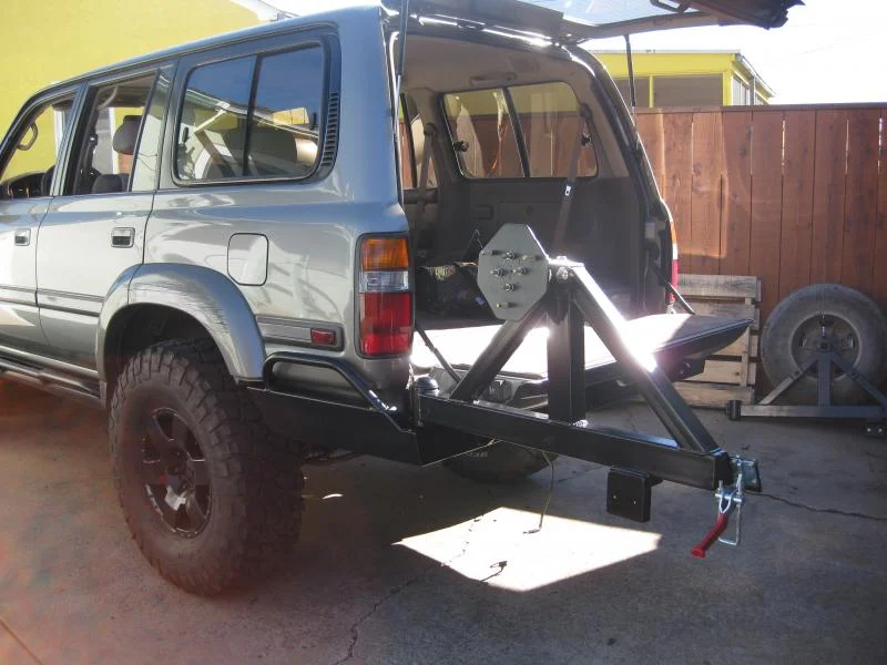

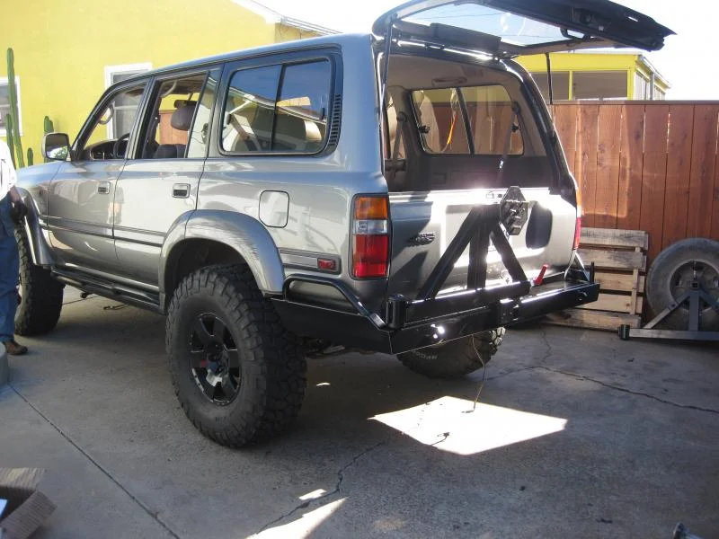

main beam is made from 3/16" rectangular steel, everything else at least .120 wall. 3/4" thick clevis mounts that pass through bumper and are welded to the frame brackets, side protection brackets bolt up to existing captured nuts on frame, and those brackets are made of 5/16 and 3/8 steel. i use 4x4 labs spindle setup for the tire swingout, a 1k spindle for an optional 2nd swinout 3 jerry can rack. destaco 2k over the center compression latch incombination with a 1/2 drop pin keeps it shut tight. has high lift and antenna mount. tire mount flange telescopes in and out for differant size rims and offsets. 2" reciever. full bolt on except for the rear crossmember which has to be cut out and removed.
