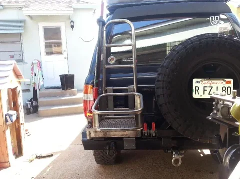

As far as the expanded metal bottom of the basket goes I did switch to a heavier gauge after the first few I built did seem to flex a little when loaded up. and they still do flex some even with the heavier gauge steel. this is just the nature of expanded metal. I have not yet saw or heard of any actually breaking a weld or failing somehow, and although I feel it is unlikely, I can not say it is out of the realm of possibility. If one does break I surely will work to fix it. I guess I could of avoided all this by making the basket solely for jerry cans, but i wanted to make it more versatile for coolers or tools or whatever else you wanted to throw in it.
I am working on a 1 and 2 jerry can holder that hooks on and off the ladder with a high lift jack mount next to the ladder, I will post some pics when I figure it out.

here it is bruno, we will see how it fits on the truck monday. And I couldnt help but add some more steel to the three can basket, Thanks Eric!!

The issue I was having was not so much the weight of the cans, but when you put a ratcheting tie strap on them it really put some down force on the bottom of the basket.

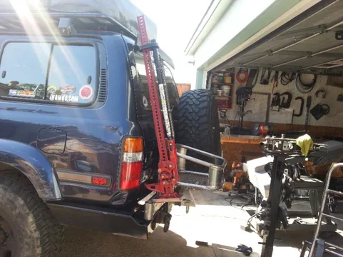

Is that a 48" or 60" hi-lift? How far above the roof line does it go?
EDIT: had to go out and measure. From that point on the bumper to the roof line is about 45" vertically.
this is what I did yesterday. the longer jacks fit better when on the outside going up and across. It is now also 10lbs lighter than the old style and seems to be just as rigid. the upper jack mount is removable and slides in and out to get the jack to lean against the different size tires the same too. 37" tire is about the max it holds without the tire getting into the taillight and coming too close to the 3 can basket.

I have the 60" hi lift, good to know it will fit.
