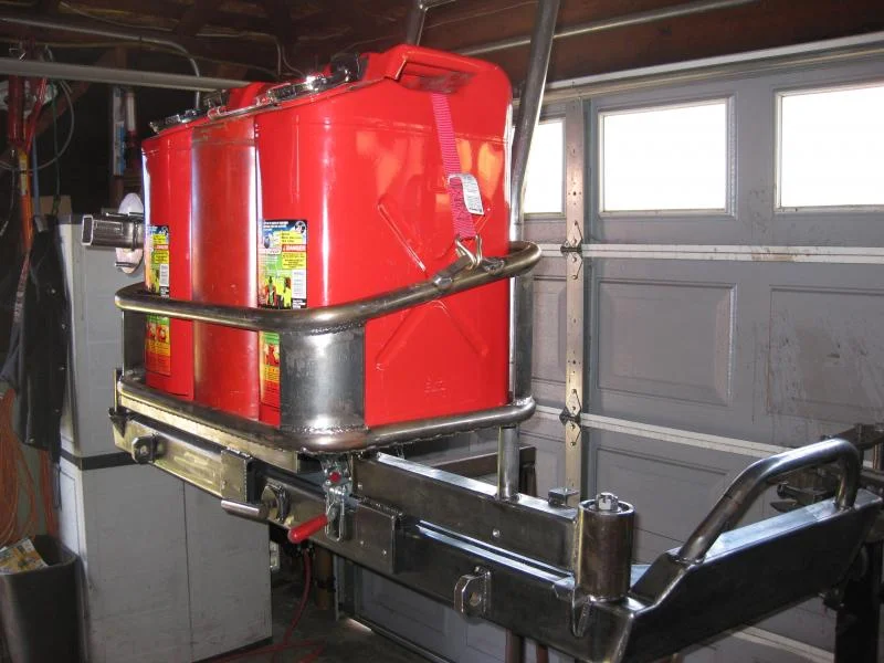

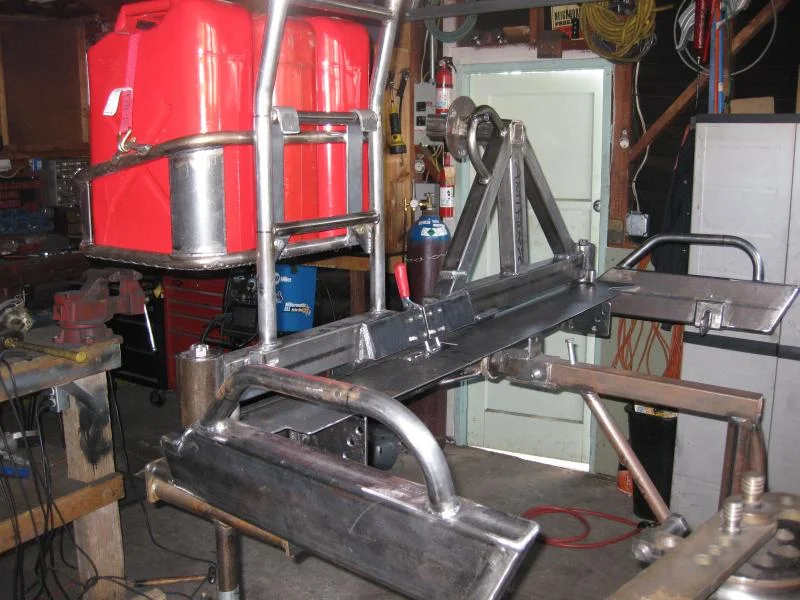

The basket evolved a little bit more. I am using flat steel plate that is bent to match the radius on the corners, instead of all the tubing pieces and endless notching I was doing before.

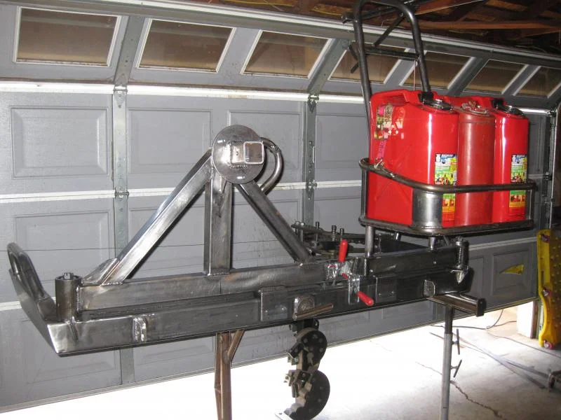

This one is yours Brett, it is at powdercoating and will be ready to ship by the end of next week. Now it is time to start on yours Chris!
Wait time is down to about one month right now.
one more pic of your bumper Brett, I added a gusset to the tire swingout, I don't know if it adds to the strength much, but i like the way it looks.

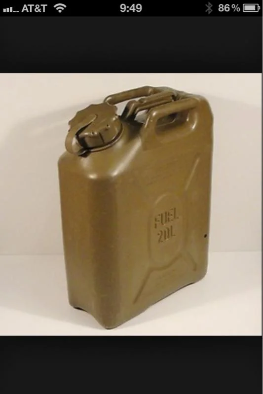

That can should measure about 14x 7, the basket will hold three of them ( inside diameter of the basket is 14.25" x 21.25")
and your lucky you don't live in Ca, because if you have anything other than a CA approved can in CA, yes the one that leaks and spills, and is hard to operate, and the spout breaks very easily, and cost close to $70, you are at risk of receiving a hefty fine.

I can confirm that the jerry can carrier will hold three of the scepter cans, unless Sean has changed the dimensions of the carrier.
Only issue I have is the expanded metal base for the jerry can carrier, seems like the welds would fatigue over time and break off. Maybe not..

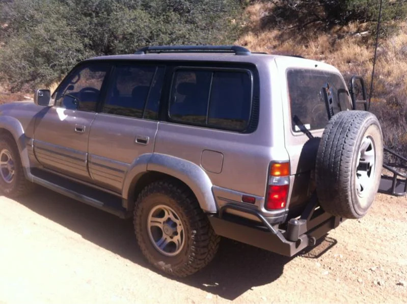

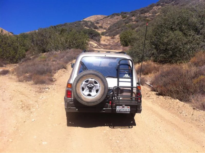

Here are some pics from my phone. Sean is a great guy to deal with, and obviously very talented. In my opinion, this is the best bang for your buck bumper that money can buy.
