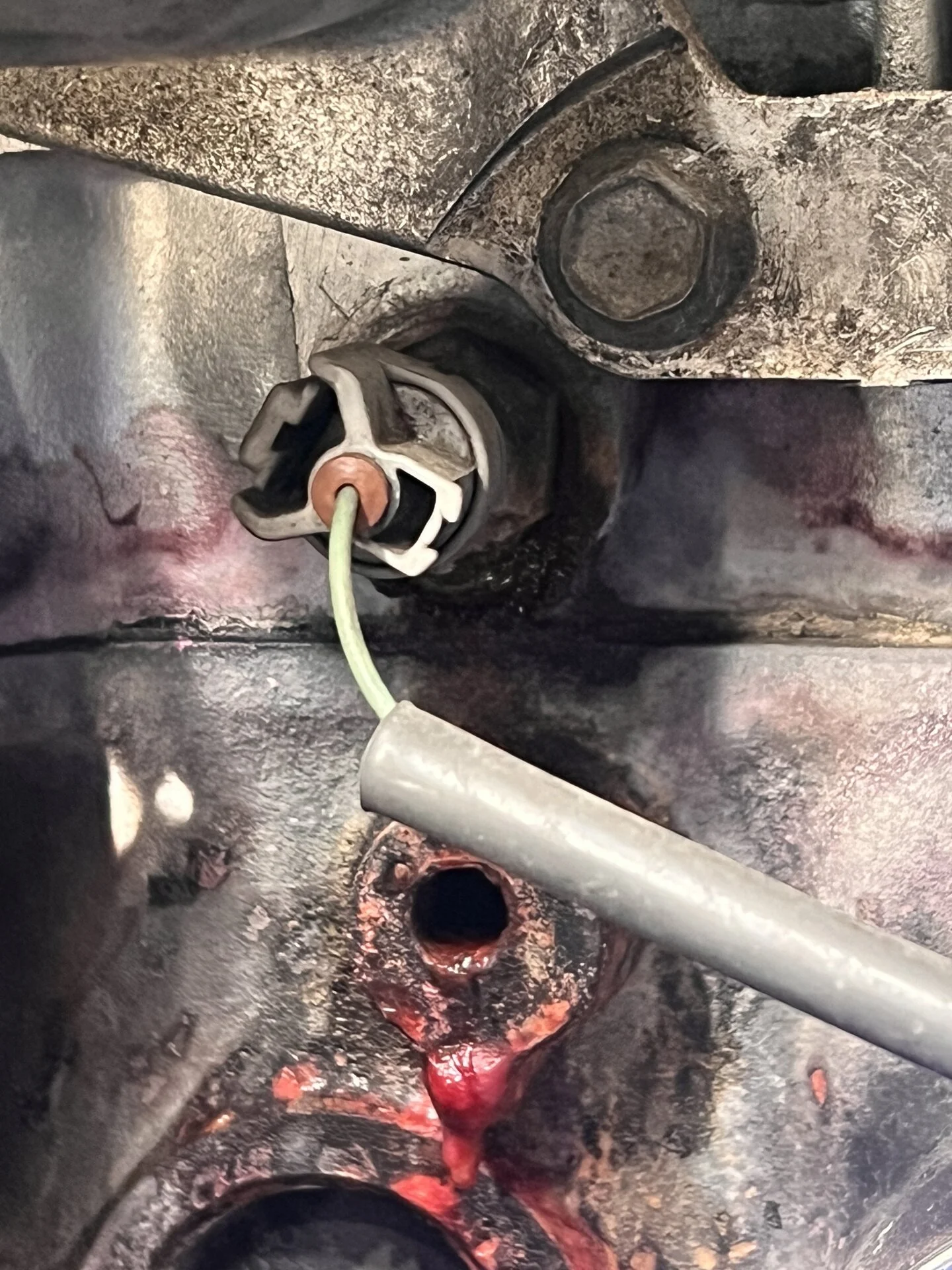

Then I started looking at sensors. One of the sensors looks like it was recently broke off in a little bit of coolant is coming out from where it sits. Not in the top line of sensors, underneath the first sensor and to the top left of the oil filter.

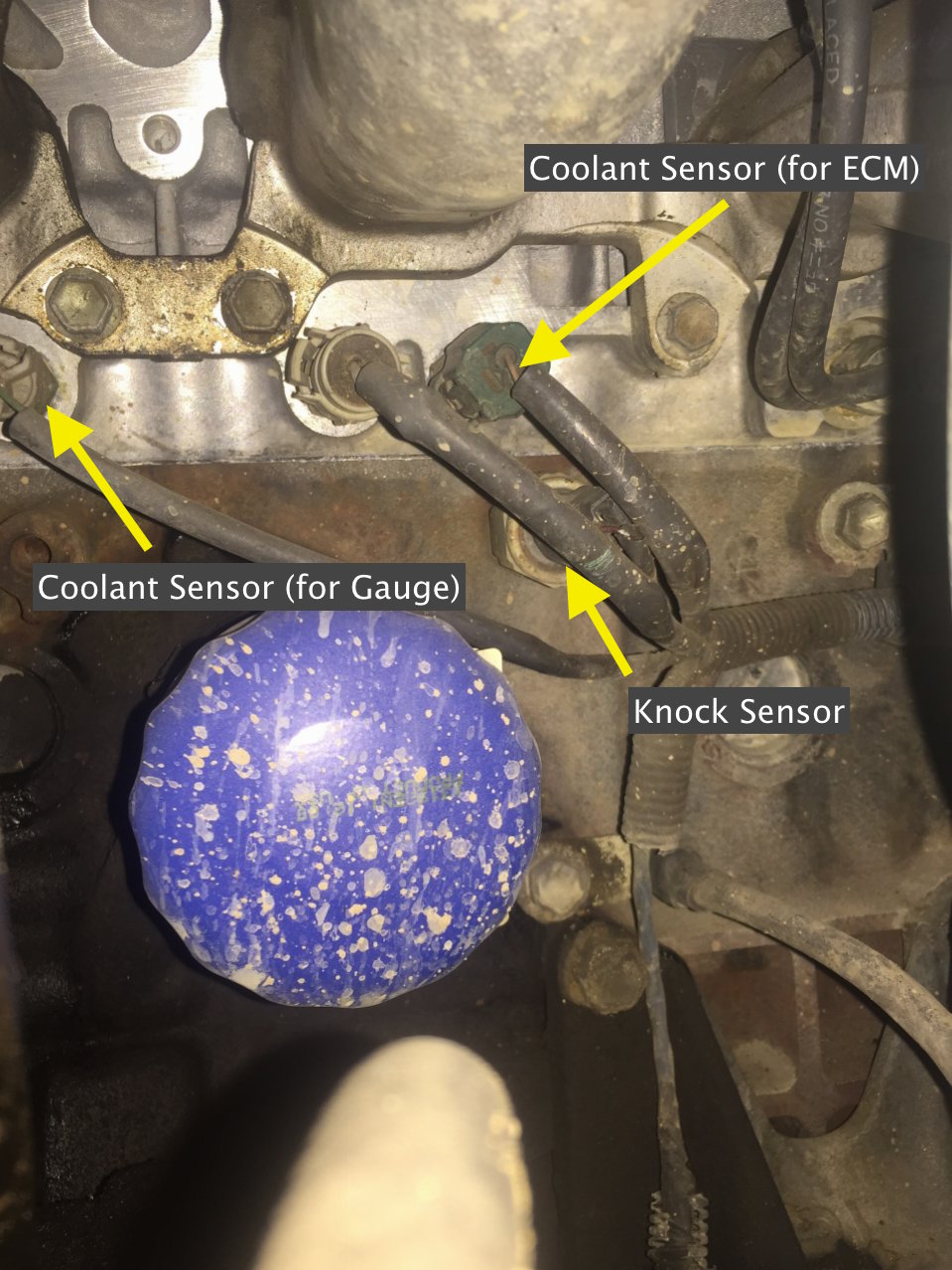

See sensor from another thread.
So the coolant sensor looks like it is leaking onto the piece below. If I'm getting temperature readings on the ultragauge then is it just likely that the sensor needs to be tightened, or some FIPG put on it? Any chance this is the culprit of the stumbling?
There are two temp sensors.
One is for the computer and one is for the gauge.
If the one to the computer is broken, it will give the computer bad readings and it will not operate correctly because it will think it's still in open loop or other things.
There are two knock sensors. If one is inop, then it cannot measure correctly to the other and will give erroneous readings. Timing will not be adjusted properly by the ECU.

Both of the sensor wires for the coolant sensors are intact. One of the cooling sensors was replaced by Toyota a year or so ago. There is coolant leaking from the forward most coolant sensor. The one that goes to the gauge.
I see both knock sensors. The rear is hard to see, but I was able to. The wires are connected. Is there an easy way to determine which knock sensor is bad?
