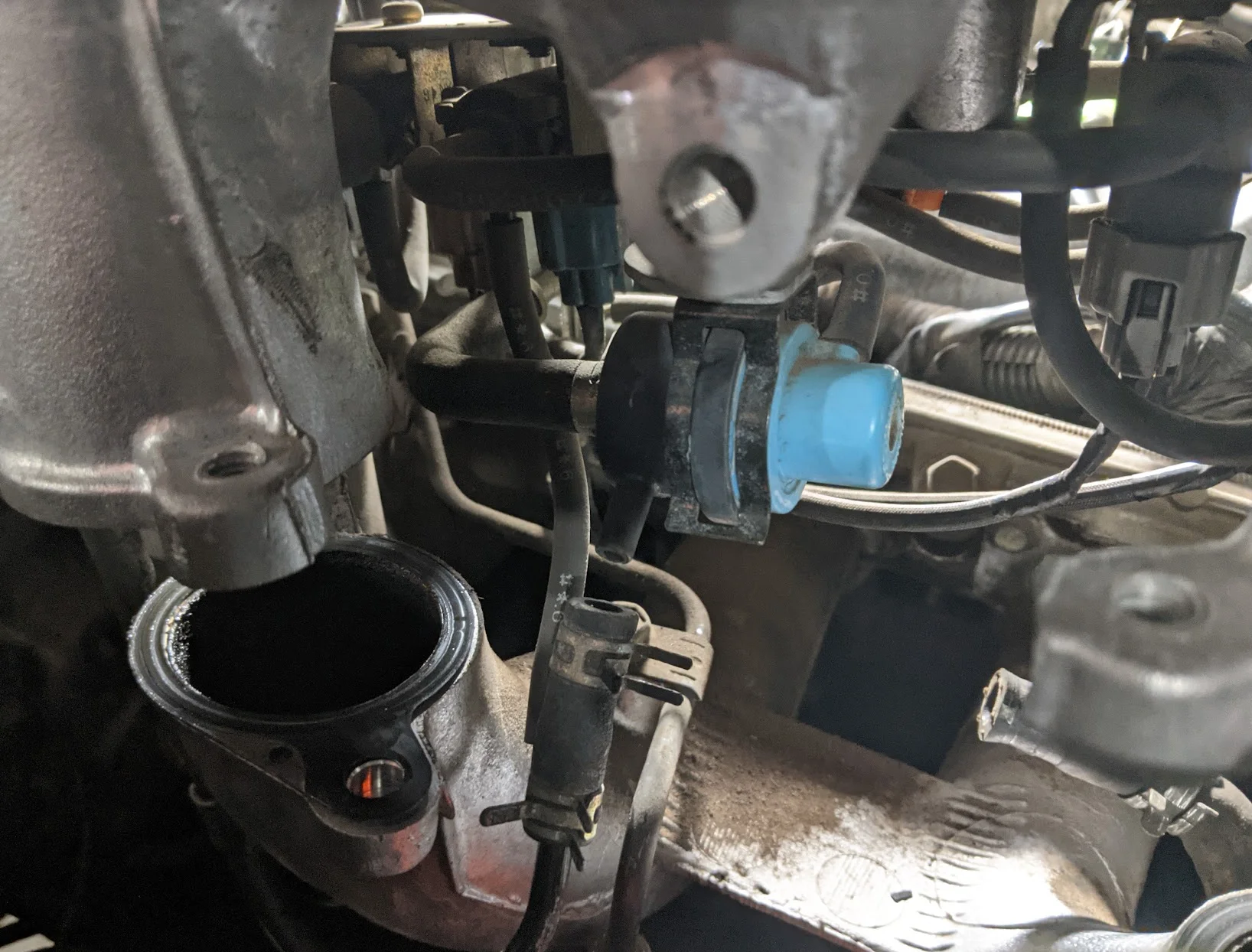

I have a 93' 1FZFE Cruiser that I am replacing lines to the charcoal canister due to gasoline fumes in the cabin. I already swapped my canister recently for a VC120 which fixed pressurization issues, but the fuel smell in the cabin is bad.

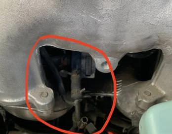

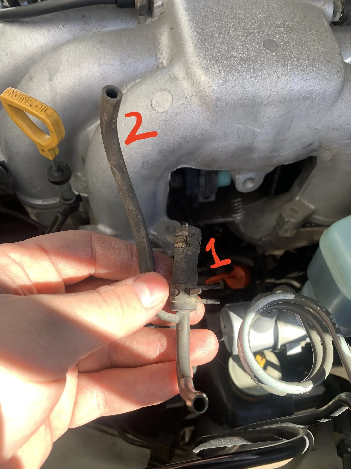

I changed the line to the tank with no issues, but when removing the purge line I removed more hoses than intended. I am unsure where one of the hoses is suppose to connect to. I marked this as "2" in the pictures, and showed where "1" connects. I was thinking maybe the downward facing blue piece may be the connection point for the "2" hose ?
Its going to be difficult to get in there with such little room. TIA for any help on where the connection point is or how to access it any better.
I was able to slip the hose on that blue piece, but would still like to have some confirmation that its the correct spot.
I also replaced hose #1 due to its cracking and having that size handy. I used the same hose #2 as pictured since it was in good shape.
Here's what it looks like on my 94 (before I replaced all of the vacuum lines with new):
Based on that it looks like you have it correct.
